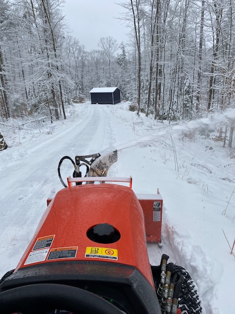

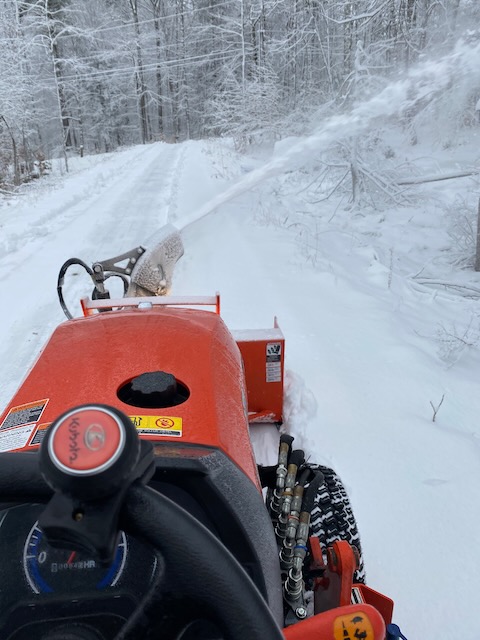

B2601 here as well. I elected to go a little more conservative with my blower size at the 48" commercial blower as I am blowing uphill 50% of the time on my 650' gravel driveway in NH. When I was buying my tractor a couple years back I did a bunch of research and landed on the turf tires......I anticipated needing chains so I have spacers as well. That being said, I do not have chains, I rarely if ever break traction BUT I have loaded rear tires and I typically have my back blade behind me.
I clearly have enough traction with the turfs alone as I will blow uphill while also pulling the back blade uphill in Low 4WD........easy peasy.....
Hopefully the pic below gives a little perspective that my hill is no joke......no issues in 3 winters with this setup....
EDIT: Had another few inches of wet snow that came in overnight and pulled the blade in the aggressive direction while blowing uphill it never even thought of slipping......filled tires....weight on the back.....turfs....seem the prefect prescription for traction here.....love this setup.
