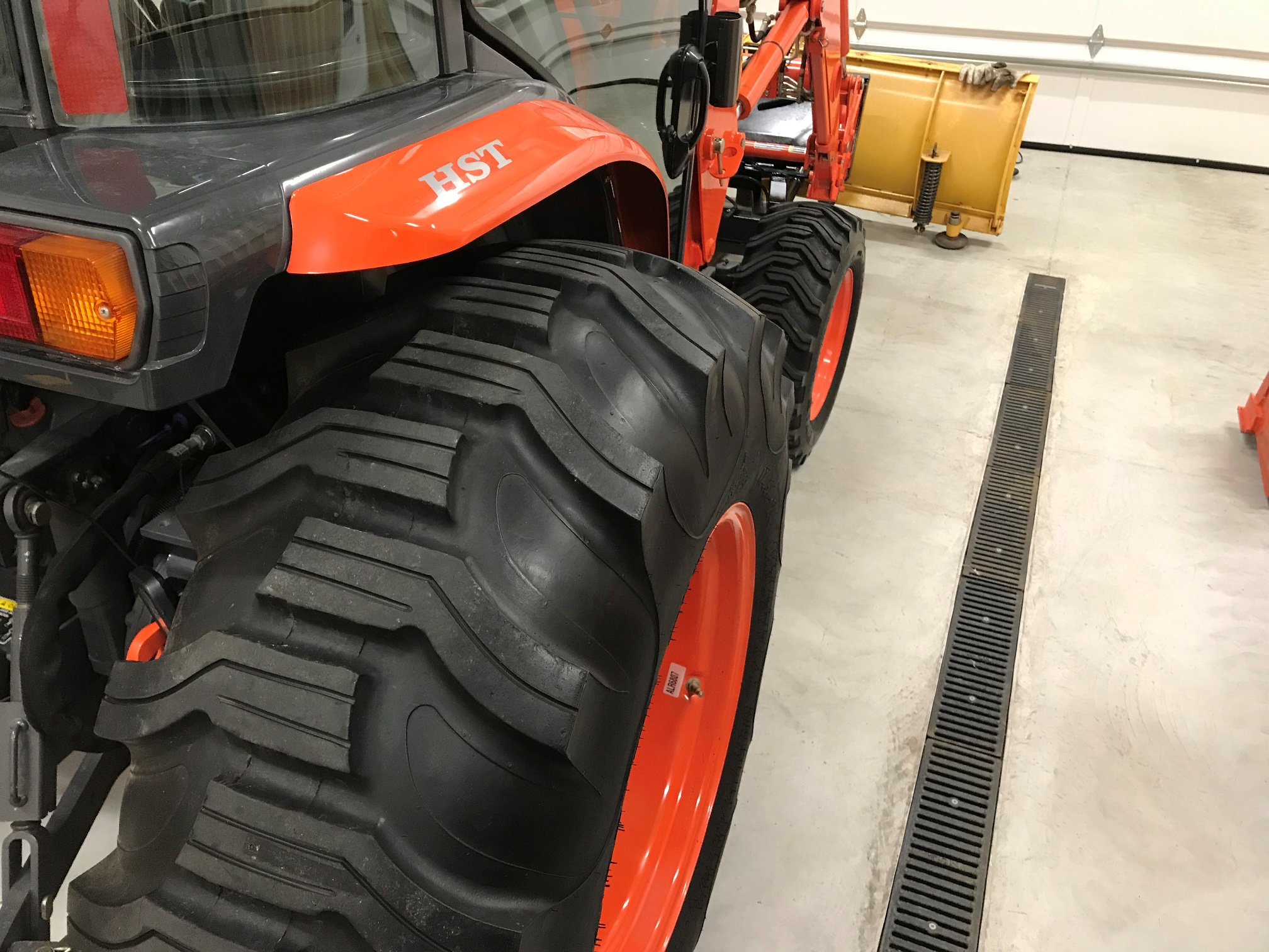

Well the R4s on mine, wet grass yeah not very good at all, the book calls for 40 PSI, stupid if you as me. Snow Ice same same, and mud well you got it of course Im on a hill top so everything is up or down. Lil Bro has a groover back when they raced dirt, so that is next onthe list, and if that dont help, chains, unless I find a set of R14s and I hear they aint all they are cracked up to be either, or turfs at a really good price

Using
Impressive! Or should i say....
A few questions, if I may:
  1. What were the temps on that day?
  2. What did it cost to have the grooving done, or did you DIY?
  3. How do the tires perform in summer conditions on pavement, dirt, and mud?
1. The date stamp on pic and weather records indicate it was 16*F, 75% RH and no wind with light snow / ice fog.
2. I borrowed a groover from a friend at work. No cost.
3. I can't say there is any noticeable difference other than in Winter.
