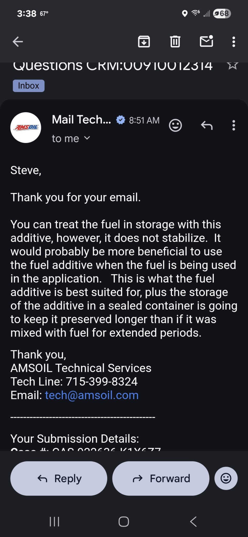

I'm considering using 4in1 Amsoil Diesel treatment in my L2501.
Located in S/C Wisconsin, so I thought with a of little use of the trackor this would be a all around thing to use.
My concern is the 5 gallon can of fuel that will be in the shed for more fuel if needed.
Treat that or treat it as I put it in the trackor?
This is Amsoil reply
