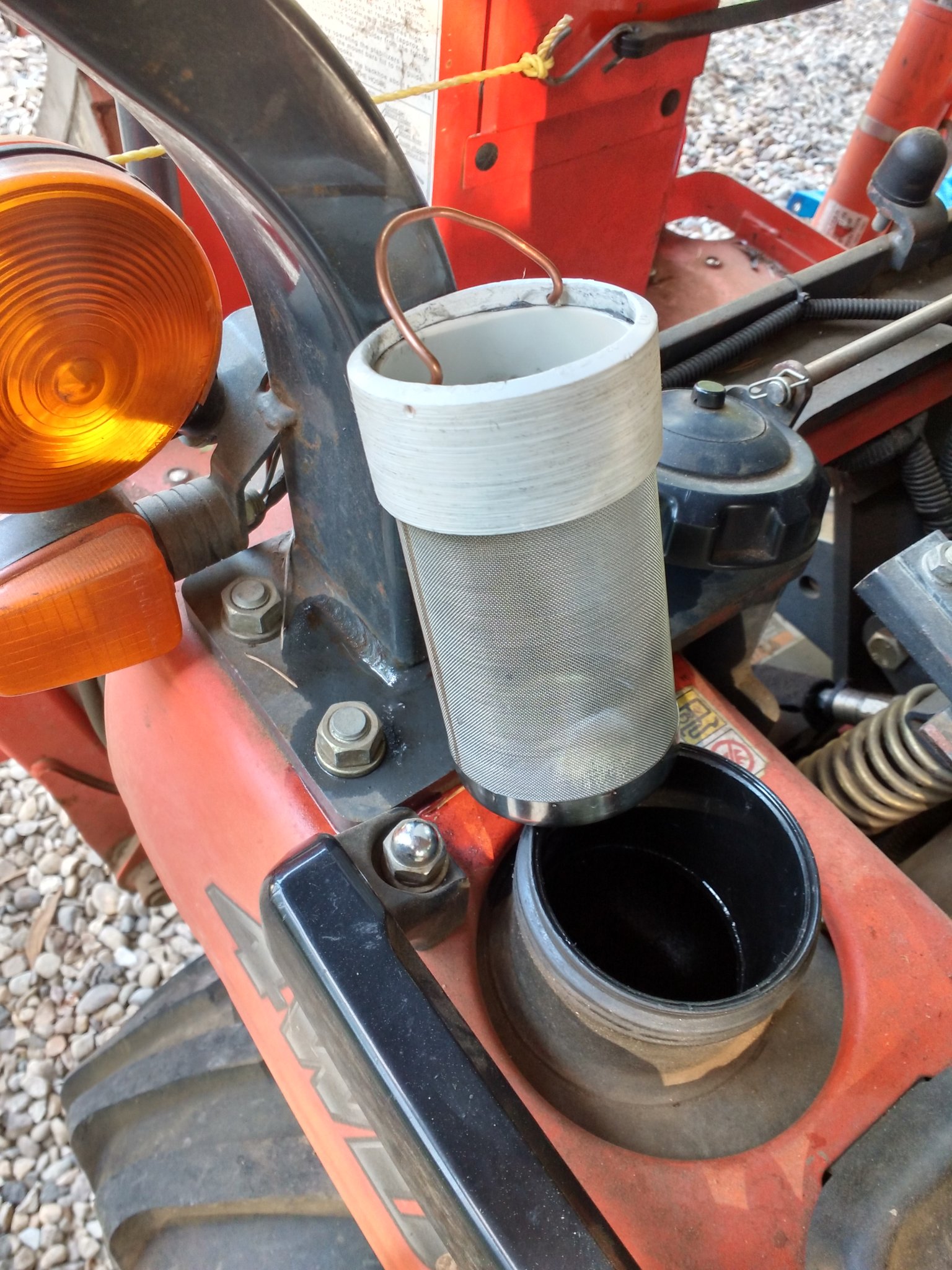

Glad you finally got it fixed, very aggravating when you need it to work and it doesn't. While your problem wasn't from garbage dropping into the tank from outside, you did mention that there was a bit of debris in there when you drained it. Doesn't matter how careful you are, it will accumulate in there again, given enough time. Do yourself a favor and buy/borrow/mygyver one of these to make sure nothing but diesel gets into your tank. fueltankscreen.jpg

Glad you finally got it fixed, very aggravating when you need it to work and it doesn't. While your problem wasn't from garbage dropping into the tank from outside, you did mention that there was a bit of debris in there when you drained it. Doesn't matter how careful you are, it will accumulate in there again, given enough time. Do yourself a favor and buy/borrow/mygyver one of these to make sure nothing but diesel gets into your tank. View attachment 92043
Yes sir, I will look into this, Thank You

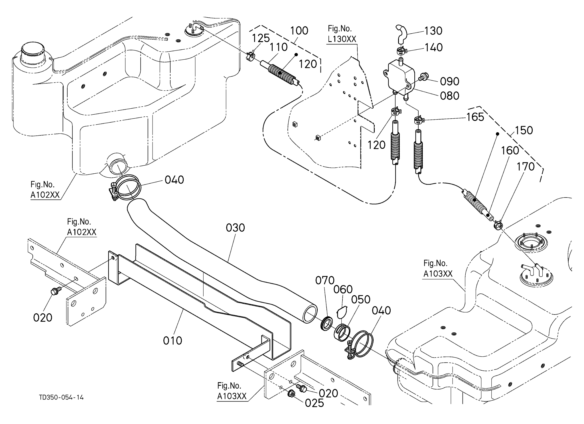

@firefighter206
Glad you got your fuel problem sorted out. I wasn't aware that there was a check valve in the crossover tube. I'm sure my L4060 has the same fuel setup, so I'll keep in mind if I have similar starvation issues in the future. The plastic piece doesn't look capable of totally checking fuel flow, so I suspect it's purpose is to slow down fuel rushing from one tank to the other on an incline?

The flapper keeps the left tank full on hills. Pick around inside the fuel separator elbows. My money is on a little ball of junk in it.
