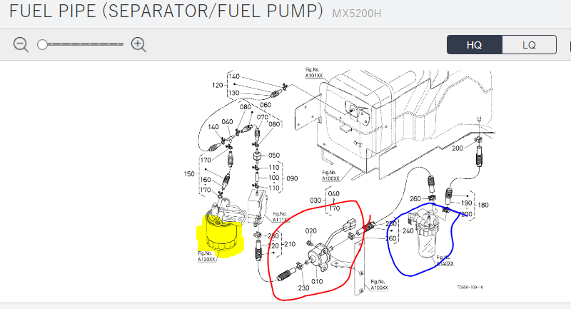

Could be as simple as a bad lift pump (Red).

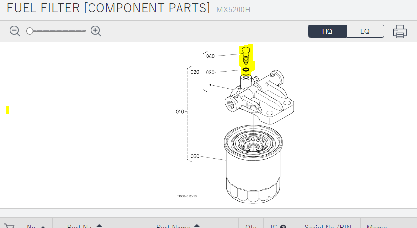

To test for fuel flow :
Remove the plug in the top of the fuel filter housing and turn the key on, you should get a good flow of fuel, if your not, you have issues with separator, filter, hoses, tank flow or more likely lift pump.

Thanks for the reply. I have 850 hours on the tractor. I will give this a try and report back.
