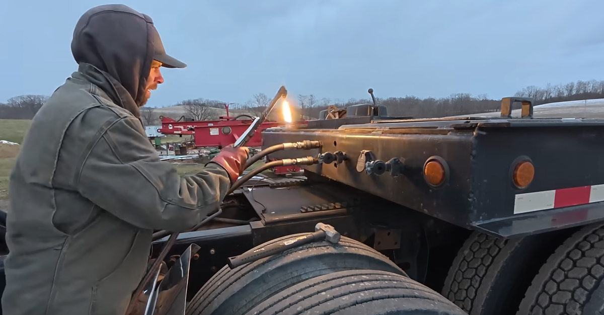

The problem of frozen or hard to disconnect/connect hydraulic fittings when it's cold shows up in various pieces of equipment. I was watching a YouTube video yesterday and the host of the channel was trying to disconnect the "wet" lines that connect to his lowboy trailer. He needed some heat in order to disconnect the lines.
