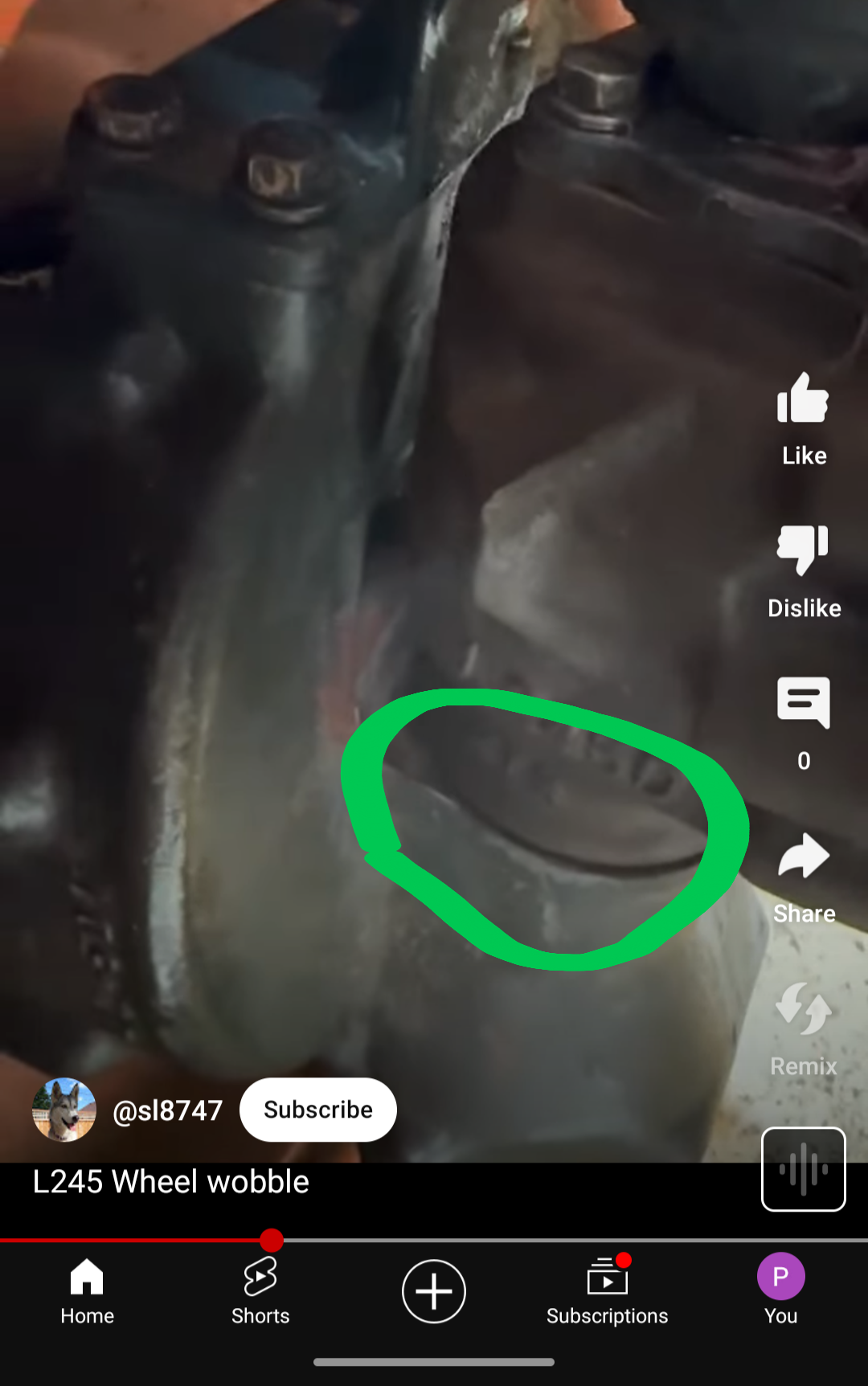

Front wheel wobbles

Axle or case wear would be my two go too's.
Especially with the clunking I'm hearing.
Does it slide straight in and out too?

I'm no expert and it's not entirely clear, but it seems to me the movement is in this area, not the axle. I think that is controlled by the bushings NIW showed in post 6. Did you go into that area?

A part has to be worn to let it move like that.
You'll have to pull it apart and look and measure for wear.
