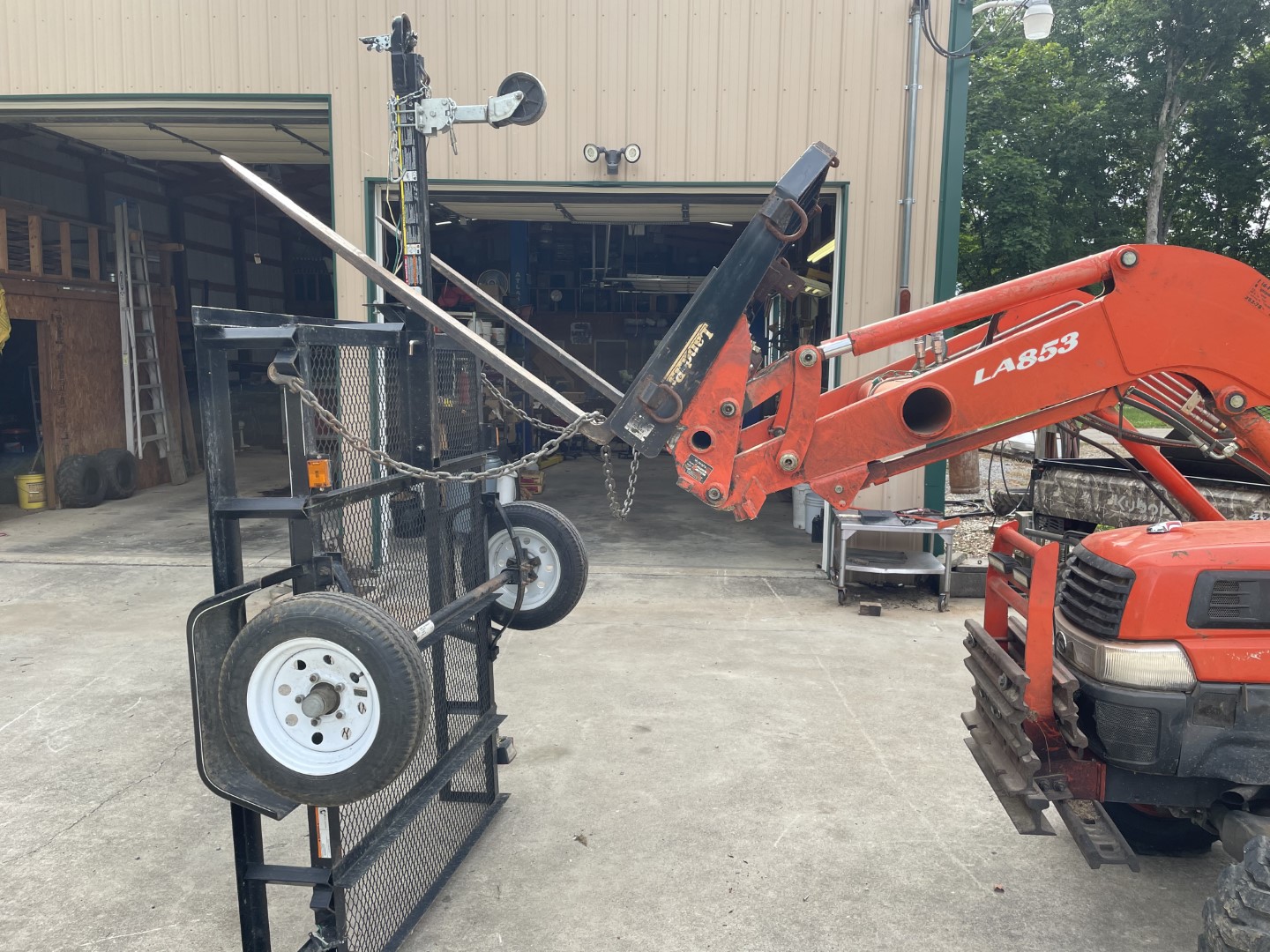

FTG-05
L4330 w/FEL, RTV-XG850 and ZD326S
Jul 21, 2013
339
182
TN
I used railroad fish tie plates or rails:
