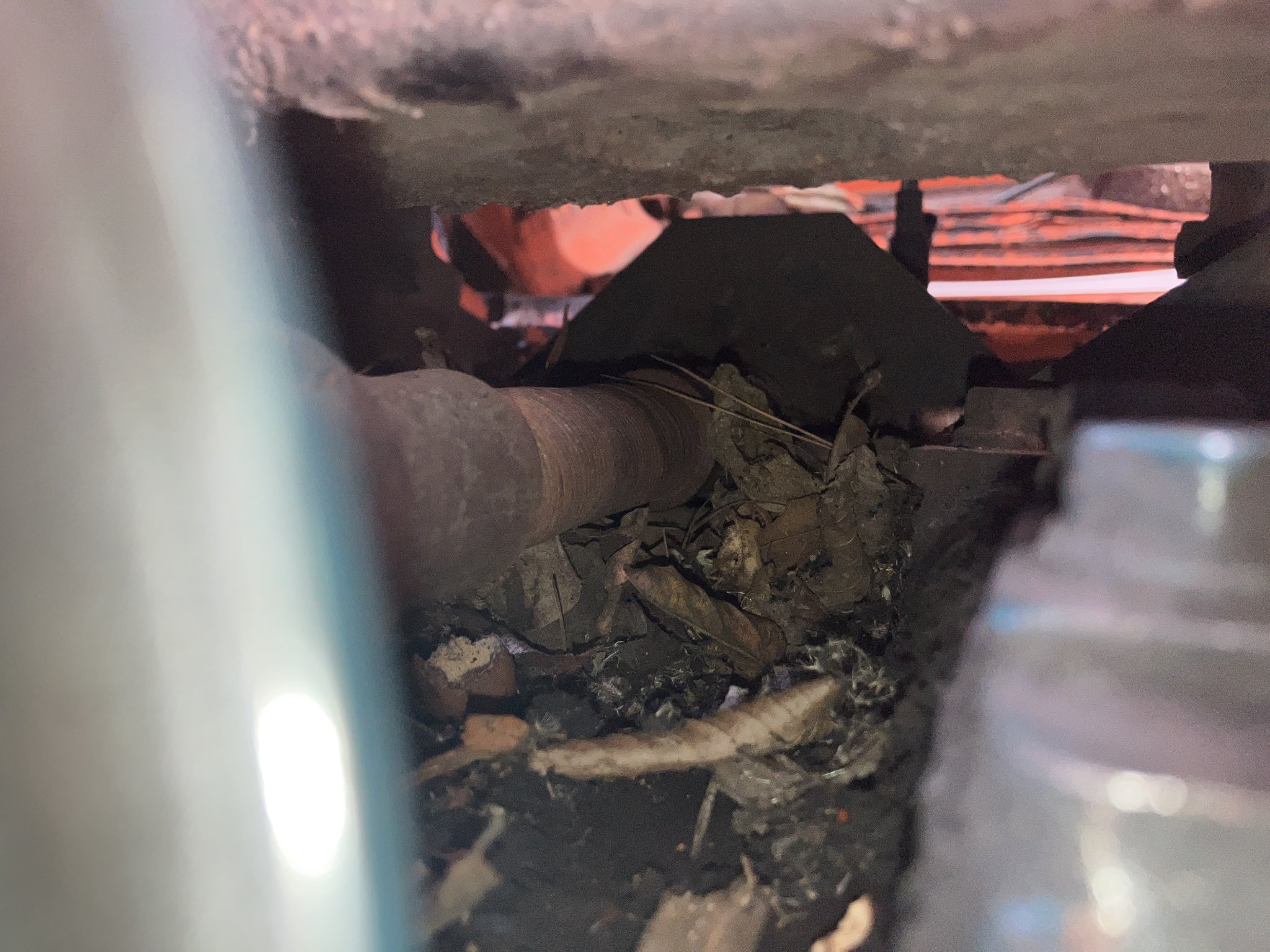

Will try and post pictures when I get back to the tractor. My biggest concern is that when/if something breaks that the part is obsolete. With the tractor being 45 years old I never know if things are stuck together with age and should be able to separate or there's a fastening method I can't easily see. Definitely not a mechanic by any means but trying to learn as I go.
8,736
4,478
As long as you exercise good common sense there is no reason anything should break. If stumped by the mechanism post a picture or two and ask again.

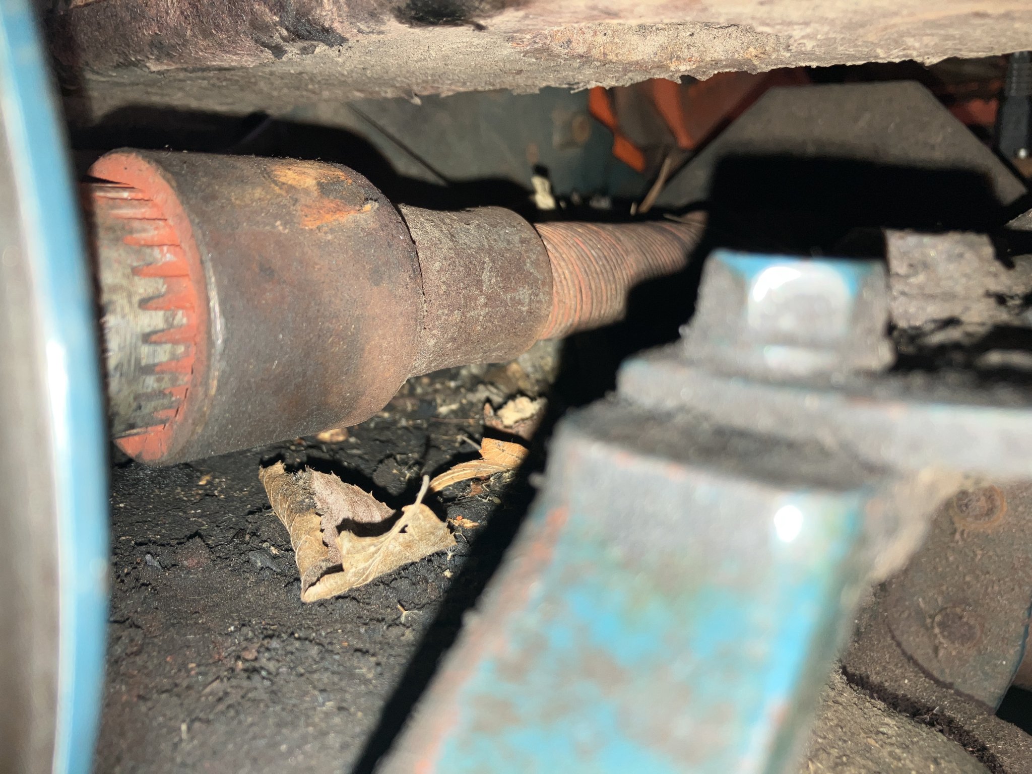

11,405
4,901
hmm, splined coupling not a 'lovejoy',probably on a flexible shaft.
I've never done one but...
I'd mix ATF with acetone (50/50), then pour it into the grooves and splines at the coupling,'flood it' ,wait a few hours, do it again, several times. The idea is to have lots of patience to allow the ATF/ace combo to work it's magic. Any kind of thin 'penetrating' oily stuff will work, though it takes longer in the cold.
The coupling looks like a long springy cable , but it will come out when you pull the pump out.
While you're in the neighbourhood, waiting for the 'magic', scrape out most of the grungy gunk that's laying about. Once you've installed the belt, reinstalled the pump, spray some 'oil' onto that 'springy coupling' section. That actually would like some oil.
Depending on how the pump's mounted, put a box or shelf to support it. I'm thinking the coupling overlap would be 2 inches( ? ), so when you tug, tug on the pump, be careful you don't go 5 or 6. it might come free real fast ! When you reinstall, add a smooth layer of never seize on both parts, wipe off excess,so it doesn't splatter onto the new belt, making it slippery and forcing you to do it all over again.....

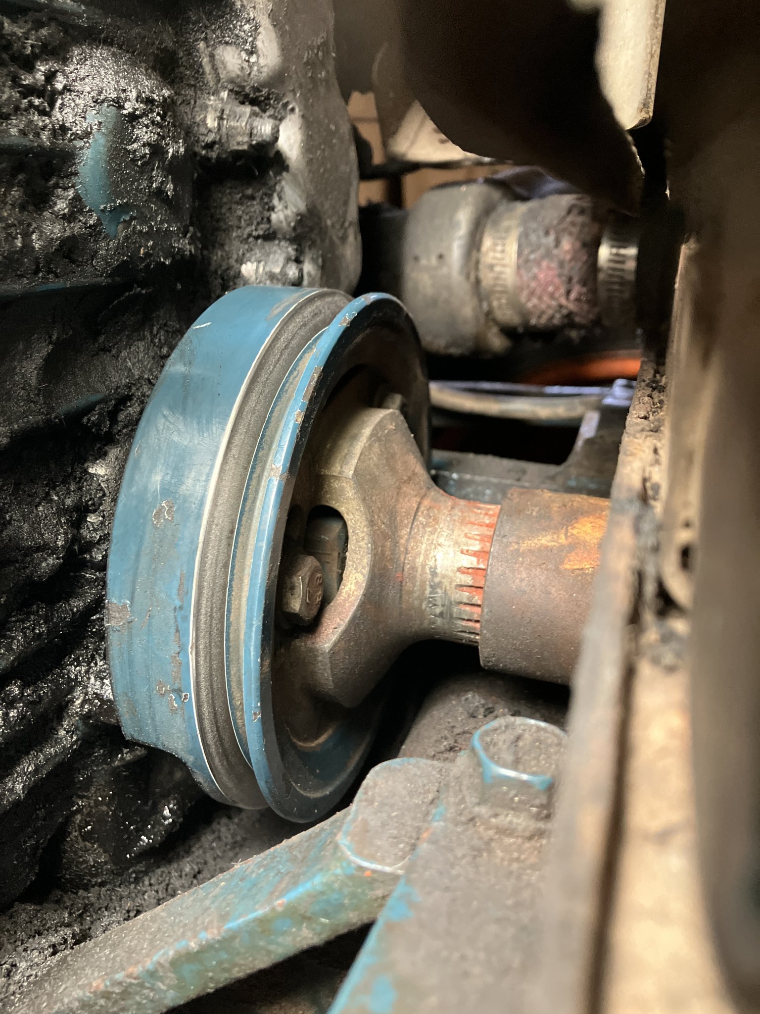

That's what I thought also so I tried it. Unbolted the flange, unbolted the pump, pulled tapped wiggled no forward movement. I'm not sure why it didn't work but thought maybe the flange was pressed into that pulley?
5,364
1,415
Look into that area where the pulley and shaft bolt together carefully with a flashlight and maybe a mirror.
It looks like the shaft has three recessed areas that have a bolt but the area that is solid may be where a bolt is located that attaches the shaft to the pulley. That would make a stronger bolted joint so there may be 6 bolts total (but maybe only three attach the shaft).
While you have the belt off would be a great time to get some degreaser into that area behind the pulley to clean it up some so that gunk won’t get onto your new belt.

Well... I think it's smooth sailing from here. PB blaster to the rescue!!!! I soaked the junction where the flex shaft mated to the flange on the crankshaft, a few taps on the bracket that holds the pump and presto! Now the shaft is split and I should be able to snake a new belt in tomorrow when the parts store opens. I think I'm going to take the advice I found on another forum and put two belts in right away and just zip tie the second one out of the way until it's needed. Hopefully 20 years from now! Thanks for all the advice and suggestions!! This site is invaluable to new owners of old tractors!!!
11,405
4,901
NICE to hear it moved for you ! i was hoping you would hammer the adapter and then break it. While cast is tough, cold can make them brittle'
