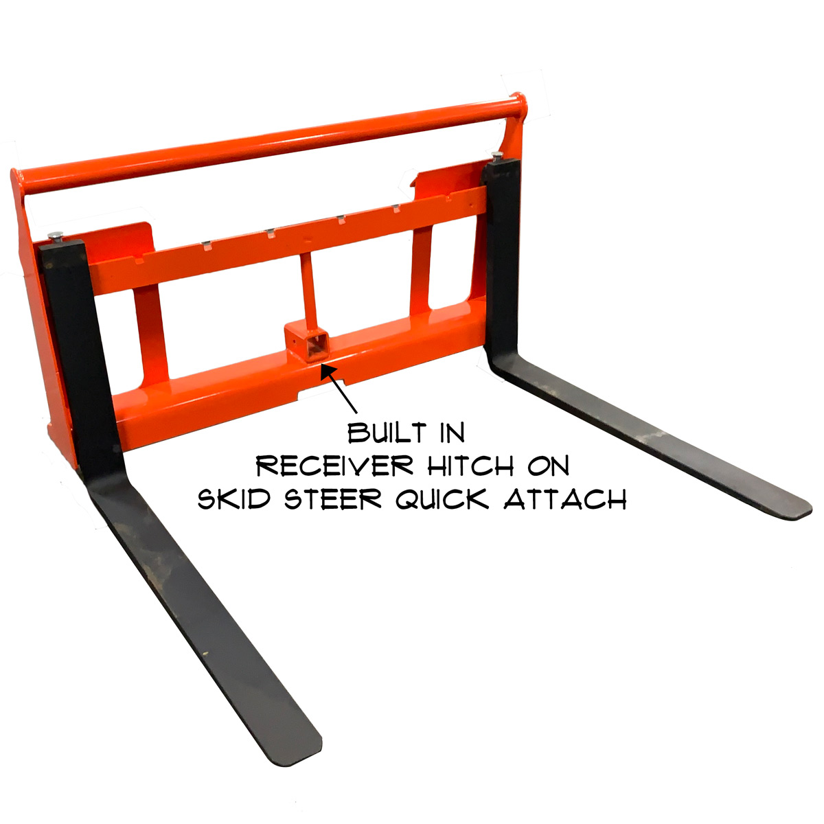

Looking for some advice on front mounted ball hitch for Kubota LX3310. I am parking quite a few items in a large cold storage building and need to be going forward so I can see and placing things pretty precisely.

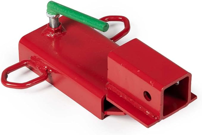

I see they make some simple ones that clamp to a bucket and also some that slide on one or both pallet forks. I could see the pallet fork version giving lots of reach, but also giving up lift capacity. I will be moving a couple fairly large flat beds and a 26' camper. Depending on how it's loaded, the camper has a tongue weight of at least 400-500 pounds.
I also see a more expensive style that goes right on the SSQA so sits close to the front of the loader. Quite a bit more money, but would retain loader lift capacity and likely more tractor stability than a heavy load at the far end of pallet forks.
Interested in experiences and advice you would have.

I think you answered your question, the ideal situation is ssqa with a 2 in. Receiver. The other option are ok for moving lighter boat trailer, log splitter and small Mt 5x10 trailer.

From my experience with a L3301 I wouldn't do a trailer in this weight range with my fork mounted set-up with ball on end of fork. Now a 2" receiver mounted welded to the ssqa frame of say a fork set-up would be whole other story. I have seen this many times before. Seems OP may already have pallet forks so you could weld a simple 2" mount to? Just lift tines off when moving trailers if tongues get in the way.
Receiver tubes are cheap like $30, a rattle can of paint and 1/2hr work and a welder could have you setup ready to go.

There are several options that I have used with mixed results over the years.
1. Forks with 2” receiver in the frame. If forks don’t get in the way it’s fine. However if they do, depending on your patience and number of available helping hands, it’s sort of a pain to take the forks on / off. I use my forks a lot so swapping them in out and is an inconvenience. But if storing stuff seasonally maybe not so much concern.
2. I really like a 2” receiver that slides on to ends the forks…that actually works pretty well and allows you to cut a trailer pretty hard/tight in a Confined space. Tongue weight and proper ballast become more of a concern as the overall length of tractor with forks and trailer increases…if that makes sense. Basically need more ballast if the receiver is at the end of the forks…the tongue has more leverage over the tractor. I am not sure I explain it right, but you will understand if the rear of tractor lifts off the ground.
3. 2” receiver welded onto the bucket. It works great but the corners of the bucket can get in the way. The other issue depending on the tongue height you may not be able to get under the tongue and have to put on manually.
4. I’ve never used the SSQA frame mention above, but I suspect it works. I don’t imagine it would turn as tight as the receiver on forks from number two above, but maybe a bit safer for a ballast point and keeping the rubber side down.
IMO Option 2 above would allow you to turn the trailer a bit tighter I think though, however the length of the forks could be an issue in terms over all length. Most of my frsutrations have been related to where door is in the barn and how tight I need to turn to get something on the front wall. Depending on how tight you want to pack, and room to jockey OA length around could be several viable options for you.

SSQA with receiver, with ballast on the three point.
This will certainly work fine for lifting capacity, but you will most likely not be able to actually see the hitch ball, as it will be hidden from view by the SSQA assembly.
A ball out on the end of a pallet fork, is MUCH easer to see from the tractor seat.
Removable ball mounts that just slip over the end of a fork are readily available.

I had a friend that owned a boat dealership, and they used a tow motor to move the boats around. They used a simple method for attaching a hitch to the pallet fork. They simply drilled a hole through it and put a ball on it. If they needed to tow motor for anything else, it was simple to remove the ball and move what was needed to move.

Totally understand that having a ball on the end of a pallet fork (or 2) is much easier to see. But I noted earlier that one of the things I will be moving is a camper with a likely 600 lb. tongue weight. Even with good ballast, seem like having that much weight on the end of 42" pallet forks could be a stability challenge, and maybe even a lift challenge on an LX3310. Are you thinking that would not be the case?
I had also mentioned seeing longer hitch tubes from 15" - 20" where one could kind of split the difference and get some additional reach but only about half as far as pallet forks as a good compromise for visibility, lift and reach, but didn't get any feedback. Would still like some.
