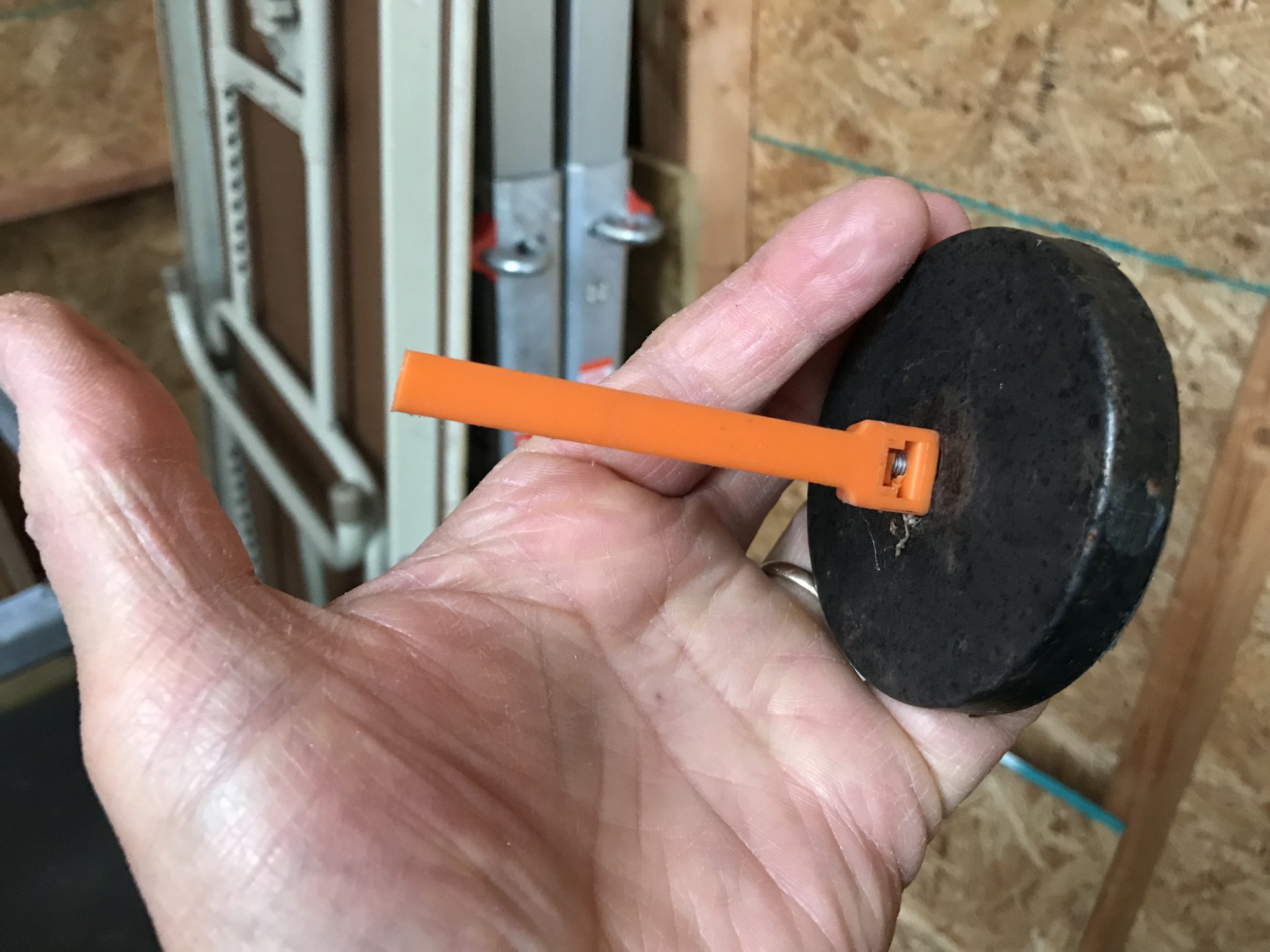

"Whiskers" made from magnets and pieces of heavy orange zip ties that align with parts of the grille guard when viewed from the seat makes hitting the sweet spot easier.
