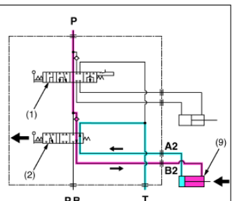

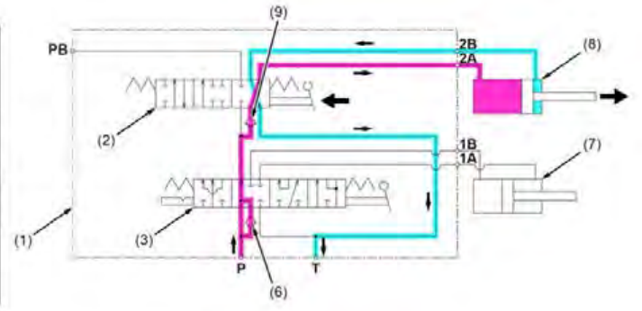

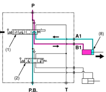

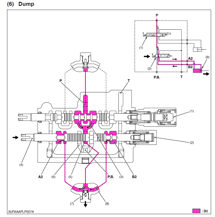

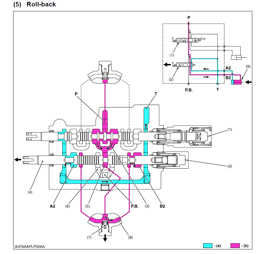

Here are three diagrams from the LA525 loader WSM that illustrate typical Kubota loader valve operation. It is not the same as a typical off the shelf directional control valve. UP and DOWN are the same circuit just reversed. Bucket DUMP sometimes has a fourth position that is the same as ROLL-BACK. The basic ideas are simple but strange and non-intuitive things happen when the circuits get misconnected or down-stream devices miss-behave. That's when knowing the details of how things work pays dividends in diagnosis.

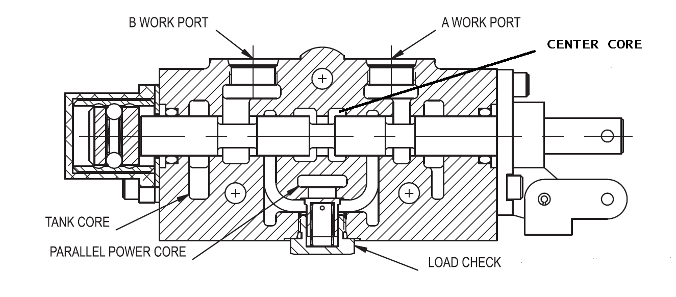

In a typical parallel circuit valve with power beyond the spools do not overlap between pump in and power beyond. When the spool is shifted power beyond (CENTER CORE) first closes and flow is shifted to a closed center parallel core that feeds the work ports and load checks. Metering is performed by overlap between that parallel core and the work ports. The spools are stacked in parallel and receiving the same inlet oil flow and pressure via the closed center parallel core.
In the case of the lift spool on the LA525 loader valve the exhaust oil from the cylinders is routed back to the power beyond core rather than tank to power a down stream valve or to tank if the down stream spools are all in neutral.

To expand on what @TheOldHokie said: "In the case of the lift spool on the LA525 loader valve the exhaust oil from the cylinders is routed back to the power beyond core rather than tank to power a down stream valve or to tank if the down stream spools are all in neutral."
Below are close-ups of the hydraulic diagrams he posted.
  • In "UP", the exhausted rod-end fluid is routed to power-beyond.
  • In "ROLLBACK" the exhausted cap-end fluid is routed to tank
  • In "DUMP", the exhausted rod-end fluid is routed back to the cap-end. While this significantly reduces the force, the extension speed is higher because the cap-end volume is being filled not only by the pump but the fluid getting pushed out of the rod-end.

ROLLBACK -- fluid exhausted out of the cap-end is routed to tank

DUMP -- regenerative extension
