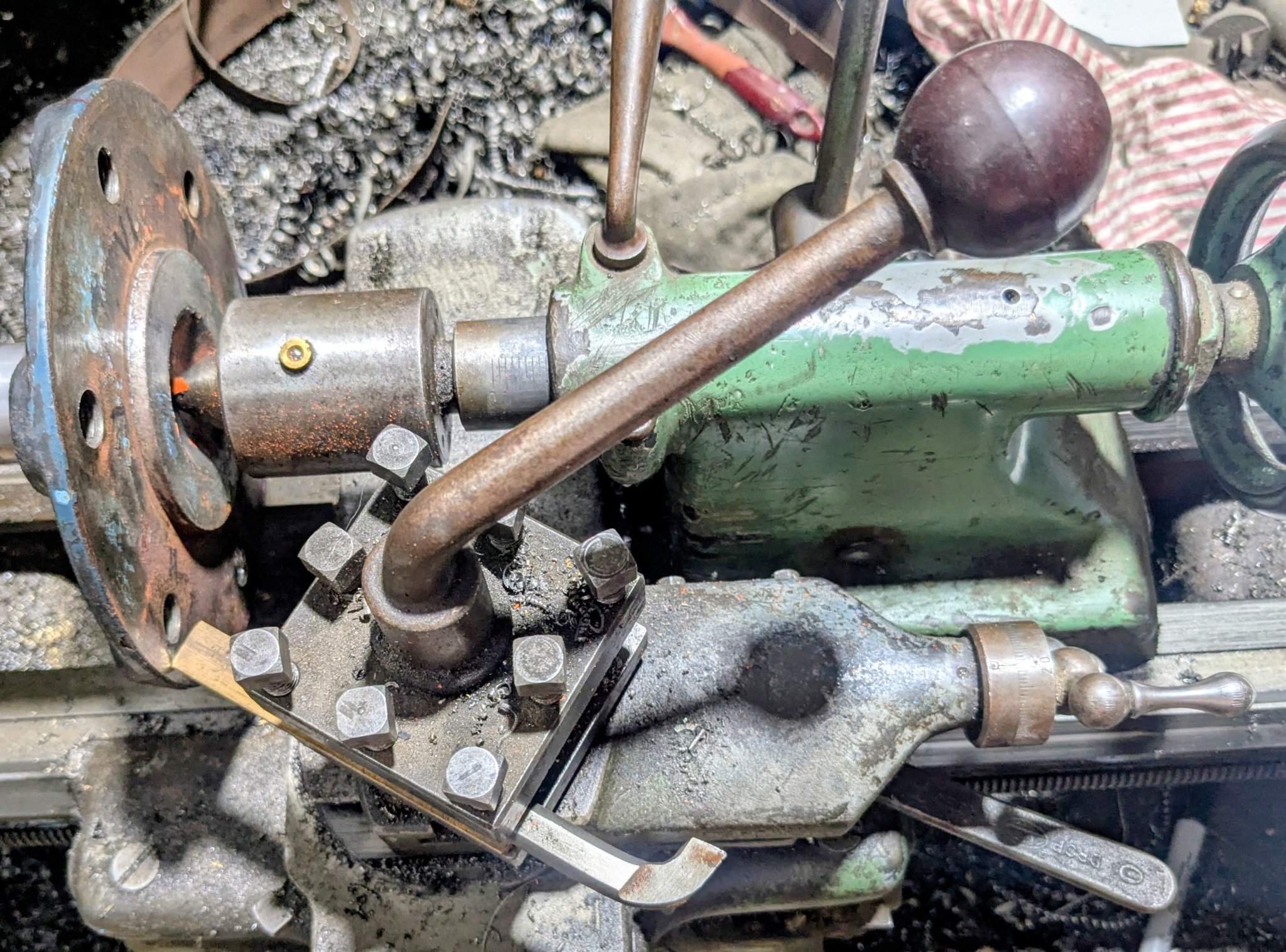

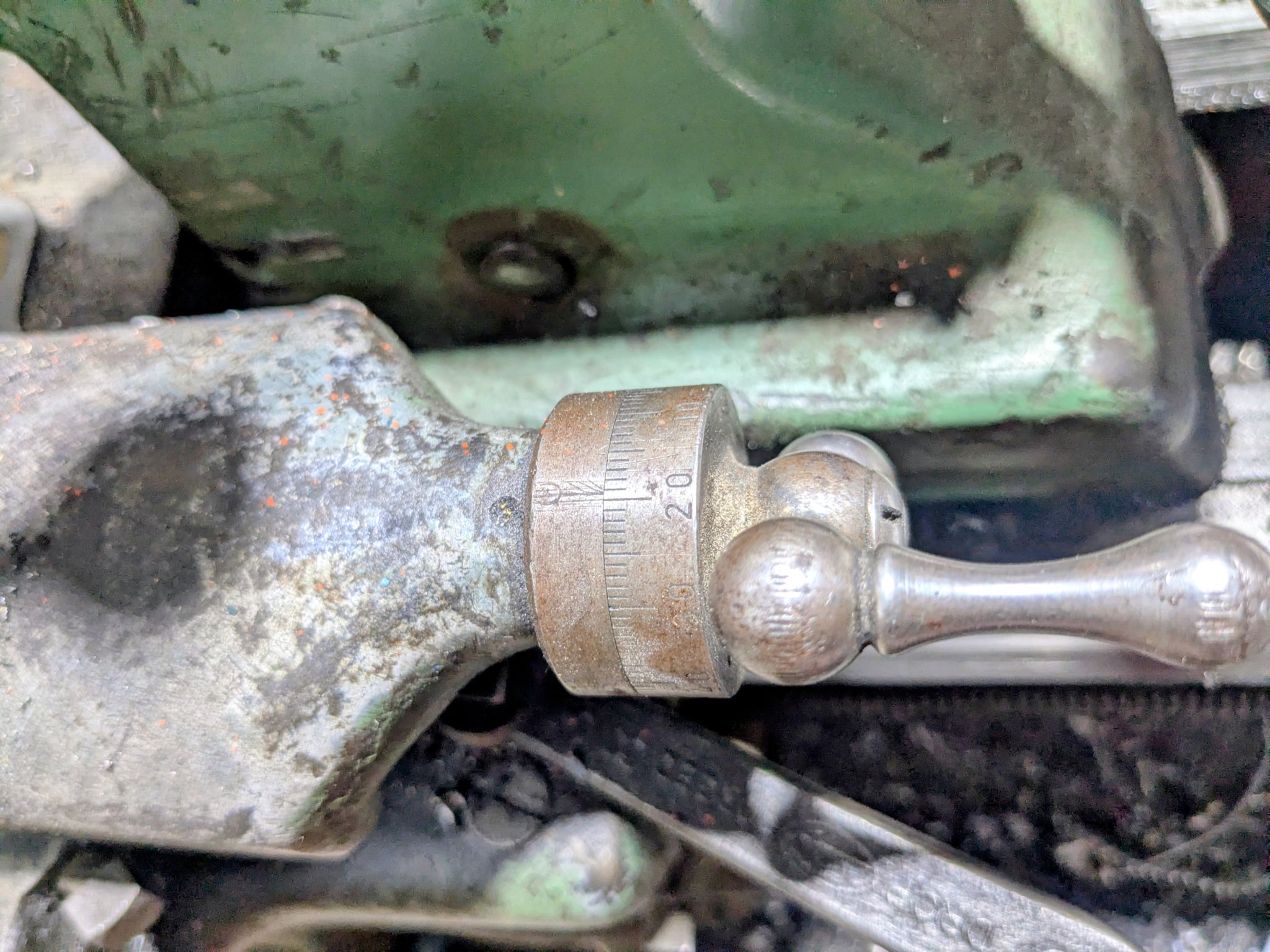

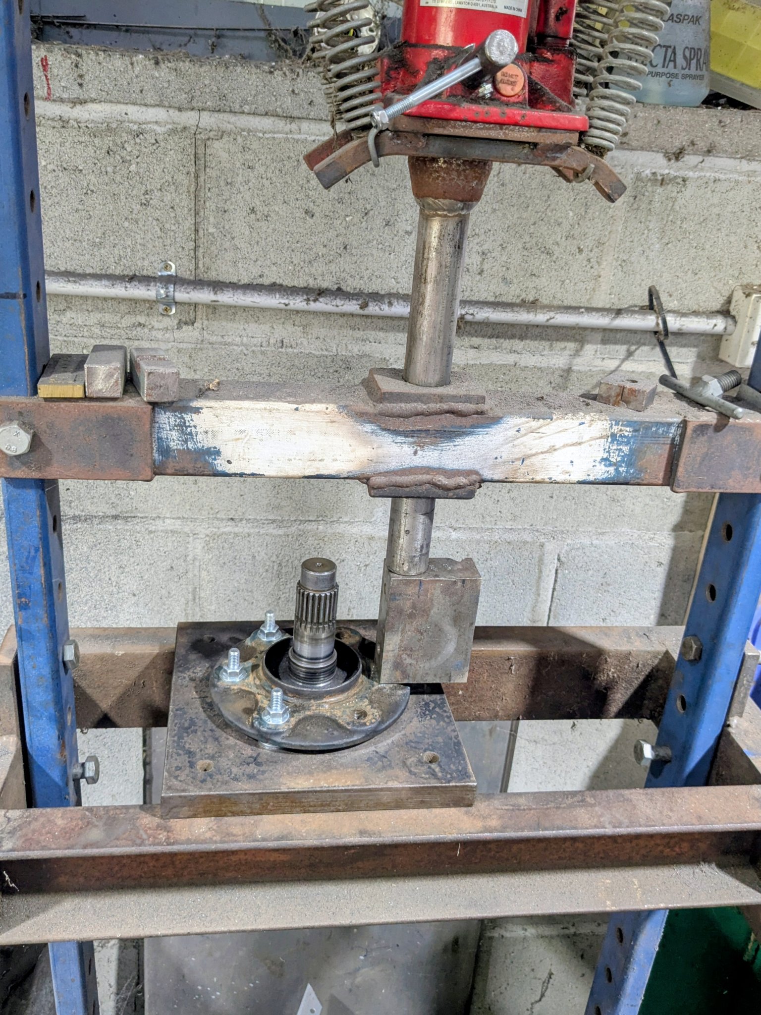

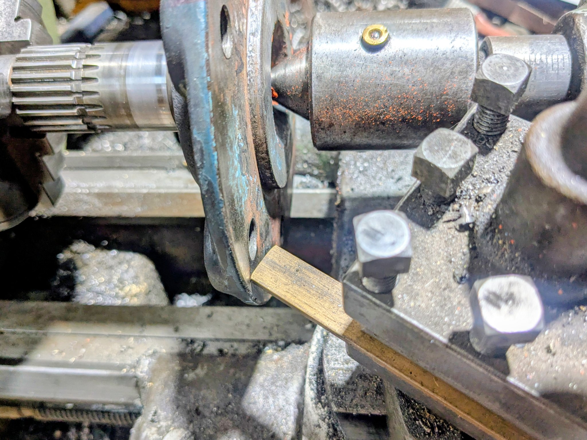

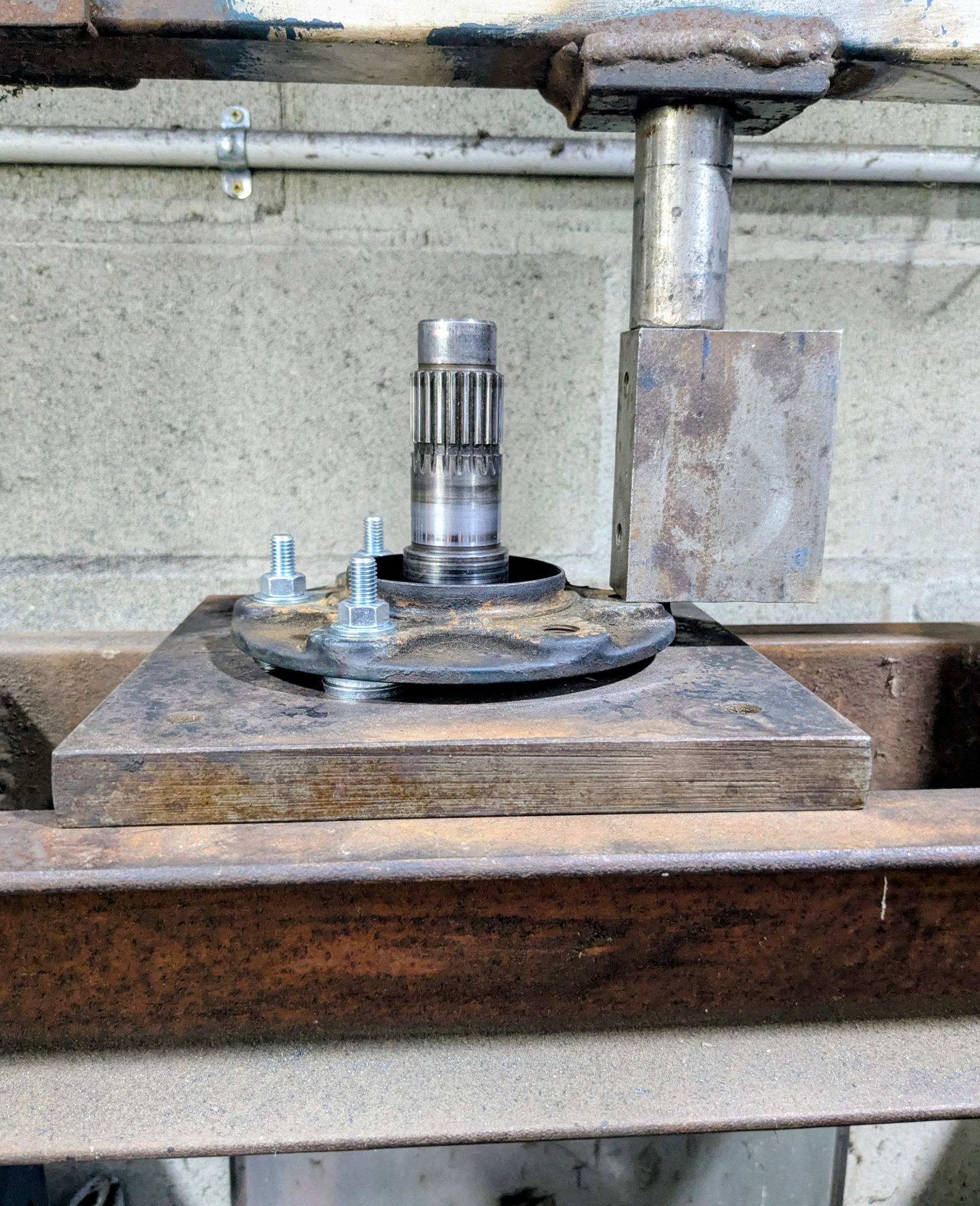

I had a go at pressing the flange today and managed to reduce the maximum runout from about 5mm to 1mm. This took a few goes and the last couple of attempts would help in one spot but not in another. So without lots more time in making a fancier press setup, I decided that would be good enough. Also keen to stop before anything cracked - didn't know how close I was and didn't want to push my luck.
If it still bothers me I may use some JB Weld as someone suggested above.
Given the comments and commenters so far, I haven't put anything back together yet. Always happy to receive these great comments and suggestions.
Here's a few pics and videos of what I did.
Pressing with the flange bolted to a 1" plate.
Checking runout using the graduations on the top slide on the lathe.
View attachment 169044 View attachment 169045
Final runout way better than when I started.
Checking shaft - +/- 0.004". I think this is ok.
Checking hub that located centre of wheel - +/- 0.010". I think this is ok too.
