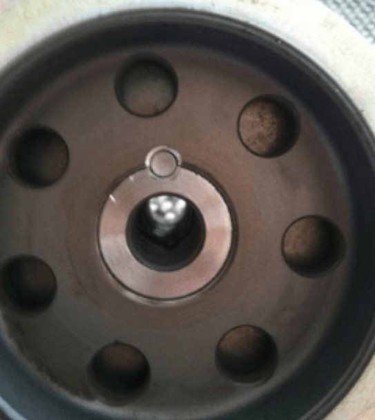

When I raised and removed the right front wheel I did notice the the right front hub, while it runs true, moves freely in and out about 3-4 mm. So while I'm doing this I'll also pull the right side apart to see what's allowing the play and see it it's something I can fix.
Looking at the pic below of the bits I removed and disassembled from the left side, it looks like the in-out movement is limited by:
- The 2 half round pieces circled in red that locate in a groove on the shaft at the yellow arrow.
- These are held in place radially by the bore on the end of the gear circled in blue and sit against the spacer (green arrow) that slides over the shaft.
My thinking is that things that could allow the in-out movement to increase are:
- Half round pieces are worn
- The groove in the shaft is worn
- The spacer is worn (or an incorrect spacer had been fitted at some stage).
The half round pieces appear to be all the stops the shaft from coming out completely - not really something I'm keen to have happen if there's a problem I can fix first.
I'll let you all know what I see when I get to pulling the right side apart.

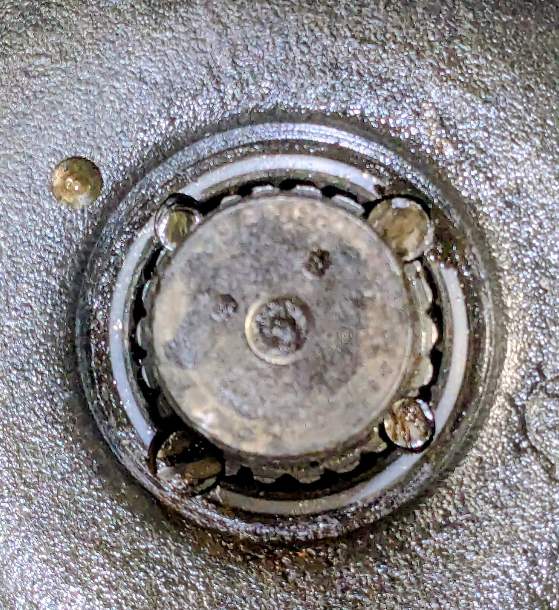

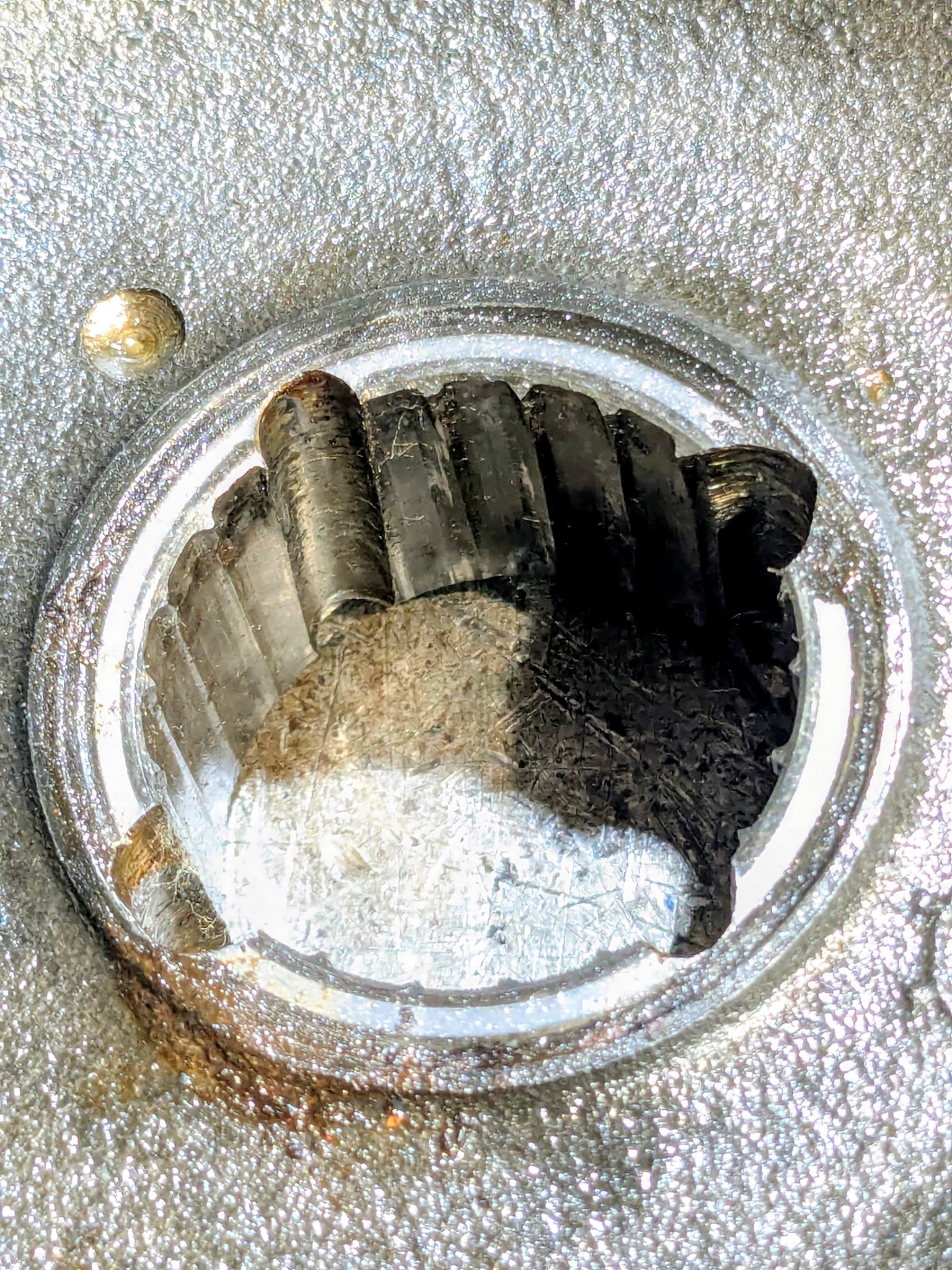

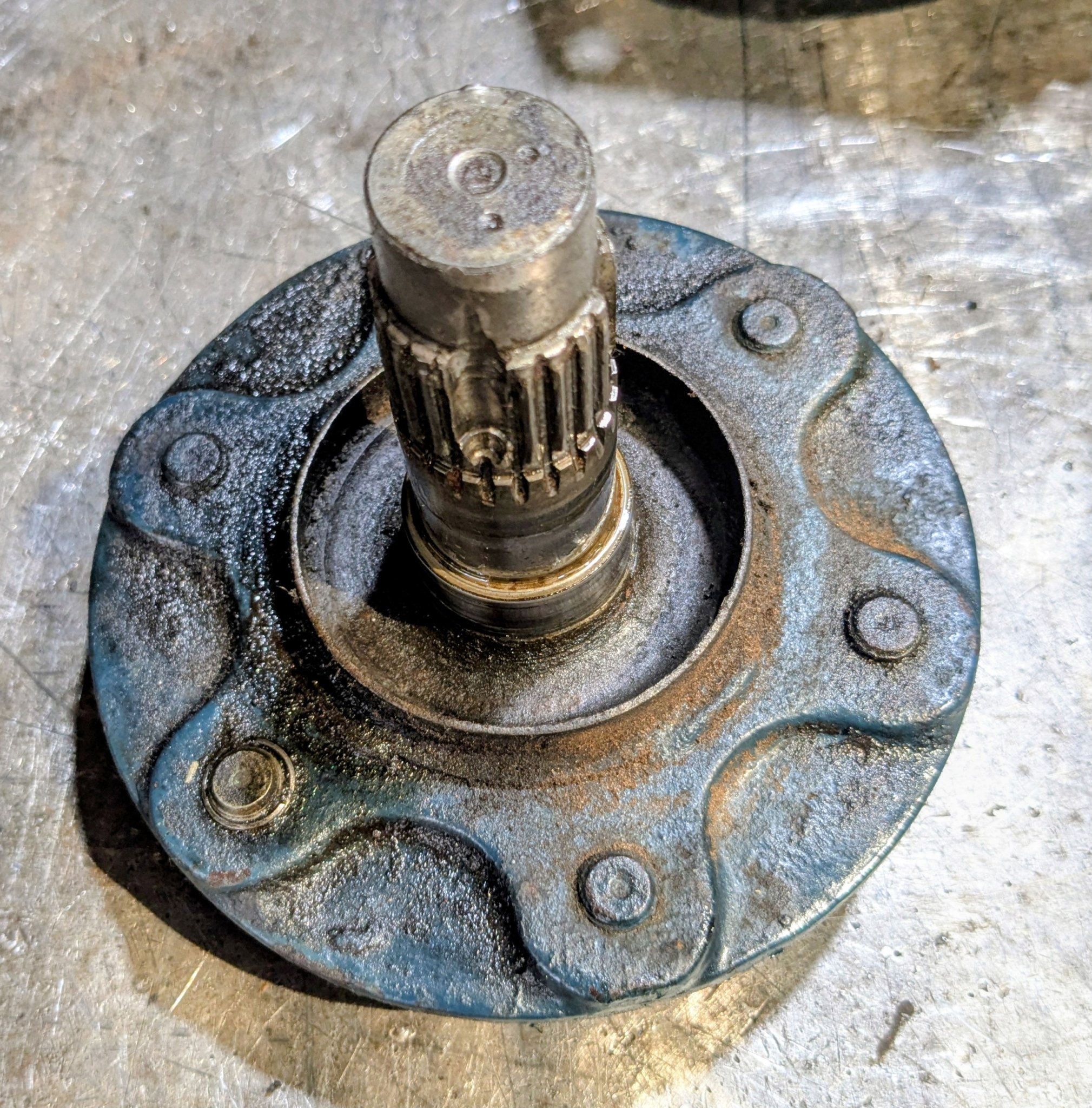

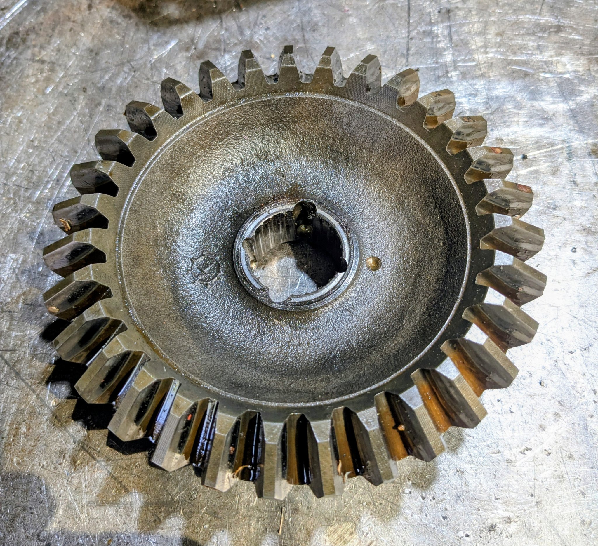

I thought the left side was bad....
The in-out play on the right front had me worried enough to want to pull it apart to have a look at what was causing it. Given the amount of dirt caked on the outer surfaces, and the slightly muddy oil, I wouldn't be surprised if a seal is leaking too.
The insides weren't quite what I expected.
The spline on the inside of the large driven gear is gone and the gear has been pretty roughly "keyed" to the shaft using four round pins. I can't tell how good or bad the holes were when this was first done, but the holes and the pins all look pretty rough now. Also have no idea how long it has been like this and how much 4WD use it has with this "fix" in place. I did notice a fair bit of backlash before pulling it apart but didn't measure it.
The in-out play is now starting to look pretty minor.
I'm open to suggestions for what to do next.
One option is to put it back together as is and keep using it and hope for the best.
Another option is to "scotch key" it properly (maybe with plain pins, maybe with grub screws that also follow the line of the shaft) by making a sleeve to fit over the plain end of the shaft, re-drill the holes and fit new pins to eliminate the current play. My guess is that this would help it last longer.
What do you think. What would you do ?

Grub screws only as a temp fix until you can source new / used parts to replace the damaged parts.
Paul Allwood
Kubota B7200HSTD, homemade FEL, front flail mower, forks & ballast box, tiller
Jul 8, 2025
861
1,600
Baranduda, Victoria, Australia
I was thinking of using the grub screws as a Scotch key. Holes drilled axially along the shaft - half in the shaft, half in the bore - then tap for the grub screws. I used the same method to attach a large worm wheel to a shaft on a winch I made for our old 60 series LC years ago, but that's the only time I've ever done it.
I guess I'm preparing for the parts not being available here or being really expensive, but I have already emailed the local Kubota dealer.
Like this but with 4 grub screws to make it tight but still allow easy disassembly. One problem I'll have is that for this to work well the shaft and bore need to be a good fit - I don't have that with the worn splines.

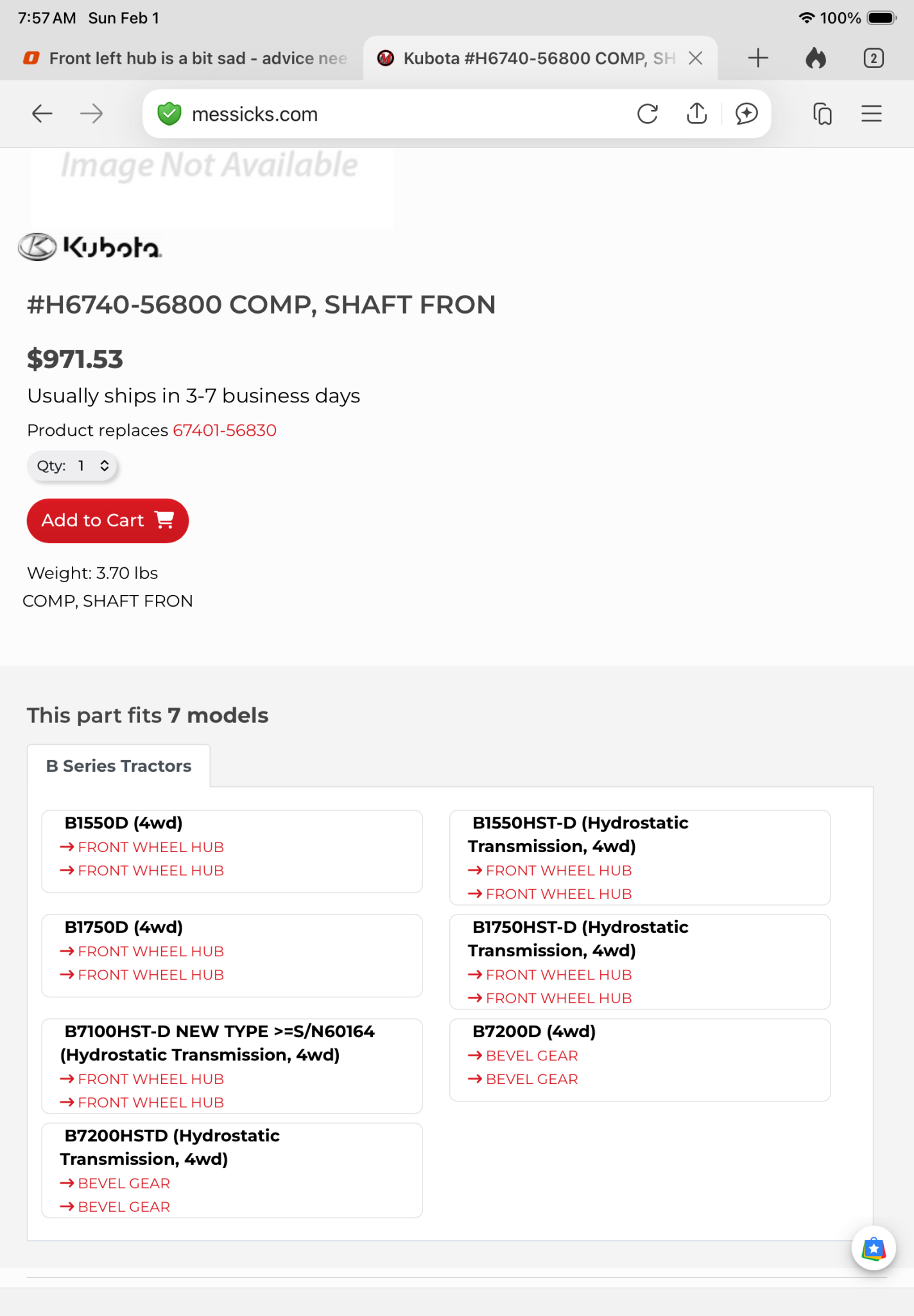

I've just found these parts with the ruined splines on Messicks - approx $2,400 Australian without postage. Unfortunately, that's not going to happen. I'll either need to find a much cheaper source of parts or I'll be trying the scotch key approach - doesn't seem like I've got much to lose.

@Paul Allwood
There is a way on Messicks to see what other models a part number was used on.
when looking at the parts list the part number is a hyperlink to the price and availability. When on that page there is a button at the bottom that says something like ”see all models used on”. Push that and you get a list like this
36,626

OUCH!!!
Scotch keys work fine but will never produce the torque carrying capacity of the OEM splines. We already know the splines failed so....
