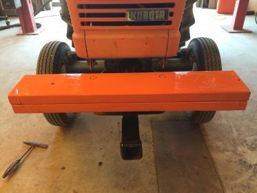

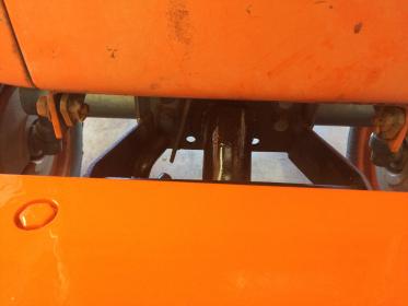

Have had the need for a front hitch for a long time,decided it was time.
Cut up a truck hitch and used the square welded to the round tube, extended it to front bracket mount. image.jpg
Should be atrong enough.

I dont have the front end loader, so this at least gives me an option, especially when mower is on the three point. Was attempting to run a second mower offset out front but my plan seems to be a little more difficult than anticipated.

I used it today to move a large pontoon boat. Now i dont have to drop mower to move stuff. Have a push bar,6 feet long with a trailer coupler on each end. Dead pickup? No problem, drop bar on ball and connect to tractor front ball. Push truck into shop. No helper? Put tractor in low low 1st gear and walk between
The two steering it into place. Slow, but doable without help. And it will pull too.

The other option is to blow a hole into a fork or bucket. Drop the ball in when you need it.
Aparrently a hole in fork compromises the integrity of it. My forklift has a hole.
Hole in bucket, cant see to grab trailer. So ball goes on top of bucket.
Again , i have no loader on L1501. Next is gathering pieces to build an adjustable ball mount, where i can roll up and grab trailer without dismounting tractor.
