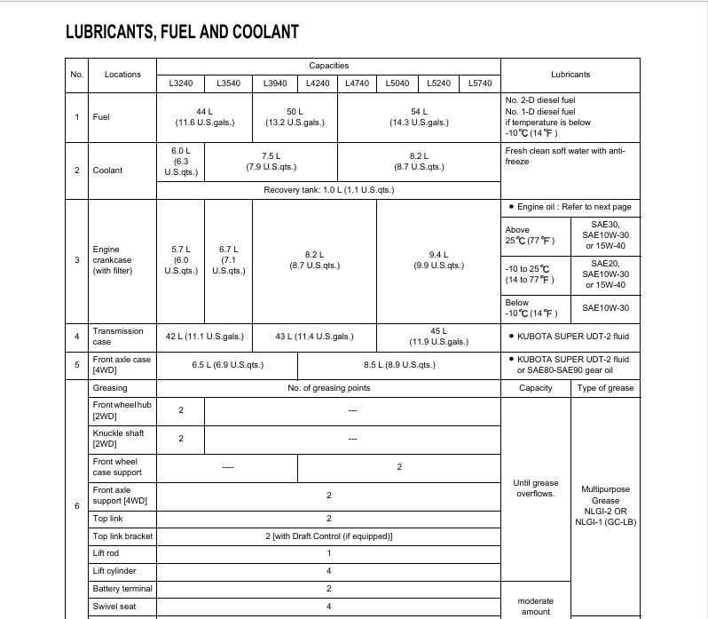

Here is a screenshot of the operator's manual for an L5740HSTC-3 as theOPM always has to most up-to-date information.
33,124
8,514
Here is a screenshot of the operator's manual for an L5740HSTC-3 as theOPM always has to most up-to-date information. View attachment 153852
So there is a huge discrepancy between manuals?
Did they change the axles between the L5740 and the L5740-3 and info didn't get transferred to the -3 older manuals?
I hate giving bad info! 🤨
Thanks for providing the right answer! ;)
I edited out my bad info! :confused:

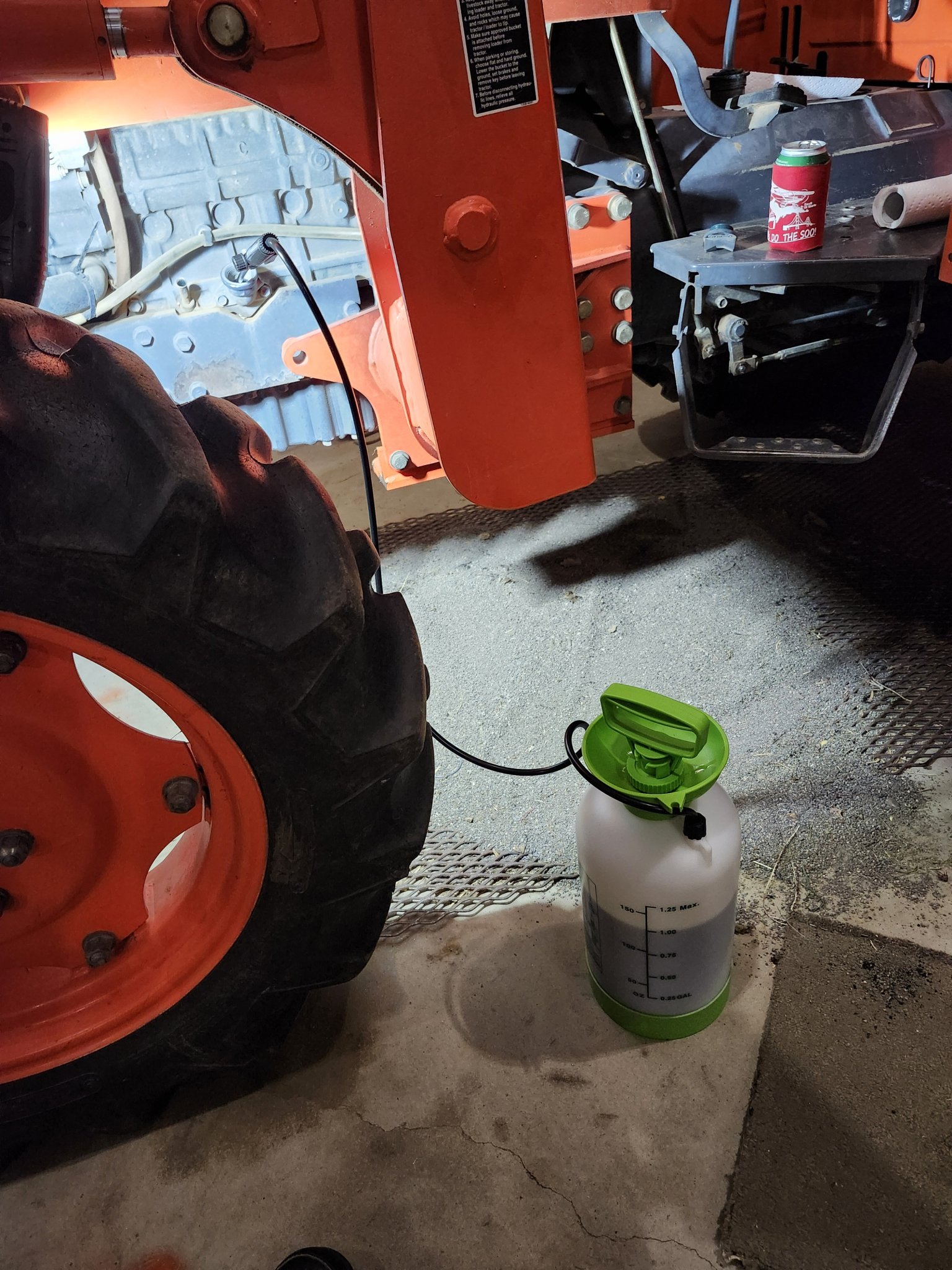

i have a pump-up garden sprayer purchased New for the specific purpose of installing gear-oil. It has graduations on the tank. So when I drained the front axle (at each wheel)… I knew it was properly serviced when I pumped 8.5 qts into it as indicated on the sprayer tank.
I have several of these cheap ($15) sprayers…one for gear oil…one for hydraulic fluid for an small airplane brake system…and others for other specific purpose fluids.
The engine oil-filler on my M4700DT is difficult to pour oil into due to the frame blocking it. I install the fresh engine oil in a sprayer…. pump it up…. flow the oil into the engine.
Hope this is a helpful idea. <edit> Cut the spray nozzle off. Also the handle has a locking trigger which allows me to walk away or perform some other task for the few minutes it may take for some tasks. AND…since the fluid is sent under pressure…it’s a really simple way to back-fill brake systems from the wheel cylinders without having to “bleed” air out.
