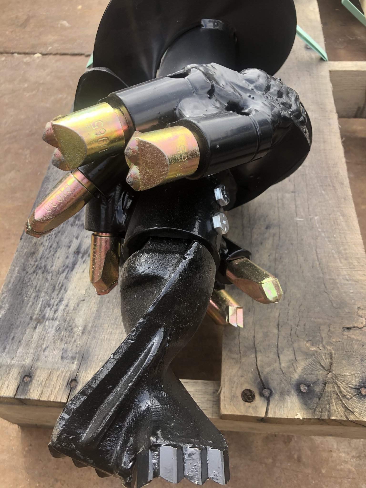

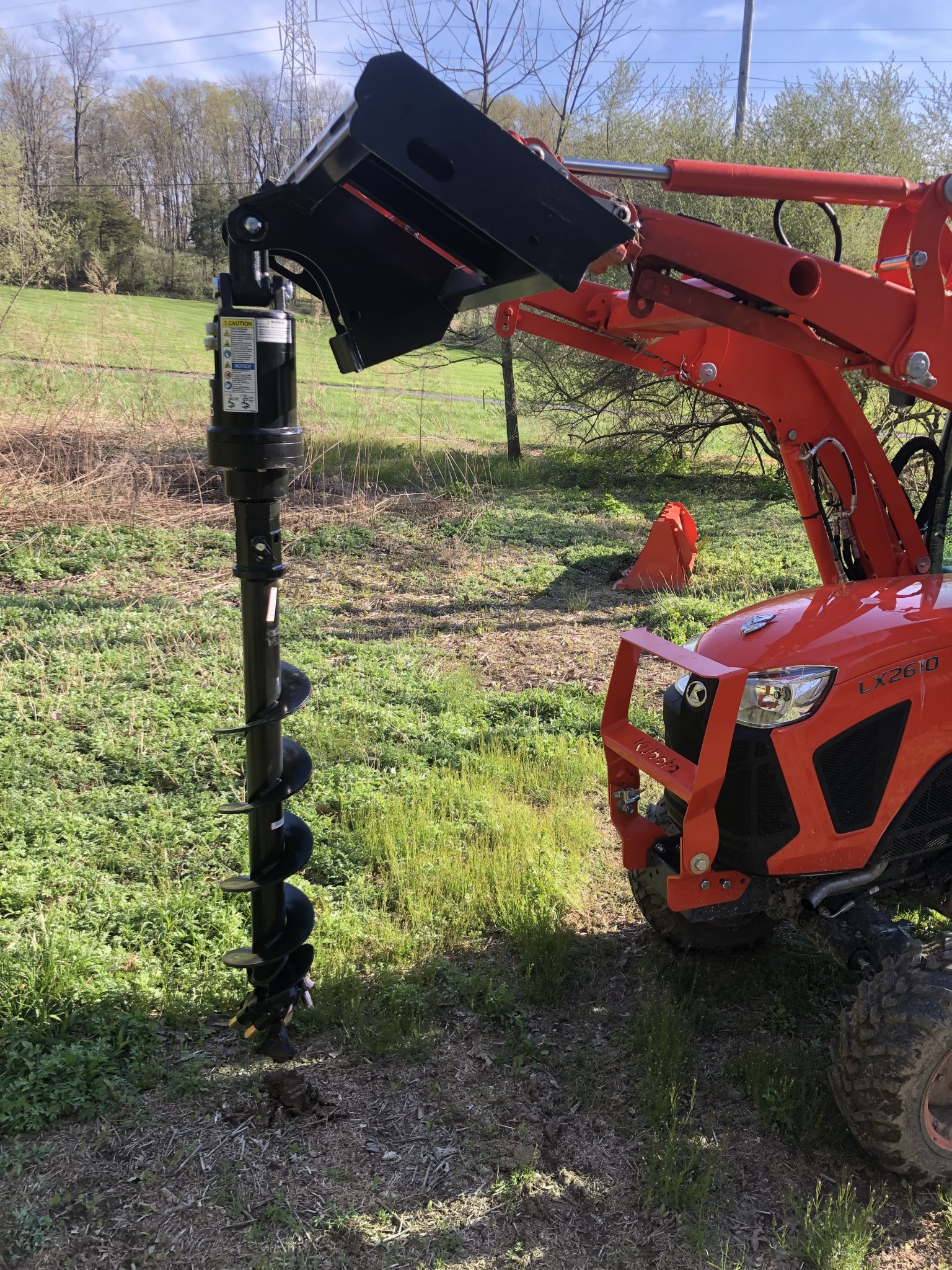

@Njtool did you get the one from Land Pride?
Nope. I ordered it through Everything Attachments. It’s a Digga DDD. 5-12 gpm flow
I got the 9” rock auger too. I’m not sure what I will be digging In, I have lots and lots is holes to drill.
