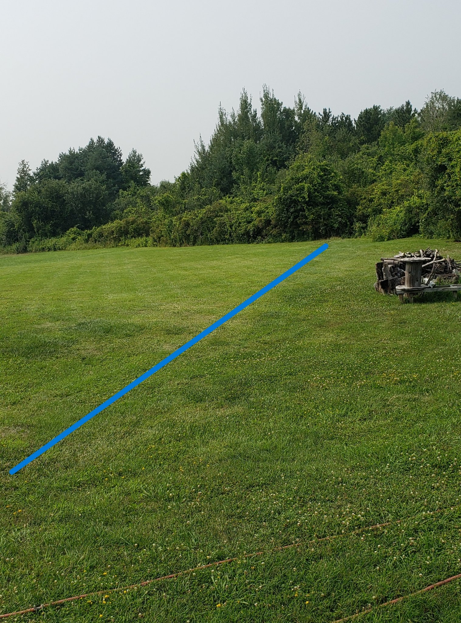

Built a 2-story ranch in 2007. Has 4” drain pipe around the perimeter with capped risers (cleanouts?) to above grade on 3 out of 4 corners. In the west corner 4” solid pipe runs from the footing out 165’ to daylight, so no sump pump is needed.

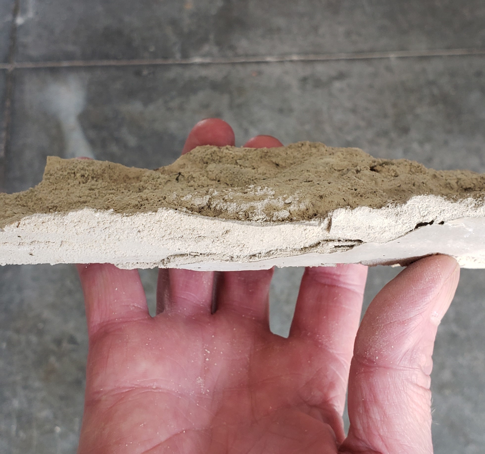

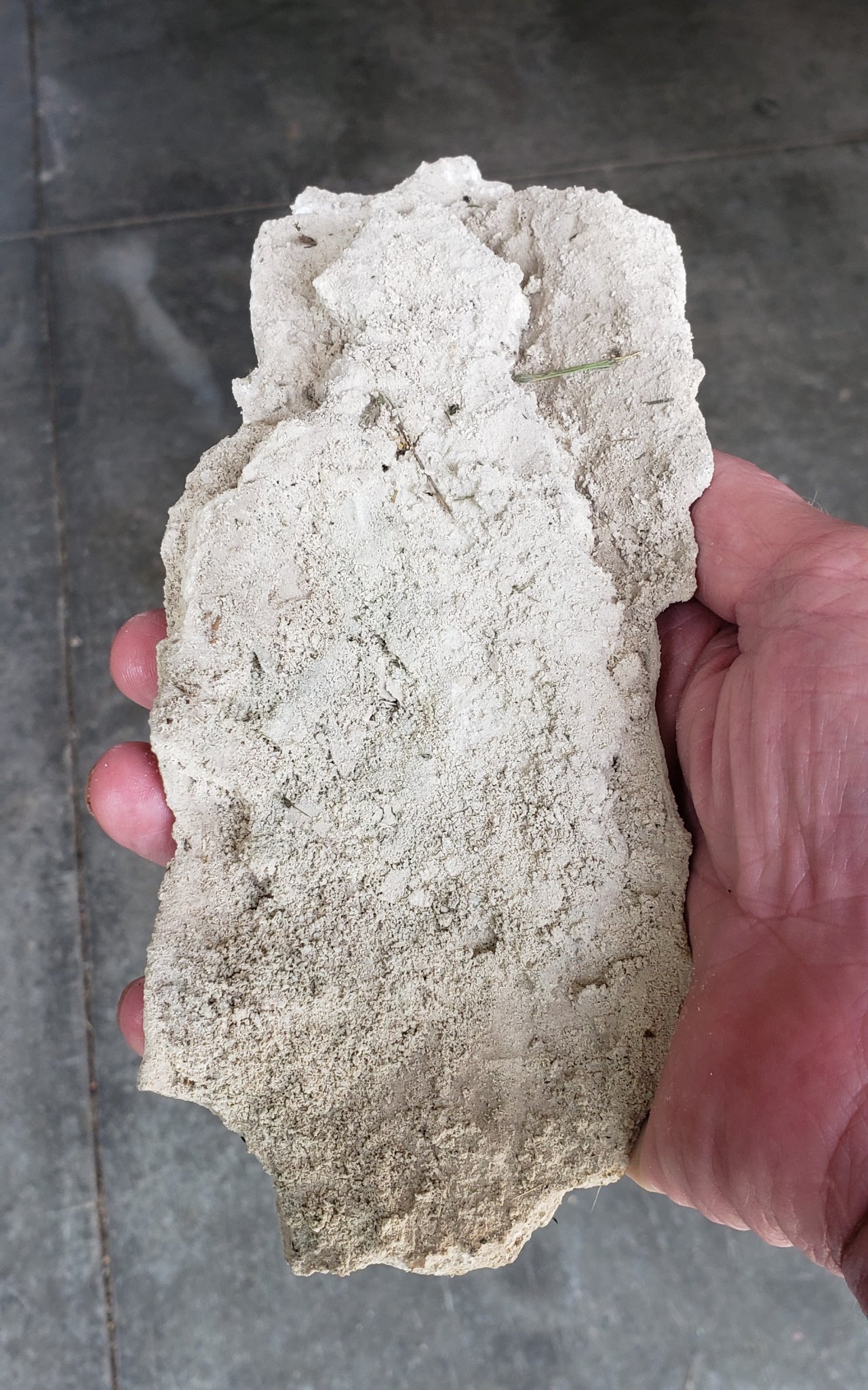

Weed-wacking around the outlet last week I noticed some build up in the mouth of the pipe. Reached down to clear it and it’s like rock. Got my longest pry bar and mini-sledge and managed to chip some of it out (picture). Very hard stuff - probably hardened minerals/silt. Wouldn’t be surprised if there weren’t critters in there to boot since no end cap on the outlet.
I’m worried that it will eventually plug the drain since it’ already 1/3 plus at the outlet. Not wanting to wait until I get a wet basement I thought I’d better address the issue now.
Power-jet, roto-rooter, dig it up? Would rather not dig up hard clay and shale if I don’t have too, 7’ - 8’ deep at the house.
Has anyone here had similar issues / what did you do / what did it cost?

165' drainage run and mineral build up

Pretty sure its mostly mineral deposits. We have extremely hard water here.
There are under ground springs coming off the hill, the yard doesn't dry out until mid-June most years. the drain will run even in times of little to no rain.

lime and Calcium
I wouldn't do anything about it.
Any of the main line cleaners could clean it right out.
CLR will also break it down and clean it out.
But it's risky because if it leaches out into the foundation it could damage it.

Looks like someone has the water softener draining into the weeping tiles?

Maybe an inexpensive and relatively harm free option for removing calcium, magnesium if that is what your "concrete" is.. Citric acid solution. Inexpensive crystals/powder available at major retailers. Try testing a chunk of your "concrete" before purchasing an industrial size amount. Use to use it for descaling boiler heating elements in espresso machines. Just requires a bit of time to dissolve build up. If any copper plumbing? Beware that citric acid will strip the oxidized protective patina off of it. Blue green water is a hint. IIRC, CRL has lactic acid and ????

for sure find out what WILL dissolve it , NOW.... though you didn't say how long it took to get that plugged up.
once you know what will get rid of it, maybe setup a tank,[pump, timer to add the 'dissolver' on a regular basis.
wait too long and that 165' run of pipe WILL have to be dug up and replaced, maybe with 6" or larger.

White vinegar (acetic acid) can dissolve calcium and some mineral deposits.
CLR will also work (phosphoric acid) does a good job of breaking it up.
Muriatic acid (hydrochloric acid) works really well on tough deposits.
Yet, a couple of items of note. You are using a strong acid mixture. So, it can damage things and need to be aware of where the mixture is going. Also, the fumes can be harmful.
Playing with acids can be dangerous, so take the time to educate yourself and don't assume just because it is sold at the store that it must be safe to use.
Used improperly, these can be deadly.
