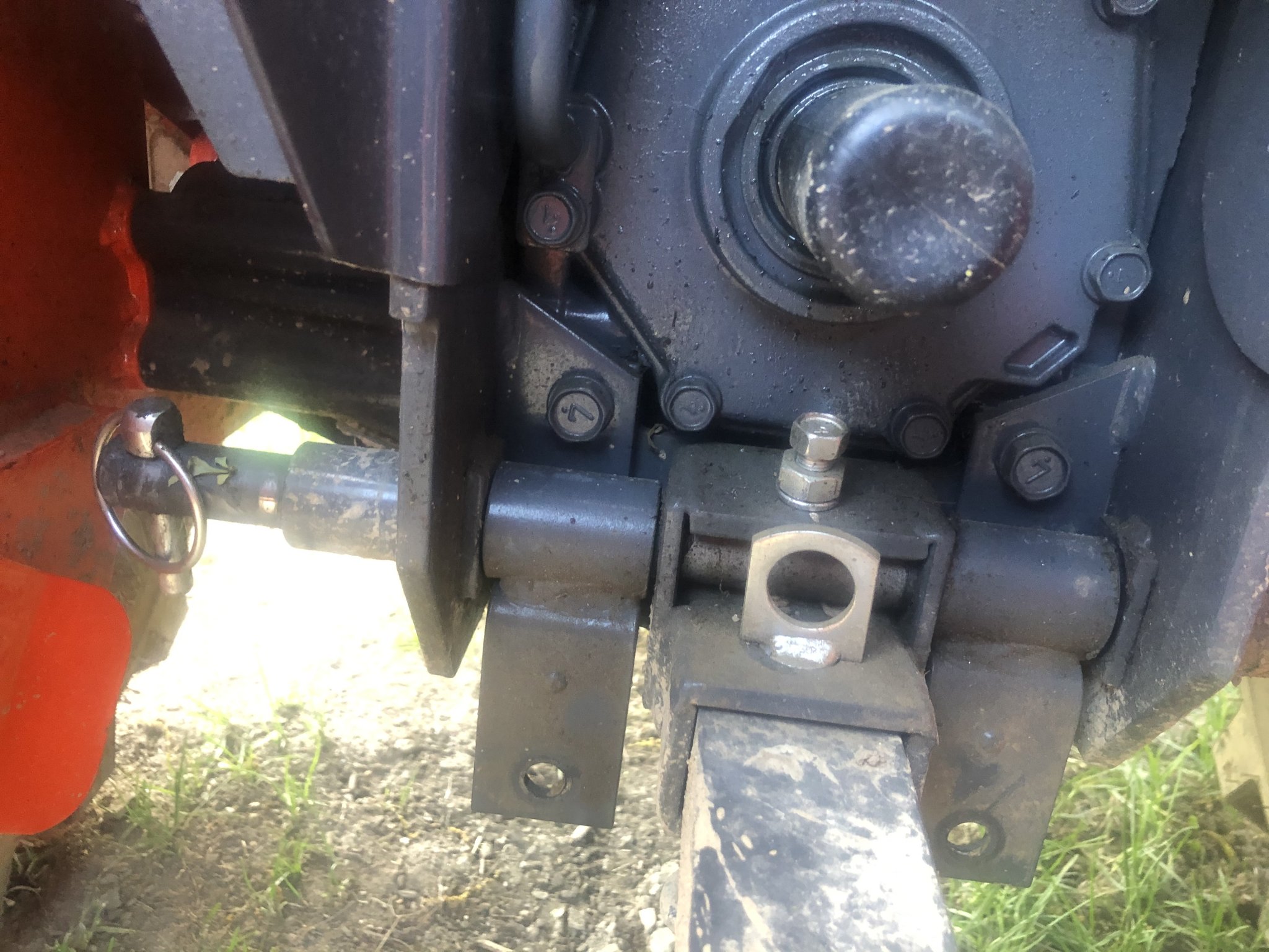

Since you mentioned you bumped the ROPS driving forward, while you still have the tractor, might wanna look underneath the housing at the bottom 2 bolts location like shown in post 12 middle picture of the link i posted (post 8), for cracks in the housing. If your's is cracked like that one, helicoils in the top holes and new bolts is not the fix!

Thanks. Yeah, I don't see anything obvious. Hopefully the service guys will give it a good once over up on a lift.

The bolts in question are used when the tractor does not have ROPS. When the ROPS is added, the original bolts are too short due to the thickness of the ROPS.
The ROPS installation instructions very clearly show what length of bolt is to be used in each location. All one has to do is read the instructions. If the correct bolts are not installed, when you are done assembling the tractor you have 4 new bolts left over. Common sense tells you to go back through the instructions and see where that length of bolt is used.
Here are the Installation Instructions.
Your dealer needs to step up and replace the rear differential housing, I doubt he wants the liability of cobbling the ROPS mounting hardware with Helicoil or such. It's kind of a safety situation.

My guess is you are probably fine, but if it were me I would be troubled by the bolts that I found, which would indicate that the housing threads were partially stripped out.
So what I would do is contact Kabota, explain what happened, and ask them if they still stand behind the integrity of the ROPS, seeing that due to the improper shorter bolts being used the housing was damaged.
I’m with Whitetiger...the housing should probably be replaced to ensure structural integrity should a worst case event happen.
Not sure I would be happy with that solution either though.
6,237
4,816

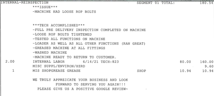

So I finally got the dealer to send over the service report. The language in it was very vague.
I was never charged anything and I think this is just how they recorded the work.
Anyway from what I can tell from our discussions, the bolts installed were the wrong bolts for the ROPS model. When I banged the ROPS into the top of the garage the smaller bolts did not have enough hold and stripped out the threads they were installed into. I received the tractor back with the larger bolts installed (based on color). I would hope that they repaired the threads in some way. I am worried they just screwed the longer bolts into the damaged holes. Anyway, I voiced my concerns to the dealer via email. I will see what they come back with.
It's a good machine and has been doing good work for me. I just want the tractor's ROPS up to spec.
Edit... Just got word back from the service dept.
They said they rethreaded the holes of the bolts that came out. So I guess I am all good.

They “rethreaded” the holes. WTH does that mean. They gave you lip service, man.
how much longer are the correct bolts than the wrong ones? That’s probably how much thread is actually securing those fasteners now.
But hey, at least they washed it for you:giggle:
