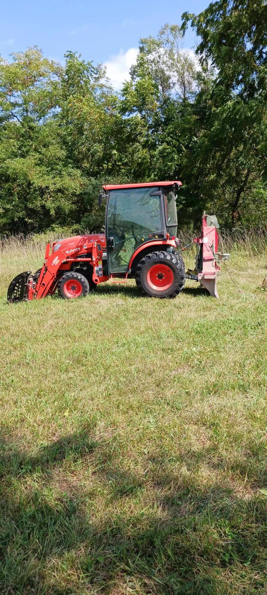

Have an LX2610 and am looking at getting a forestry winch. Found a Wallenstein FX90 local for a decent price but is it too much for this tractor?
The FX90 is listed as for 30-80 horsepower and the LX is a few horse below that. Any members have experience with skidding winch setups and if
used with a little common sense would the wallenstein work? Not going to be a huge logging operation just a clean up on a 10 acre spot that
getting trees out will be tough to access with just the tractor.

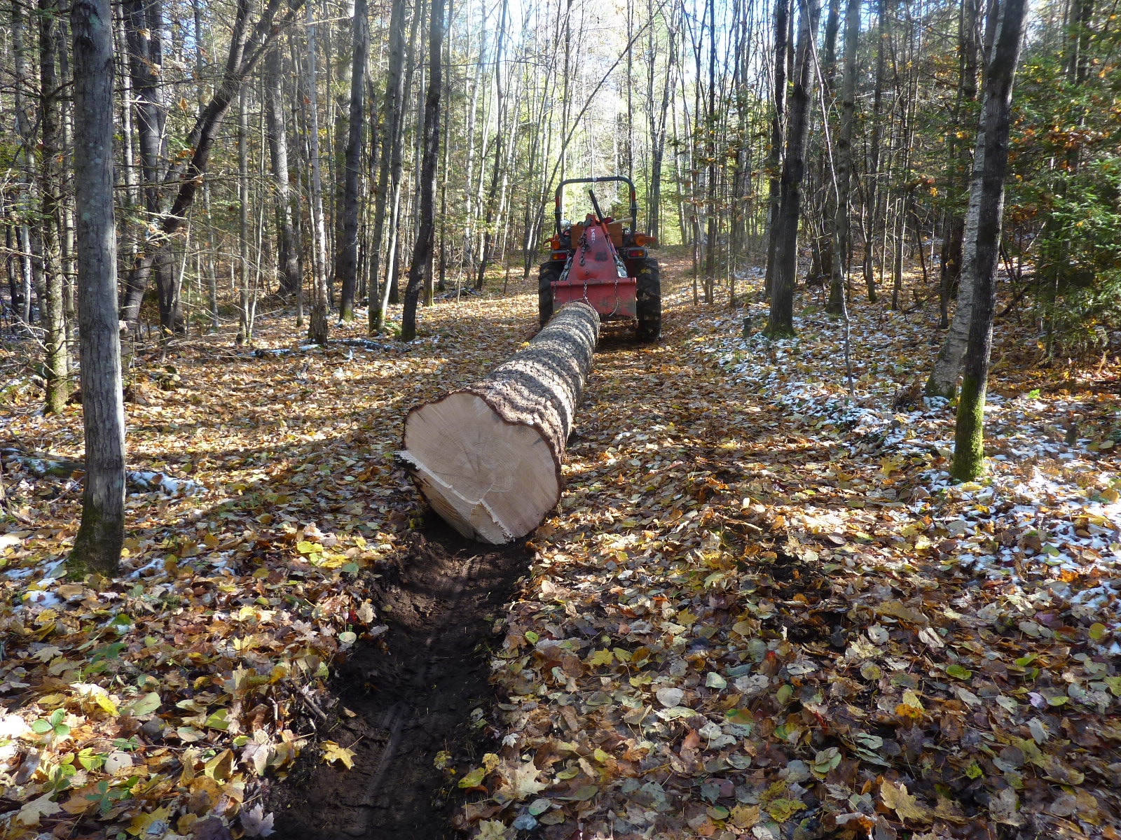

I have a Uniforest 30 M skidding winch on my B3200. It's done anything I've asked of it, big Maples and Ash no problem. It's got 26HP at the PTO and never any issues.
No problems with the lift arms, just a bit tight getting in to connect the drive shaft.

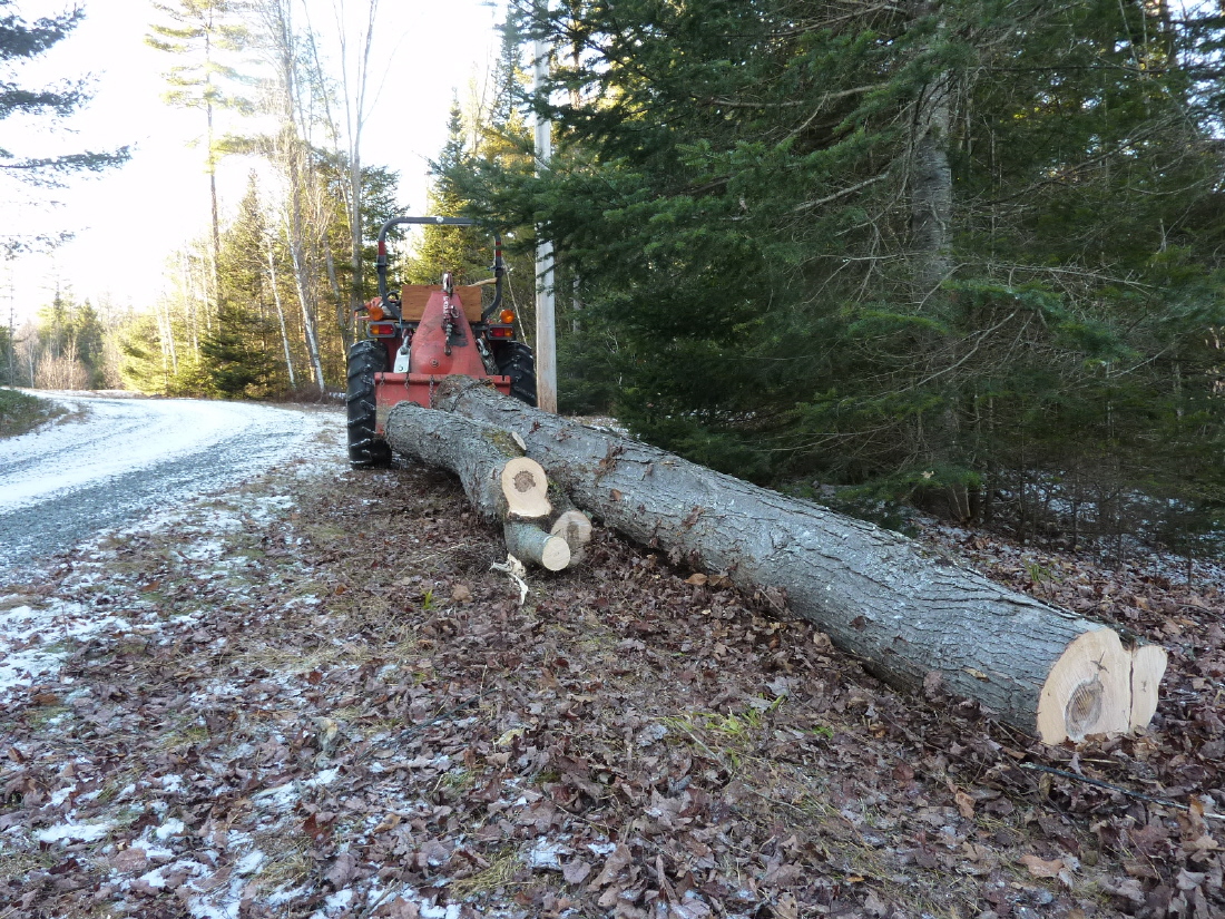

I have a Farmi JL290 winch on my L3010. So a 6600 lb winch on a 30 hp tractor with loaded rear tires that weighs 5000 lbs. Believe me that is plenty of winch and is sized right for the tractor.
I important thing to remember is it is the tractor torque that determines what you can pull. If I put a 8K or 10K winch on that tractor I could not pull more. Actually, because big winches are geared higher I would get less pull with a bigger winch.

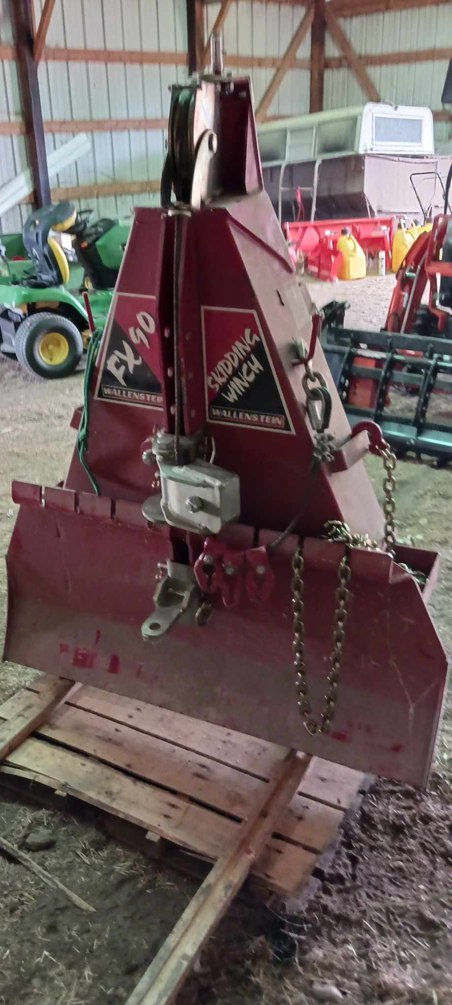

Decided to give it a try anyway. Will get some pics when I get it cleaned up and operating.

If the winch can fit on the tractor and the 3 pt can lift it, you "can" use it. You will have to limit what you do with it to the capabilities of the tractor, both the size of logs and the terrain you are on, because the winch is scaled for a larger tractor. You have more winch than you have tractor... it would be safer if it were the other way, so it's on you to be careful.
10,304
4,289
Odds are it'll stall out the tractor and no damage will be done or it may just happily pull real heavy logs, just slower than 'normal'.

Couldn't pass it up for the price and the fact it was only an hour and a half away. No plans for pulling big logs, this is to pull out mostly 6 to 10 inch honey locust from a part of the farm I can't use the tractor in because of the slope. Worst case it doesn't work and I sell it,
