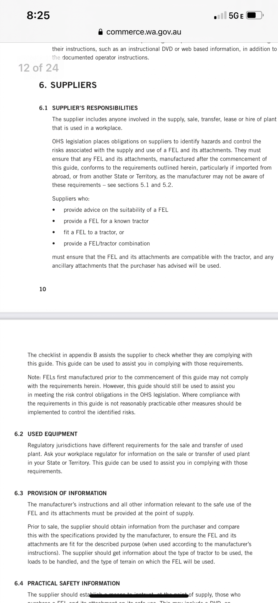

The dealer referred me to a Work Cover document (linked below), however as far as I can see it does not say a counterweight must be provided - "Counterweights or ballasting may be required to improve stability. "
https://www.commerce.wa.gov.au/sites/default/files/atoms/files/front_end_loaders_on_tractors.pdf
He's standing by the fact that Kubota deliver the backhoe kit with the counterweight, so there is no choice. However, I've found the counterweight is provided by a third party (Burder), not Kubota.

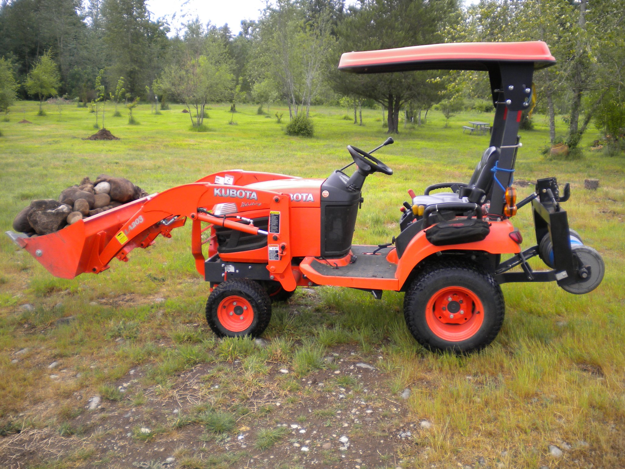

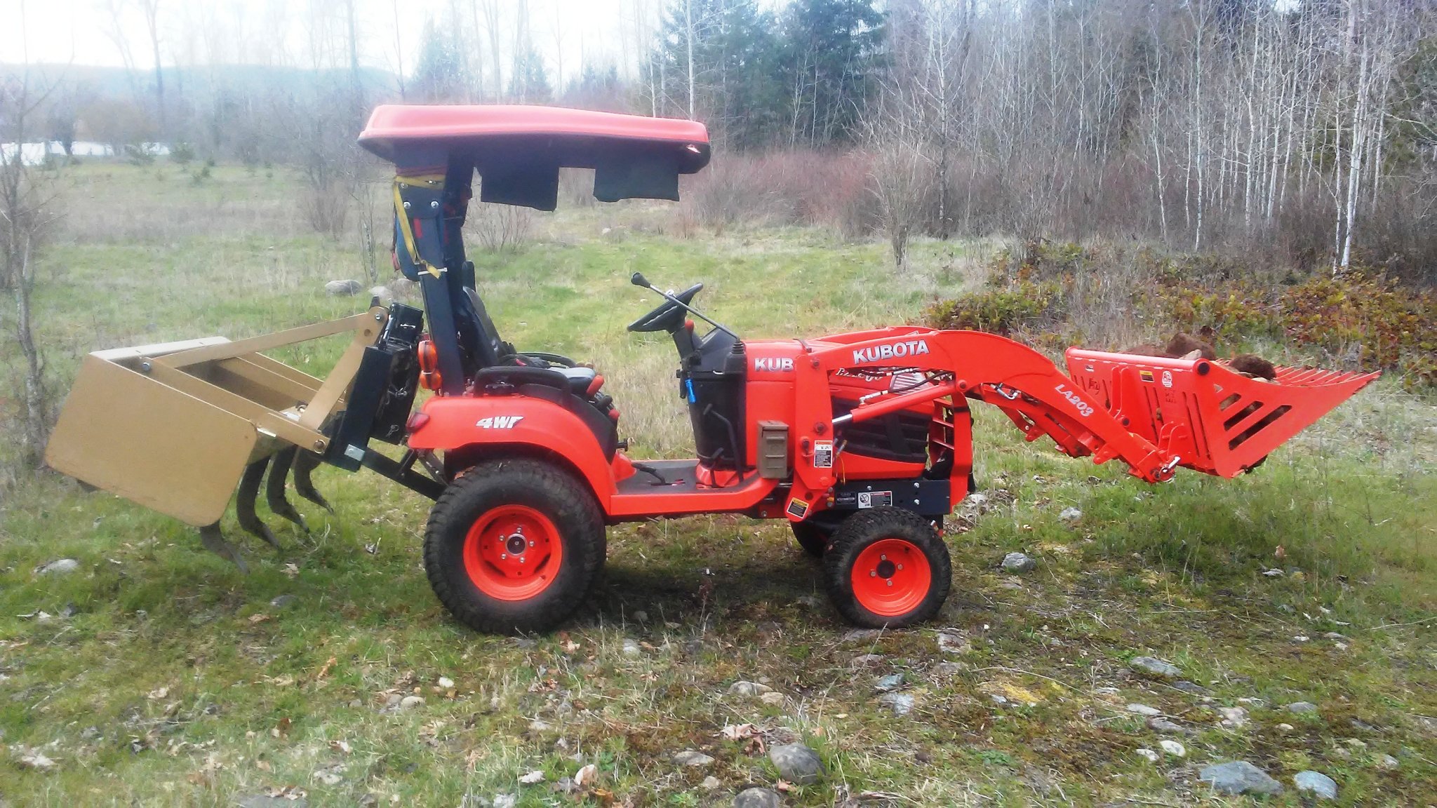

Then I have one more suggestion for you. Tell the dealer that you plan to use a counter weight of your own and that you don't want to buy theirs because you already have counter weights. You could mention that you have barbell weights or a box blade, like what I have on mine. Pictures attached.
I would add one more suggestion. Tell the dealer that you will buy from the the other dealer, who is not requiring that you purchase the counterweight, since you are keeping the backhoe on all the time. Great incentive for the dealer to become reasonable.
Then be sure to buy a box blade or something else to use as a counter weight when the backhoe is off the tractor, and load the rear tires as well...
