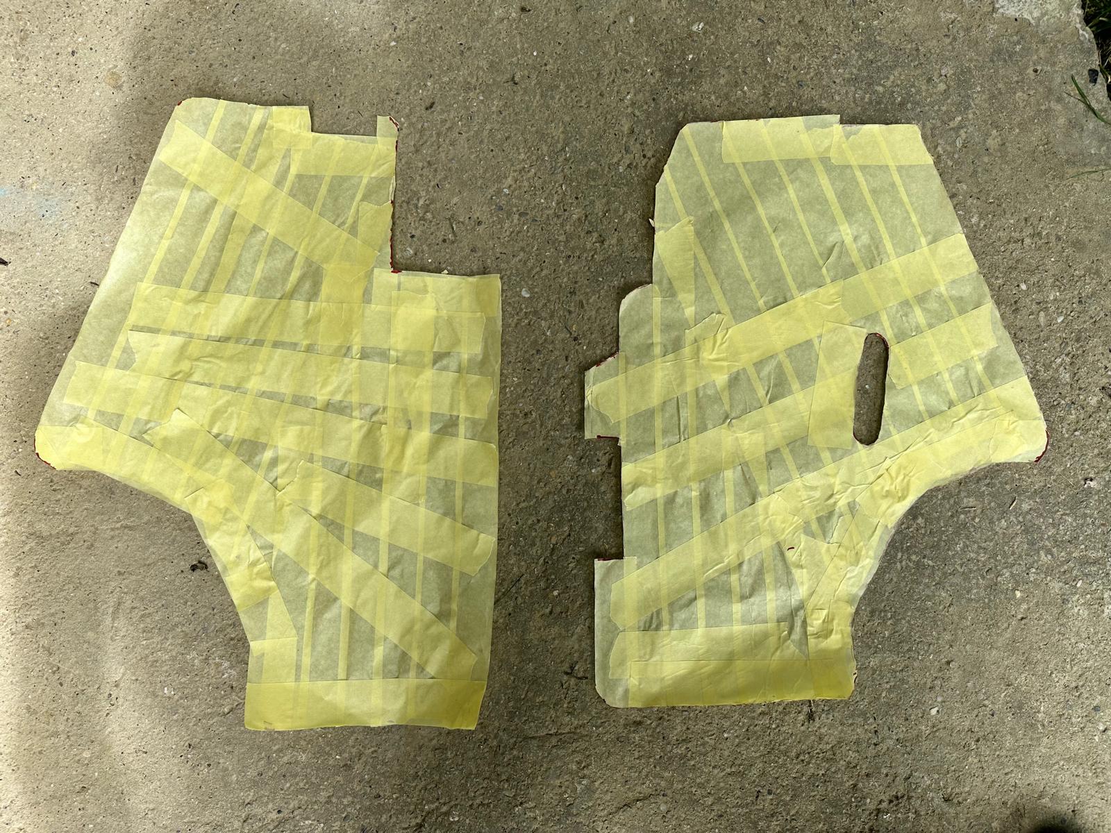

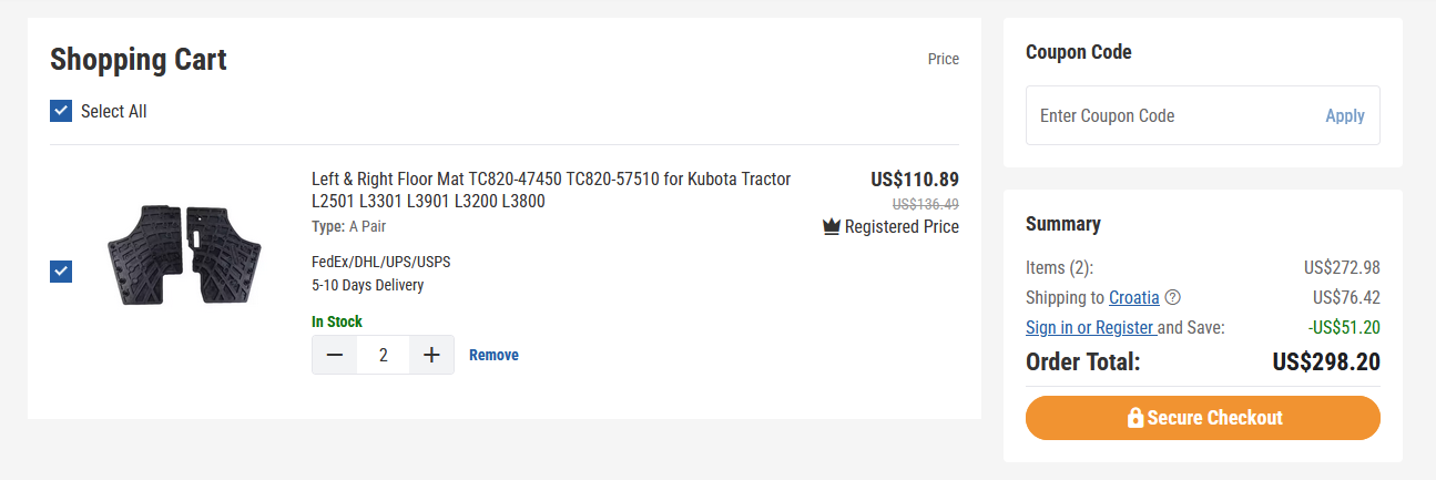

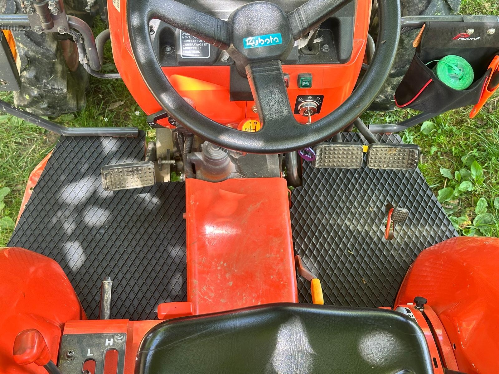

Hi all, I just wanted to show a small project. Since L series ( at least in EU) come with no mats, you end up with paint being brushed of pretty quickly. I cant get these mats here, and if were to get them from the USA, see how much they would cost me attached. Crazy. So I decided to make my own. DIY version cost me $10. I will post a few pics of how I did it so someone else might make their own too.

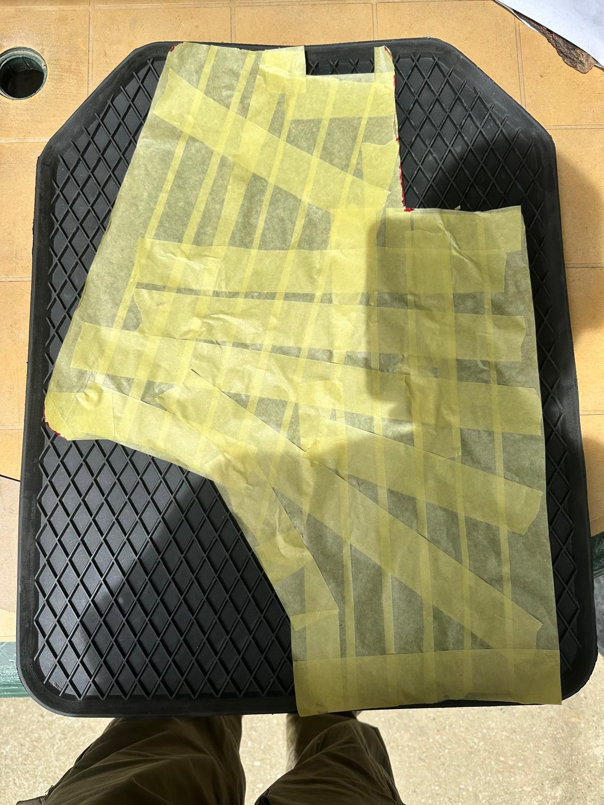

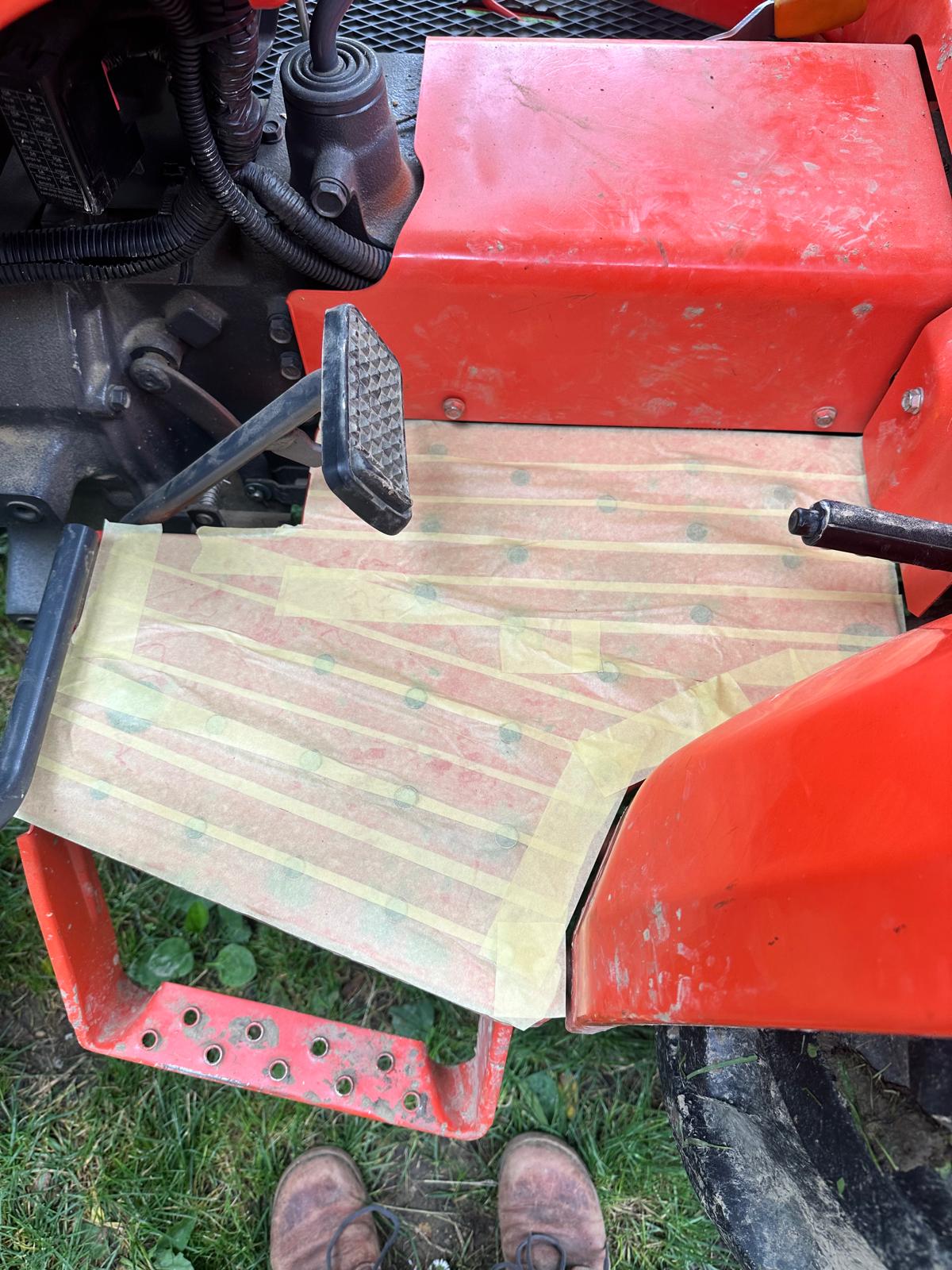

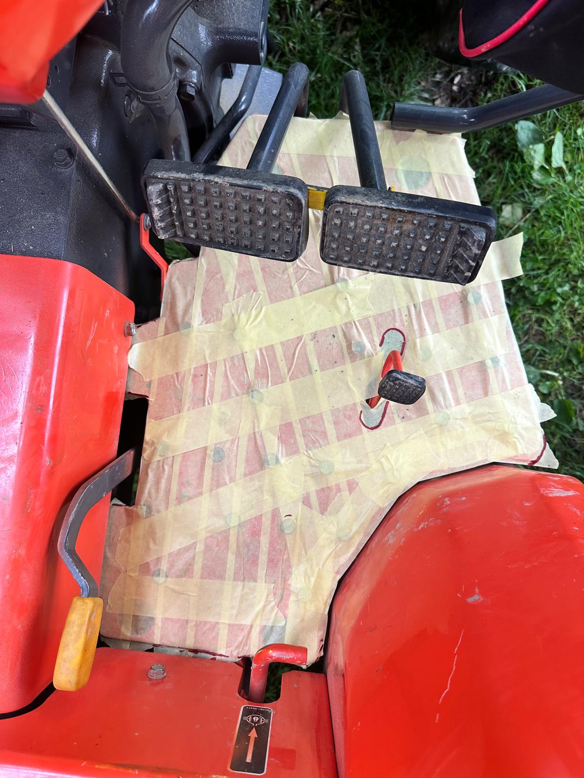

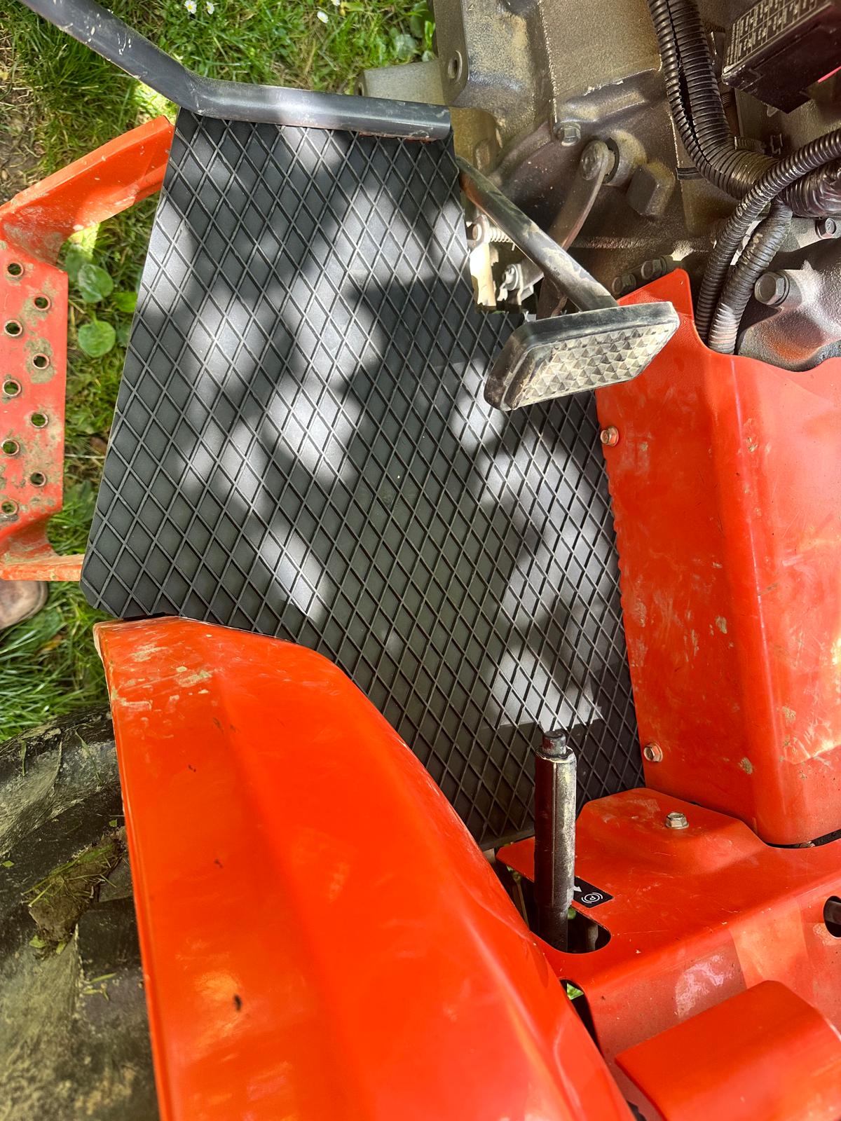

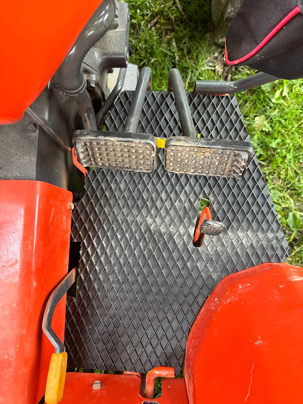

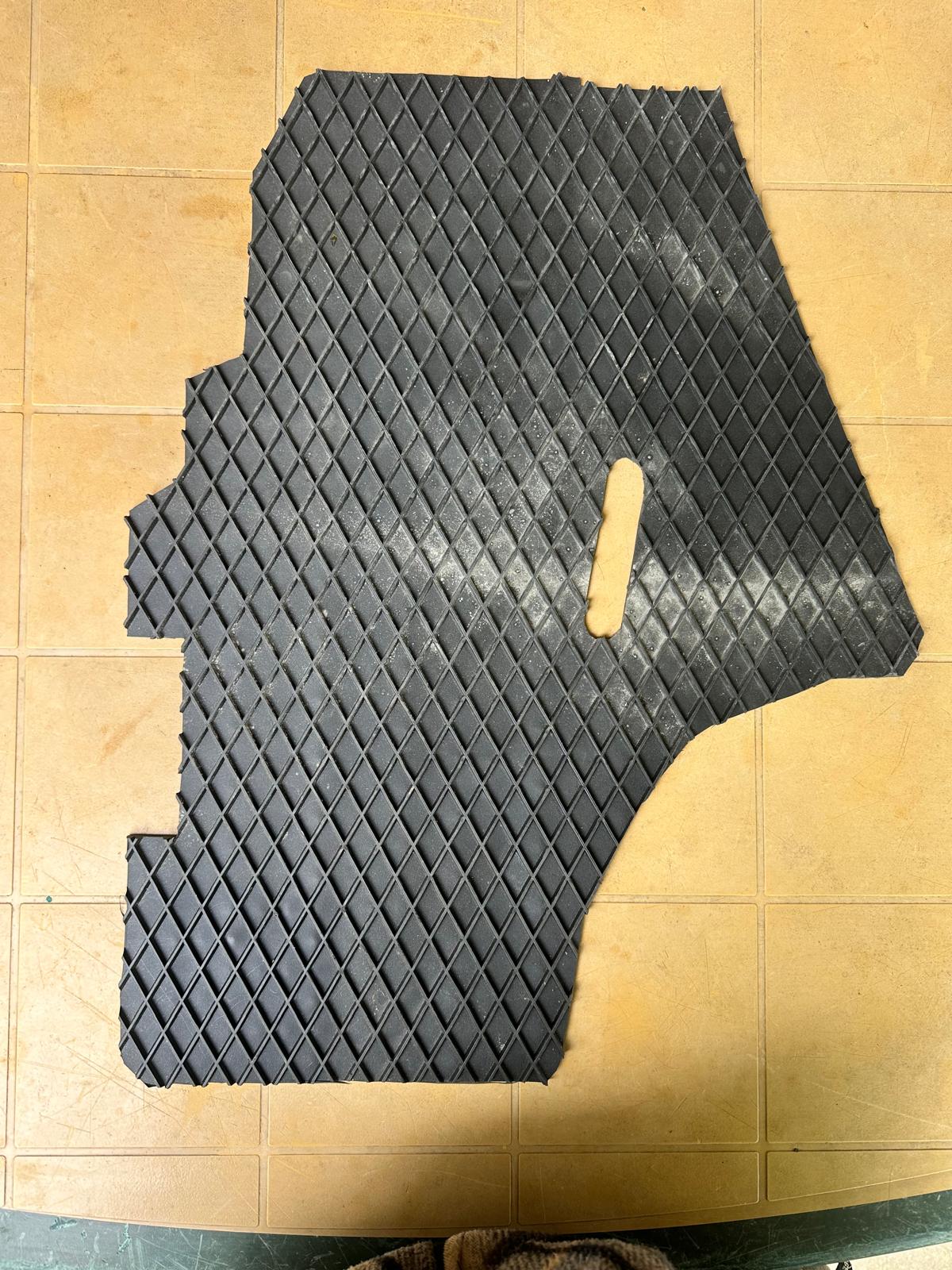

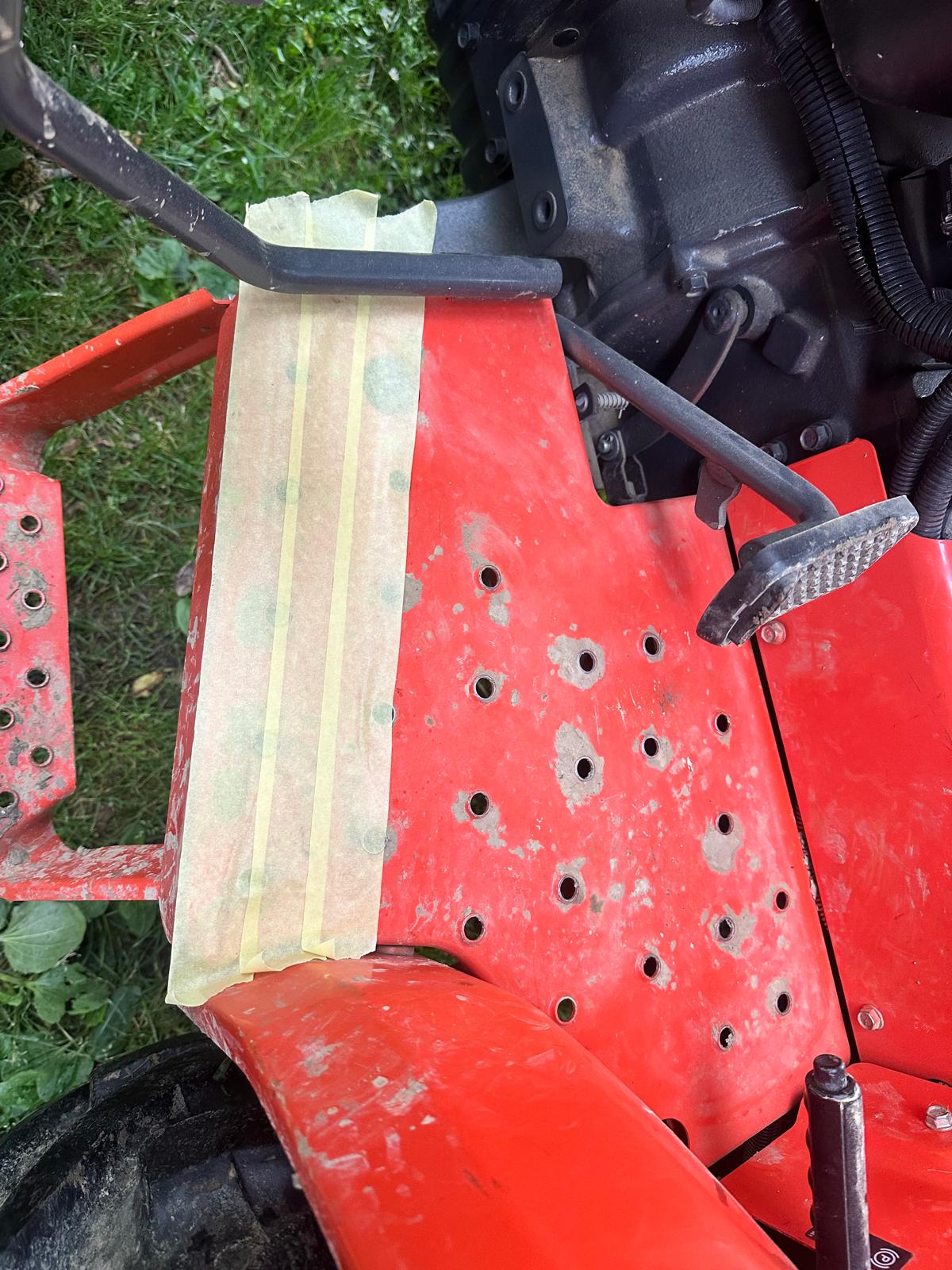

So, I bought simple cheap car mats, made some templates using paper tape and used scalpel to cut them. They fit perfectly and it is easy to make them again once they wear out.

Well done sir!
I like your ingenuity.
