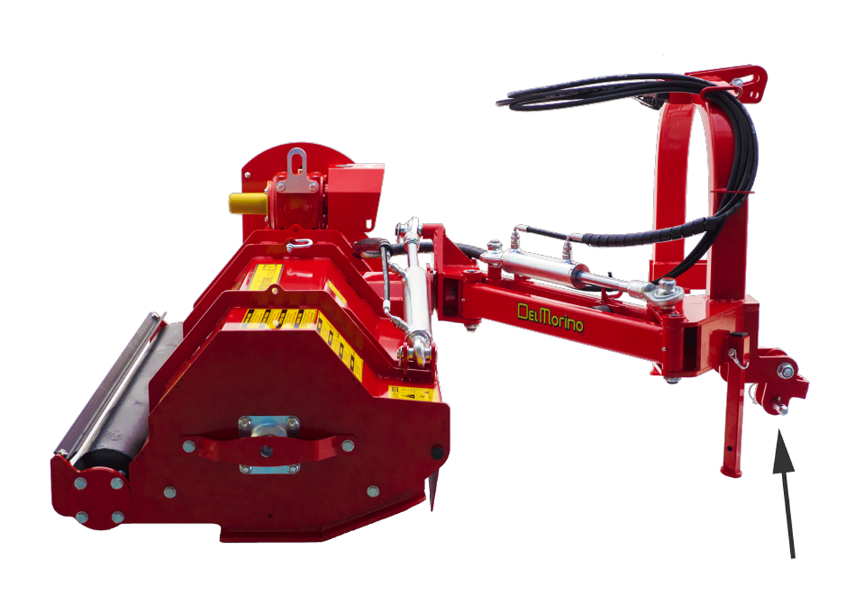

I'm running a Del Morino Centurion Super 158 behind the MX6000 with no issues at all in terms of the size or weight of the mower. There's a learning curve and I'm still running it less than optimally, but the tractor easily handles the 820lb weight. I actually wish this mower was available in a wider model.
I'm not sure of the intended design purpose for the articulating lift arm connection point (see arrows below) but I find it annoying since it allows the mower cutting head to move out of perpendicular relative to the direction of travel of the tractor. I'm probably doing something wrong when dragging the cutter over the grass so if anyone has any thoughts I'm all ears.
