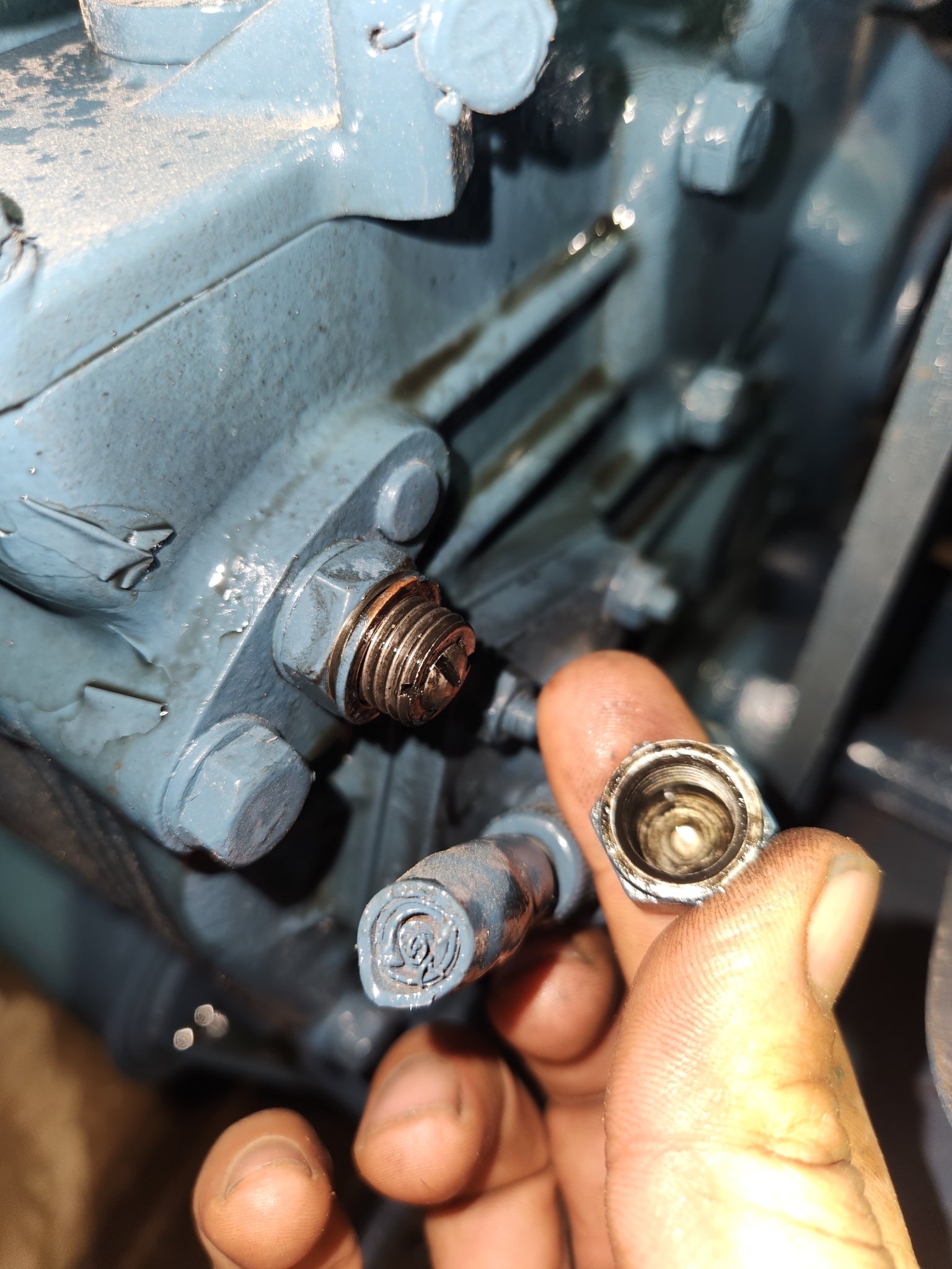

Adjusting idle, still need to fix leaks
Video before adjusting bolt: notice the see saw, I try show you leaks, I show high oil pressure
I am adjusting this until seesaw gone
Here's where i got it after one adjustment, screw it in more and see how she idle
I do not think it is governor springs
Also: jb weld to fix exhaust leak did not work
need a comprehensive plan to fix leaks: take off head, perfectly bind the head to the flange, put in gasket on governor lid, and maybe injection pump leaking
Now: keep adjusting idle until stable
Rotated adjustment clockwise until tractor would no longer turn on, then backed it off a half spin
It is the smoothest I can get it, the seesaw has to be the springs
Springs will be here in couple days, when springs show up, that's when I get in there and fix all leaks with intent
I tell you what it need: take it all apart, clean everything, professionally and comprehensively reassemble perfectly
I point to a crack in the water flange, not related to my reassembly
Study entire area, find every leak, then take it apart, don't take it apart yet

You can stop the exhaust leak by putting a small amount of red RTV on both sides of the gasket. That's what I did years ago and still no leaks.
Also I might be wrong, but I think the nut you took off is where you adjust the "slop" in the steering box.

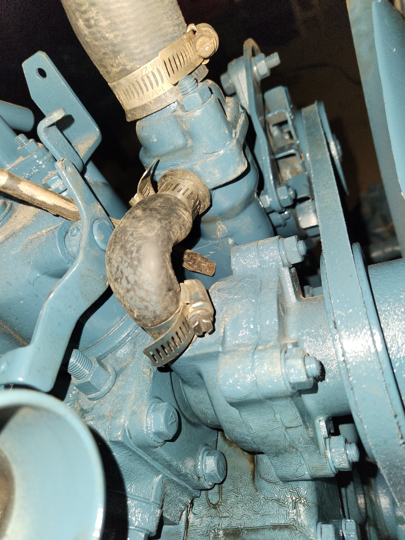

In depth plan on fixing all leak
The water leak coming from gasket is not as bad as the water leak in the cracked flange that attaches to head
Previous post I show picture pointing to water leak
List of all leak: governor cubby holes I did not put gasket yet until I put new springs, should be here Friday
Jb weld on exhaust leak: no joke, it is holding better than anticipated, only tiny bit of leak on bottom of exhaust connection where i did not put enough jb weld, unbelievable
Water leaks: head connecting to flange, underneath water pump, and the crack in the housing itself that connects to the head
Also, there could be leaks in the gearcase, can someone recommend a torque for those bolts?
I will comprehensively go and torque all bolts during this rebuild

Yes, I come up with expermental plan to fix all leak, and NOT take head off, I narrate:

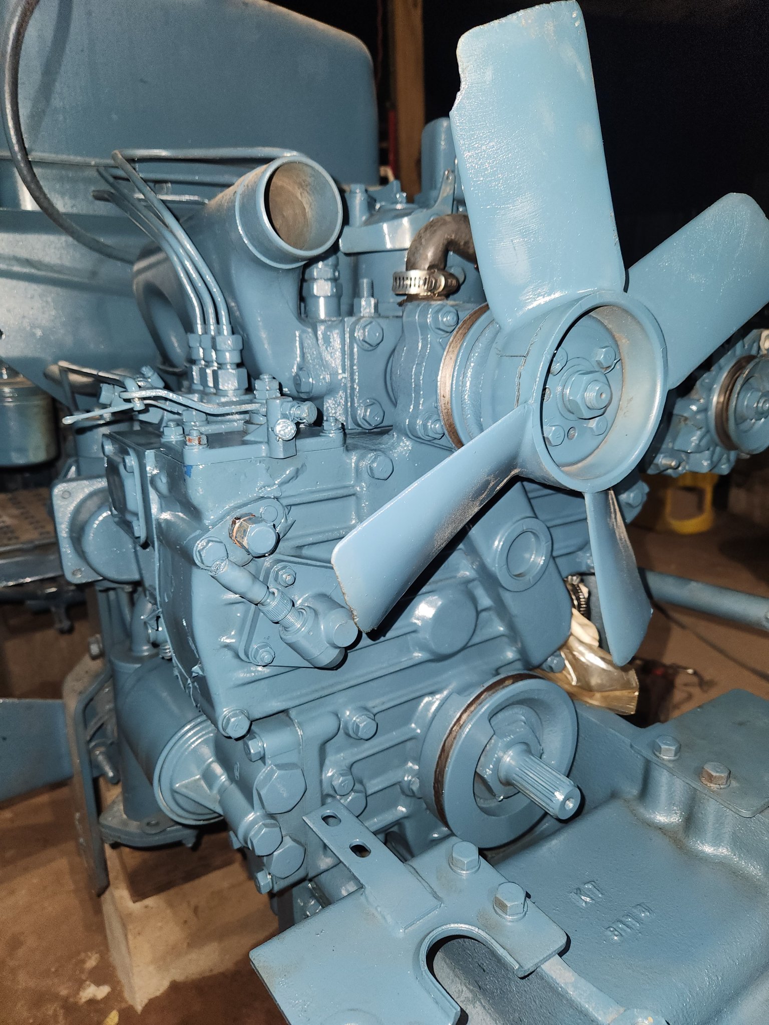

Take radiator off, now you are facing gear case and can access all leaks
The oil leaks: they will be gone since I have not yet put in the gasket and fastened bolts
Water leaks: Plug the bottom port going to radiator, then fill up engine with some water and it cannot escape since port is facing up
When engine get up to temp, you can see the leaks clearly now
Experiment: Can jb weld fix leak if applied generously?
big water leak is not in the gaskets that I installed, those are tiny, the big water leak is in the cracked flange from the head going to radiator
Summary: take off radiator, plug bottom water port, pour water into engine, get it up to temp, mark all leak, then use jb weld on brush and put aggressively over the leaks

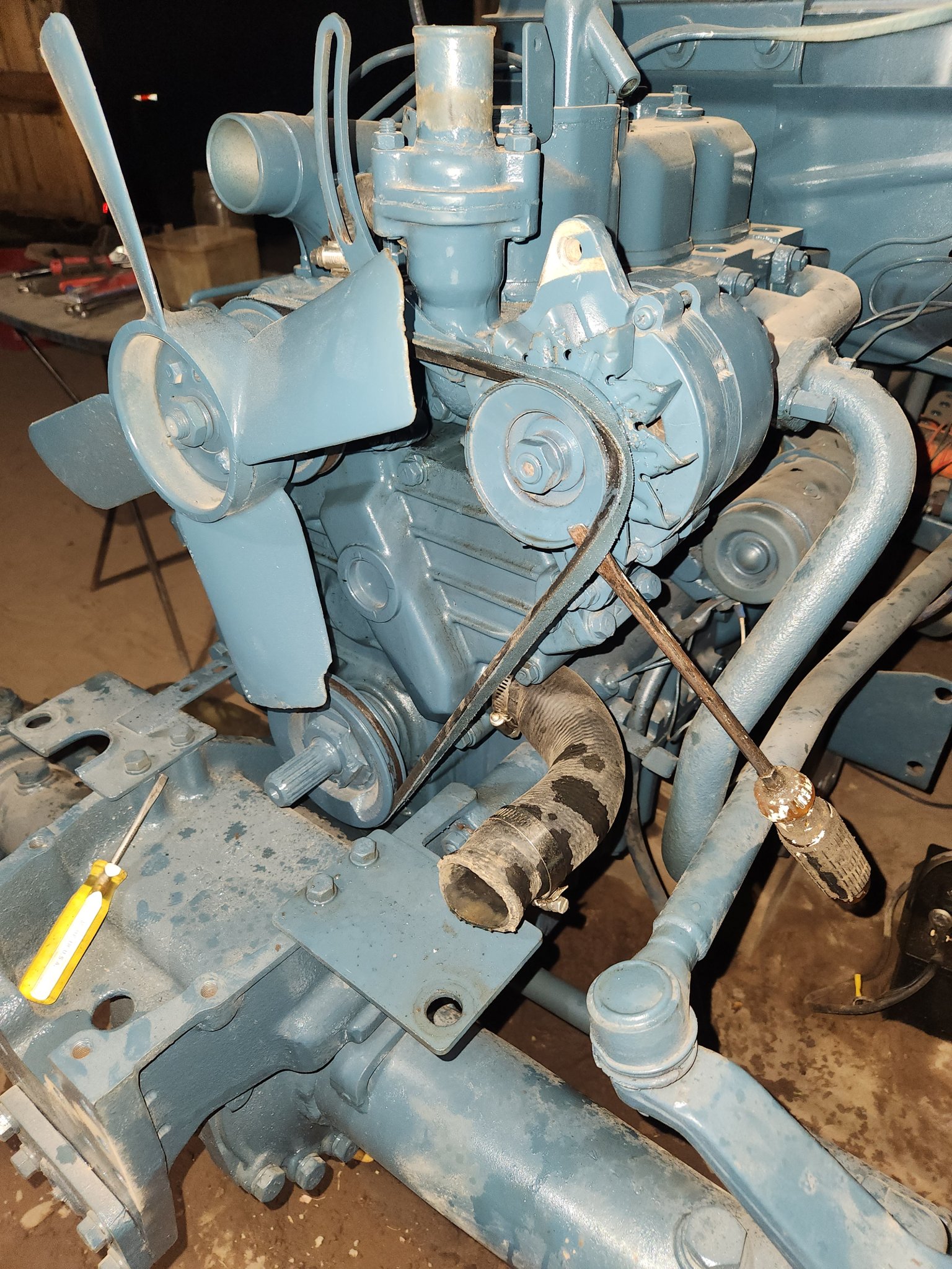

Remove radiator, cannot get belt off, bring brush and apply some diesel, hit belt lightly with torch
basic tool required, notice the gasket maker, experiment with that
took off belt, clean with part cleaner, hit with compressed air

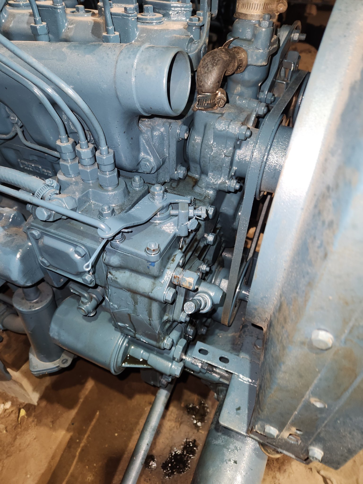

now: fill with water, get engine running, look for all leak
Governor leak, water leak not showing, system need to be pressurized
Plan: fix all leak visible, then figure out cap to seal water in engine and see if it leaks

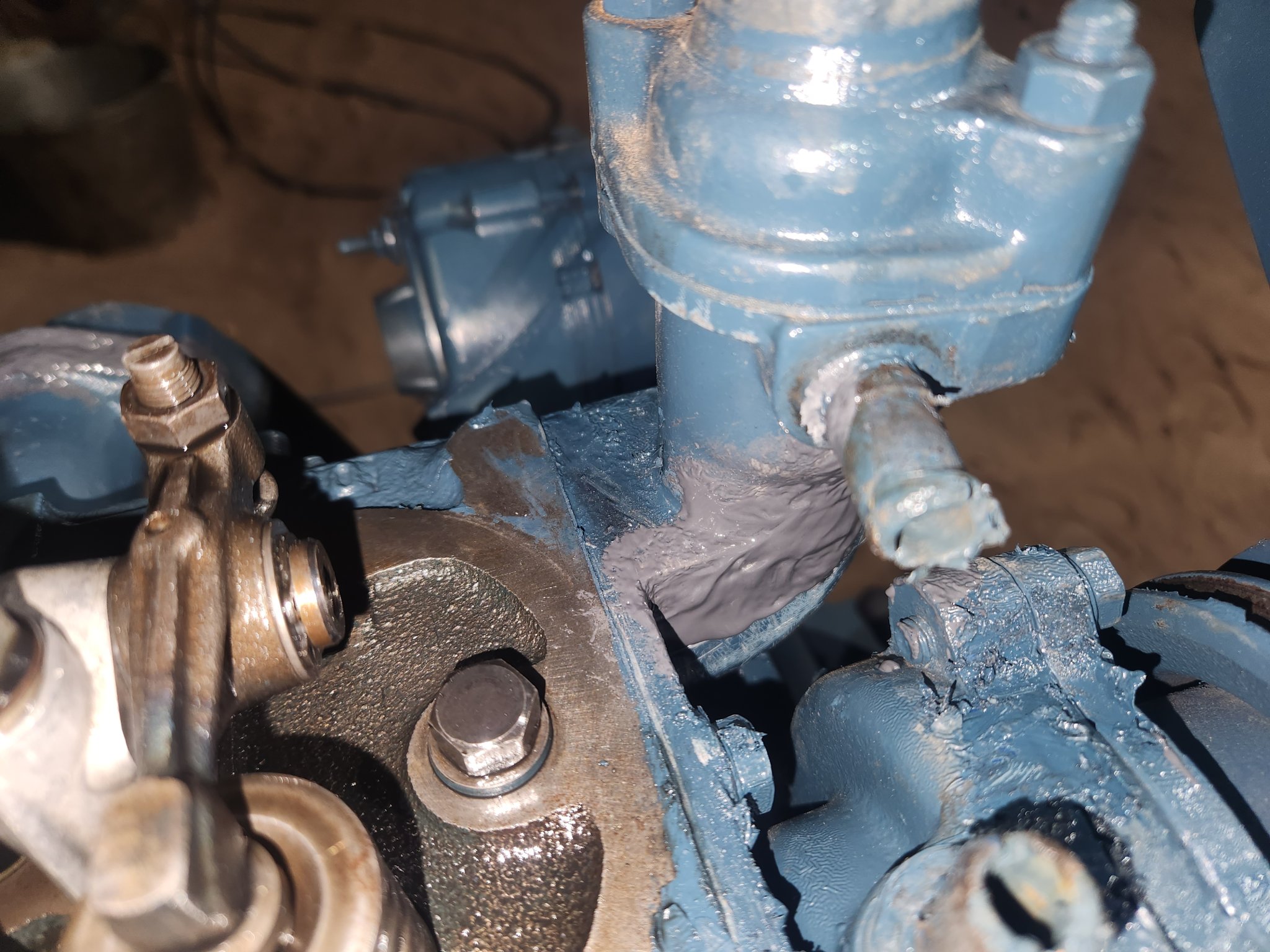

Now: clean areas, prepare jb weld with clean brush, apply to areas, might sacrifice governor gasket for purpose of eliminating all leak

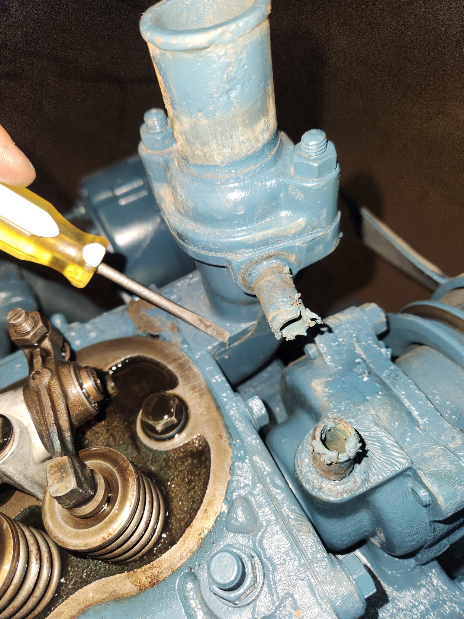

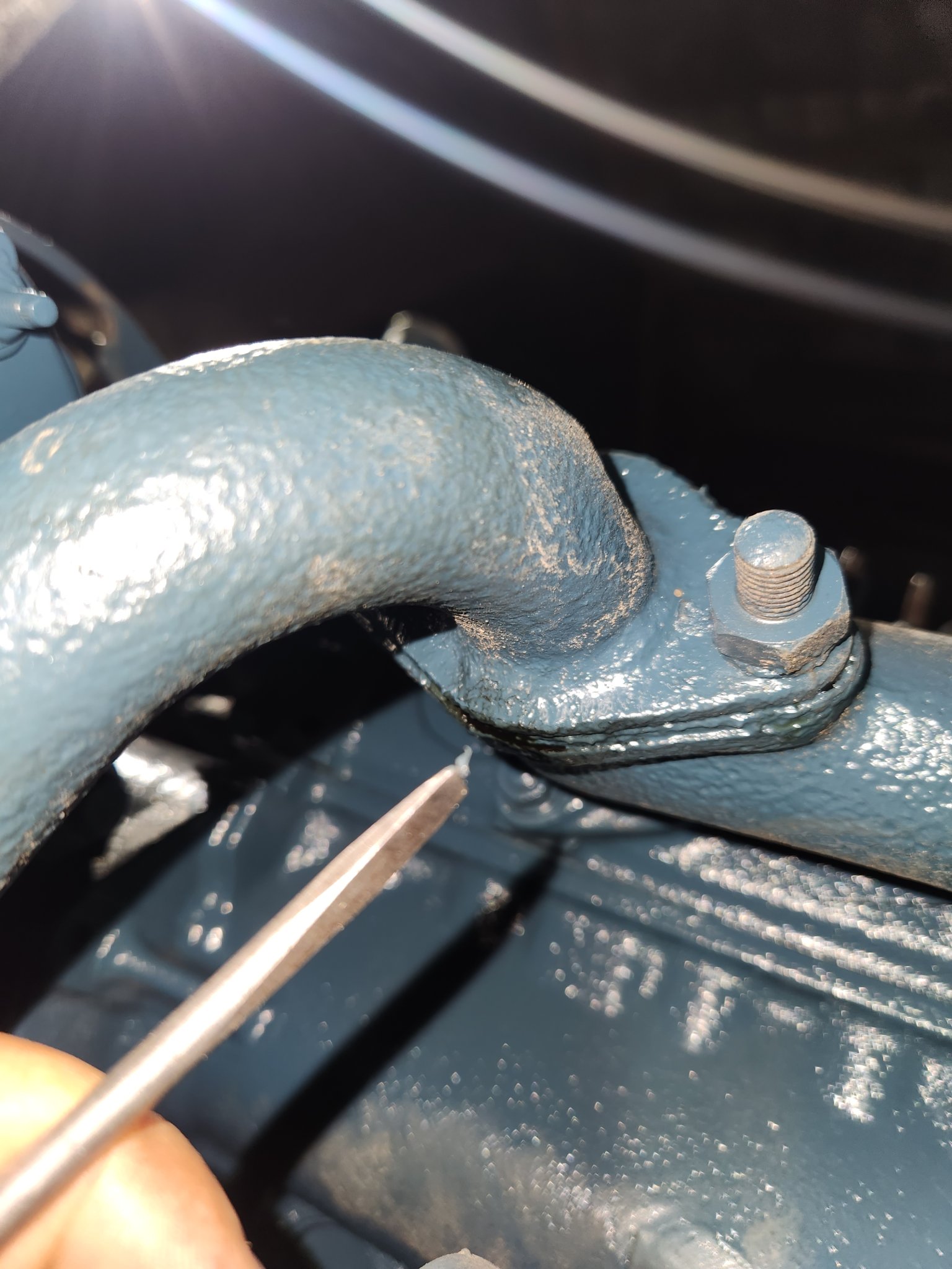

This is the leak I think causing the big mess, a crack in flange

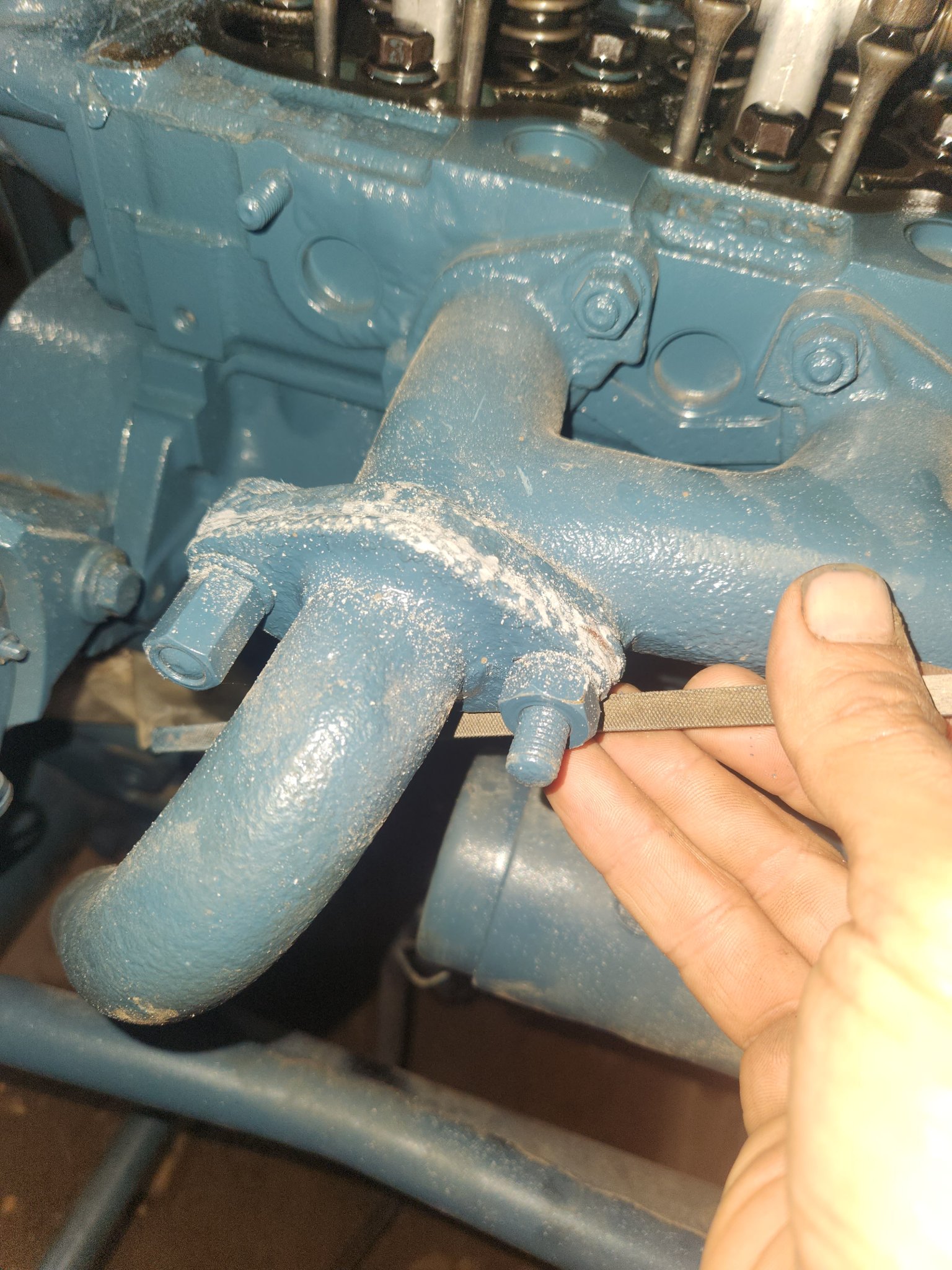

Exhaust leak underside of manifold
Put big glob jb weld on both, sacrifice 2 gaskets on governor and cubby hole for purpose of seeing if injection pump is leaking
File areas getting jb weld, clean them, glob on using small brush

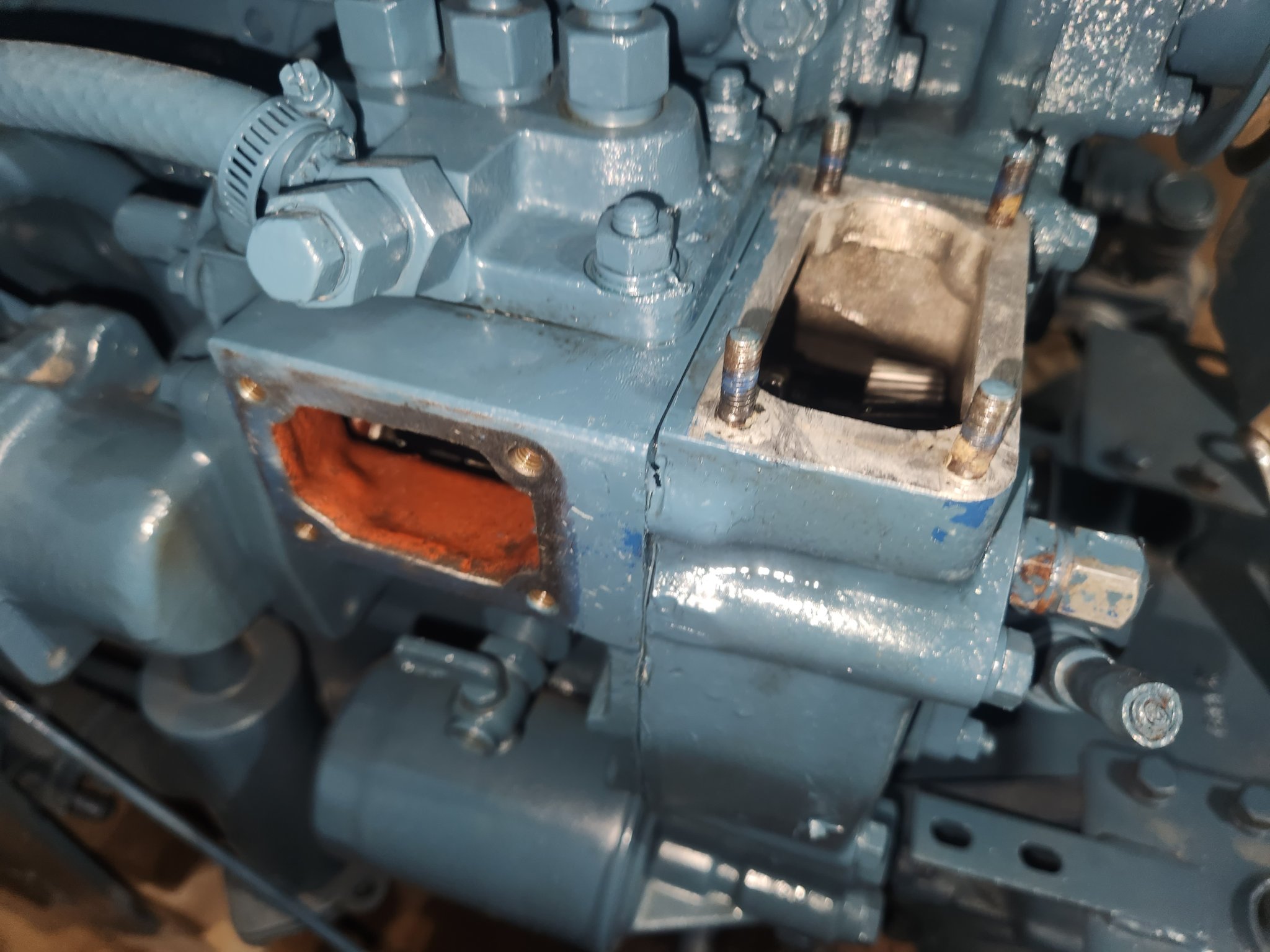

Globbed on jb weld on two leaks, now: take out cubby hole then governor spring, sacrifice two gasket
File coupling areas, hit with air, then wipe with solvent, get new gasket
