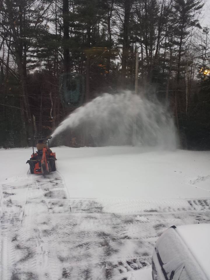

Regarding ice/crunchy snow - We got about 3 inches of sleet here in NH the other day and when you walked on it you did not even leave footprints. The ATV and plow blade simply went up on top of it. Trying to shovel it you had to dig into it and scrape and then lift it and it was HEAVY. So I decided to use the snow blower for the first time. I put the snow blower in float mode and even the snow blower went on top of it and did not move it. Had to take it out of float and use the entire weight of the tractor to bite into this stuff to finally get the snow blower to clear it. I learned that some snow has to be done SLOWLY otherwise to much weight is put into the second stage and SNAP goes the shear bolt. Unfortunately I did not have any extra bolts and had to guess at how strong the bolts were that I had and limped along clearing the rest of the driveway. Since then I have learned a lot about bolts used for shear protection (see my post 'Everything you need to know about SHEAR BOLTS').
Suffice it to say, whatever gets moved by the augers into the fan will be processed (i.e. chunks of ice, heavy snow, etc...). I have attached a picture of the snow blower through the heave sleet.
