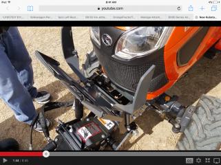

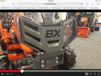

Yes, the BX80 has a swing away guard and one piece hood. I've found if you use the supplied holder and do it a few times taking it all apart isn't that hard and I often don't do it for a simple service.

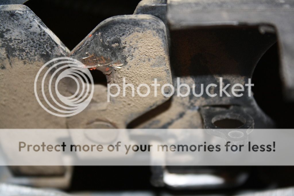

It is a bit of a pain, but note that they do provide that third hand you need: somewhere near the top of the radiator is a sliding tab with a hole in it. Pull that tab out and put the pin on the hood through the hole. This holds the hood in the partially open position that allows you to slide the sides/skirts forward.
Here's a picture I found (not mine) showing how it works:

Ah yes, the pull-out hood holder tab. I forgot about that. Would have nice if Kubota put a little "warning sticker" on the inside of the hood to remind us.

I am not saying I was right, but I just had this go around with another member said that $1500.00 more for 80 to the 70 with the one piece hood, remove loader and resinstall loader from your seat, joystick at your hip and the SSL style quick detach bucket was not worth it.
And the grill guard would be further out to clear the hood or it maybe a tilt out, but yes.

Is the "grill guard" now the "grill"?
It looks sort like the hood just tilts open "over" the guard. But it's difficult to tell from the picture.
