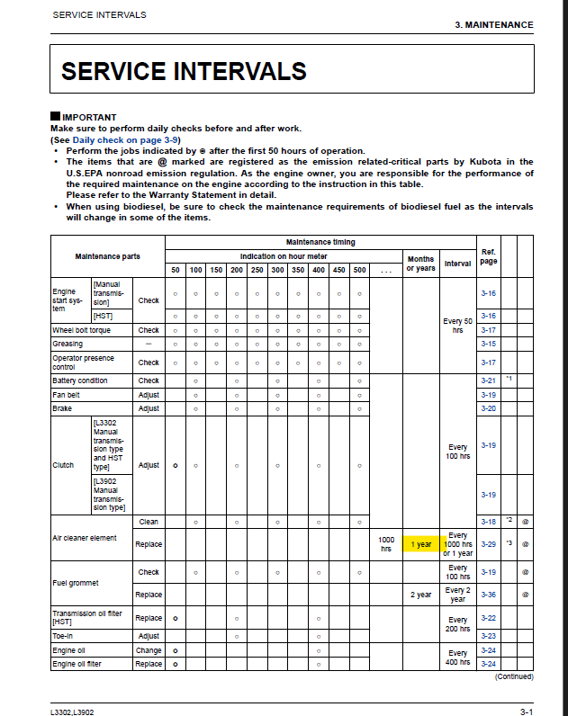

I saw and understand that your tractor has less than 50 hours on it in the first year.
Maybe you should read the replies fully, there are YEARLY items on the maintenance list which have no connection to the hour meter reading, and your dealer can not modify the Kubota warranty.

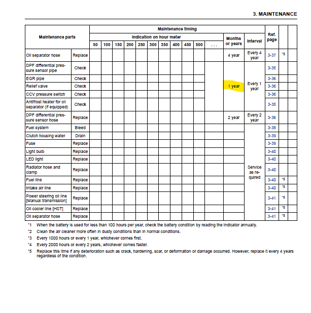

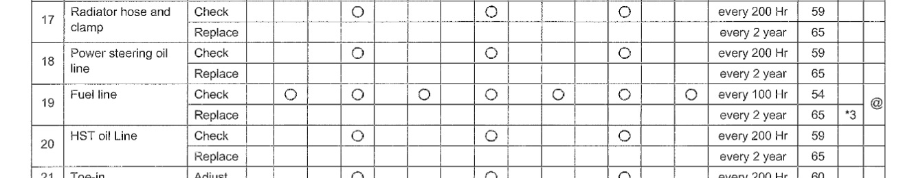

So have you replaced your radiator hose every 2 years? Don't forget your clamps, too, and have you replaced your Power steering oil line every 2 years... How about replacing your Fuel line and HST oil line every two year??? THAT IS THE ONLY ONES I SEE NEEDING TO BE REPLACED ON A BI-YEARLY schedule...

You can not base your facts off of a 30 year old manual for your tractor, you need to base it off of the manual for a NEW 3302 which the OP has!

Dear “rkh Kubota”… I don’t think anyone failed to read your question completely. I believe it (your original post) was taken to mean that When you reach 50 hrs you have no incentive to perform the 50 hrs service based upon some (questionable) advice given by “somone” at “Kubota”.
I also believe that it’s common for headstrong and confident participants to get “uppity” with other participants due to a certain level of anonymity that prevails behind a username and a keyboard.
Although it might have appeared to be so, … I’m certain that no one offering advice to you intended to insult your intelligence or to demean your advisor at Kubota.
I believe that your original post gave concern to those of us who have already seen, heard, and experienced other participants on these forums who have been denied warranty coverage over having relied upon simple bad advice. We hope to prevent such bad experiences happening to you, especially as a newcomer to the forums.
”Old and tired” may have ”lept to conclusion” assuming we are advising your to perform a 50 hr service prematurely. That is not the way I have read the comments.
And it’s important to note that Wolfman has posted information that shows certain maintenance should be performed on a calendar basis.
While some calendar items are merely a ”check”…. sometimes you’ll see items which appear to be unnecessarily “replaced”. An example is the air filter element to be replaced after one year….clearly a questionable, perhaps unnecessary replacement at only 11 hours operation…. BUT… birds and wasps and vermin often take up residence within un-used or lo—useage equipment and that is good reason to look at that filter and make a decision on it’s condition. (Also, some mx schedules don’t follow their own service-procedures. For example, on many tractors the primary (outer) filter is not actually replaced annually…. it is washed, dried, inspected, and reinstalled.
In such cases it’s wise to inspect and clean if conditions warrant….but most importantly that the owner RECORD the event to document the item was addressed. A permanent Record of Mx performed in accordance with the mfr’s schedule is a valuable asset when warranty service is needed and a service-center is reluctant or accusatory against the owner.
And this brings the conversation full-circle with respect to what most responses have been. We’re simply being protective of you and wanting to instill a sense of self-protection in your attitude toward “recommended maintenance” in the owner‘s manual.
With all due respect to both you and Whitetiger... I think what we have here is failure to communicate...

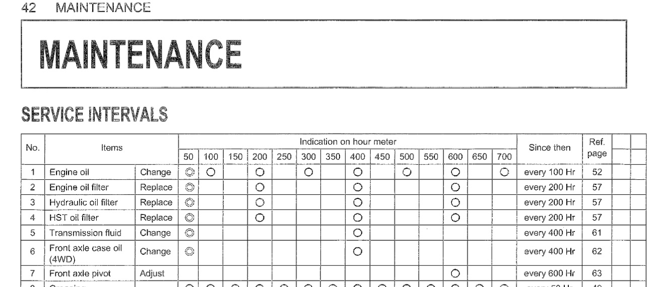

The new manual that you posted, still does not list oil changes based on years, only based on hours of use.
Sure, some parts you highlighted are based on "years". BUT we are talking (or was talking about) the 50 hour service not being done within the first year of service.

So after re-reading the whole thread a few times.... Never did the dealer say that he didn't have to preform the 50 hour service. He only said that since the tractor only had 11 hours of use within the first year of ownership that he can wait until he reaches 50 hours to do the service... (I took the liberty to say what I thought that the dealer most likely meant to tell the OP).
11 hours is, In My Opinion, is way too early to do the "50 hour" service.... I did mine at 40 hours but that took 2 years to reach.
