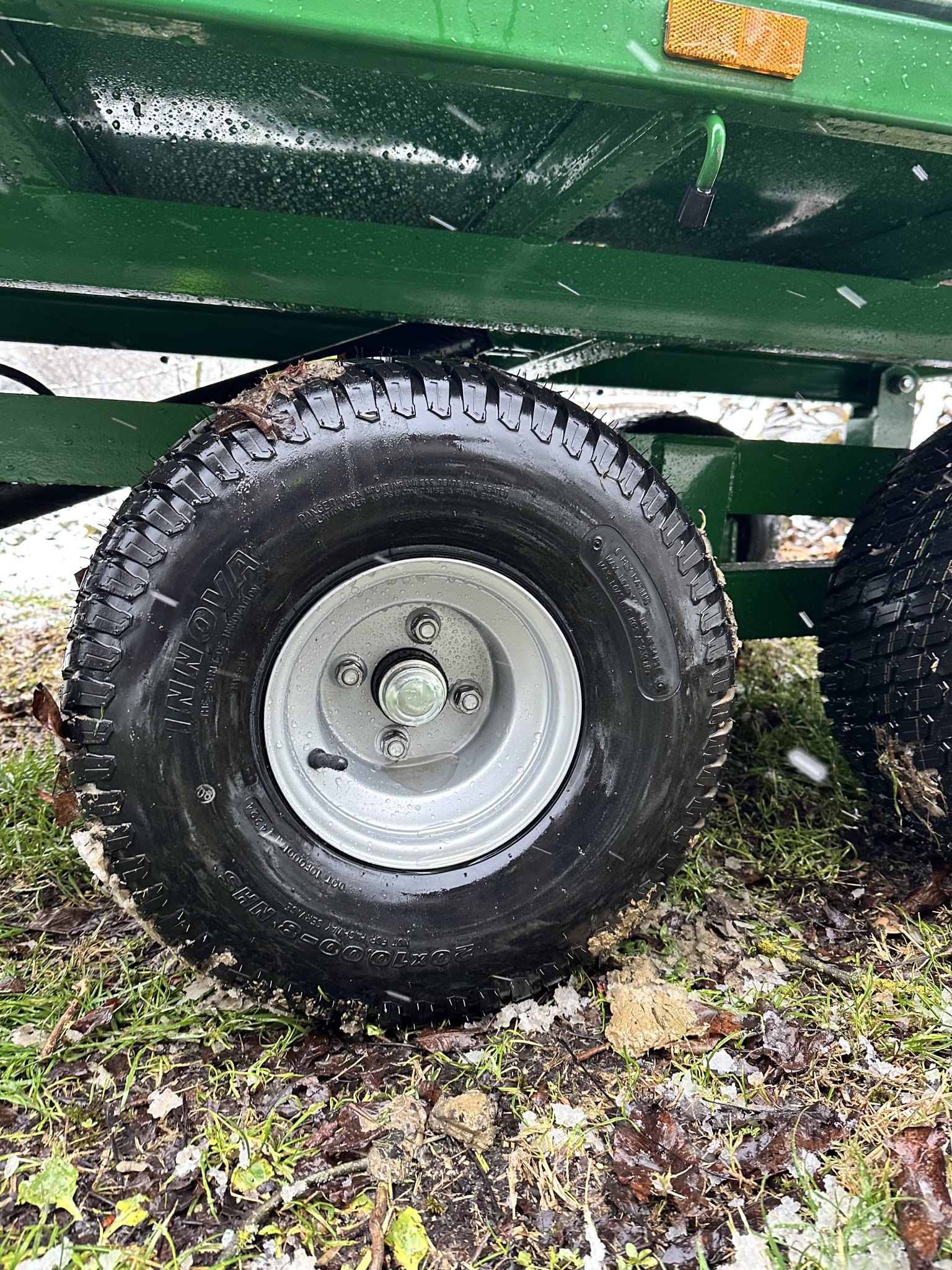

Some of you also recommended getting brakes, so it got me thinking, and I really want them now :) Wheels of the trailer are really small. Look at the image attached. Russell King suggested to look at this page and it was really useful because I think I was able to track them and I think they are of a this kind: https://www.etrailer.com/dept-pg-Trailer_Tires_and_Wheels-pc-8_Inch.aspx

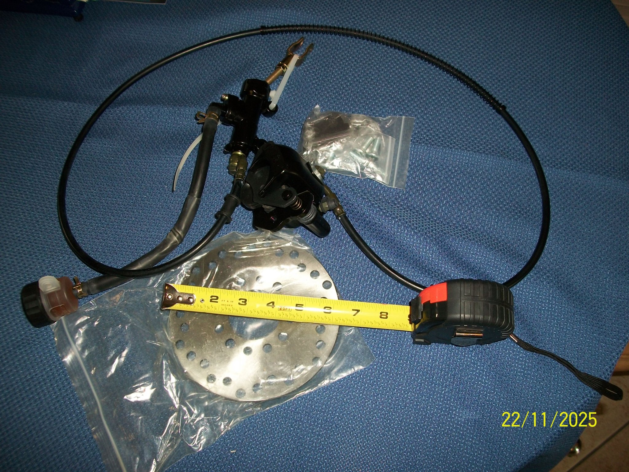

I was aiming at electrical brakes, but would be happy with any I guess. I searched the internet and couldn't find much except that such wheels are used on ATVs.
And then I managed to find this:
Can you tell if this would work for my case? And what else do I need? It looks like these brakes should connect to some kind of a brake cable?

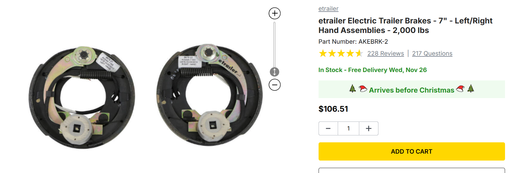

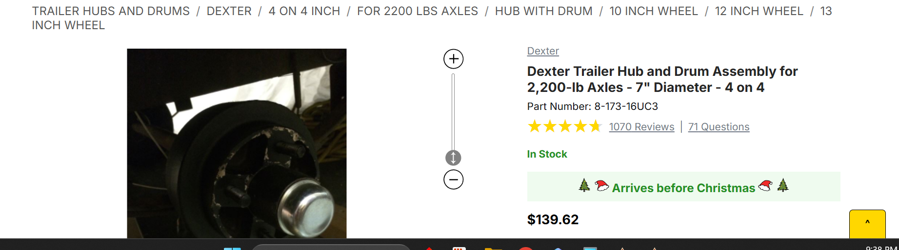

Thanks. So I need both? Hub and drum assembly as well as brakes? Sorry I am completely clueless about this. I guess the first is like a cup within which there are brakes? It says 7" in the title (diameter of the drum I guess) but in description it says it is for Wheel size: 10" to 13". Would that would work for 8" wheel, which I THINK my is?
34,226
9,410
Yes you buy the hubs and then the brake setup to match.
If the inside of the rim is too small then you would need to go to a larger rim size to accommodate the brake drum.
You would also need to check the spindle size and length to make sure it matches what you need.

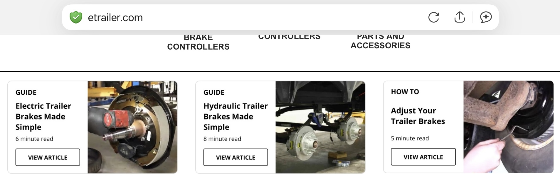

@Rosohatica
Go to this page and move to the bottom to read articles about adding electric or hydraulic brakes.
You should see something like this
From my memory you would be able to buy brakes that can bolt onto most normal trailer axles. I am not sure what your axles are or if they have been prepared for brakes. These articles should lead you through a process and that may require a new axle. You may need to call and see if they have brakes for your off road trailer or if they are even manufactured.
