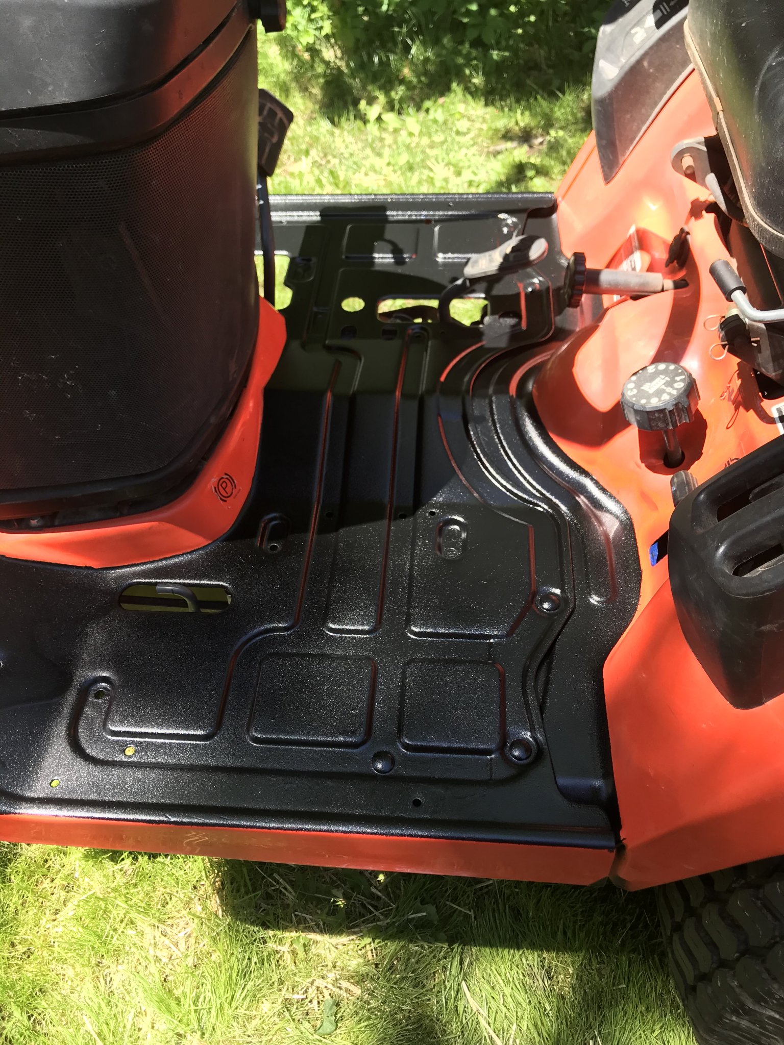

Been thinking about doing this for a while. Spray can of Herculiner. I’ll post the before / after and then post my rationale

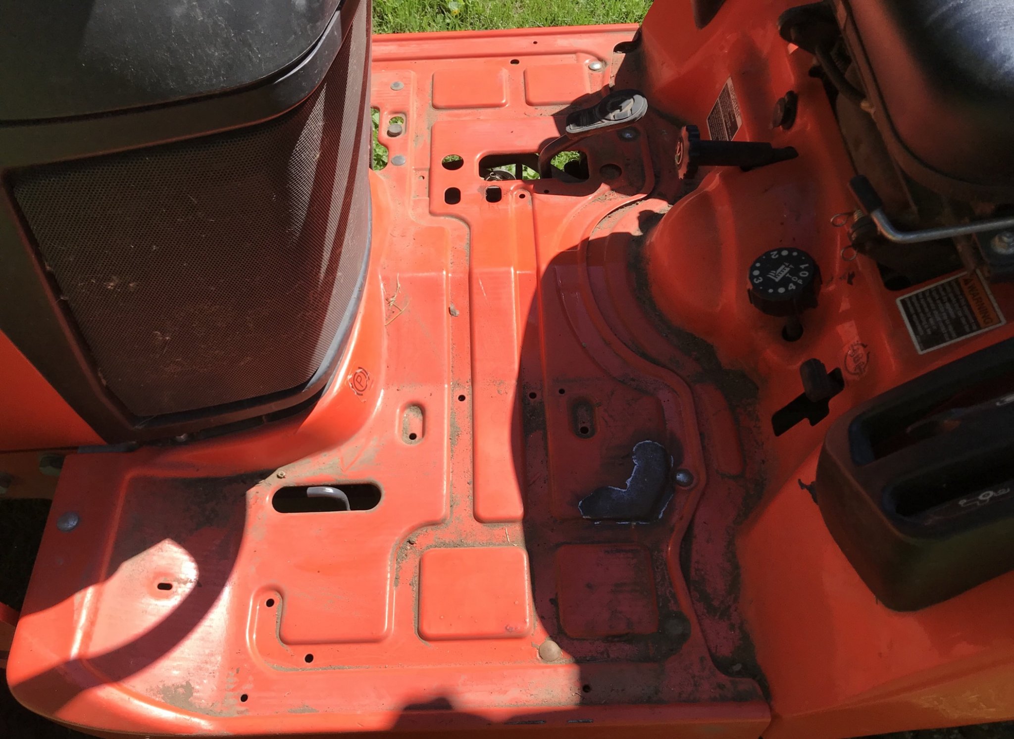

I don’t have a garage or outbuilding so I park my tractor under a raised deck. That offers some protection but not much. I’m in the Midwest and we get very cold to very hot and humid. So I find under the mat doesn’t dry out well given the tractor sits outside.
I had some rust develop. So I decided to try truck bed liner. Other than potentially getting some of it somewhere it shouldn’t be, like the pedal mechanics, worse case is it doesn’t work well and I put the mat back on.
I researched spray on bed liners and am aware the spray can stuff is not rated very high. However, my thought is it’s mainly just for my feet and shouldn’t take too much abuse.

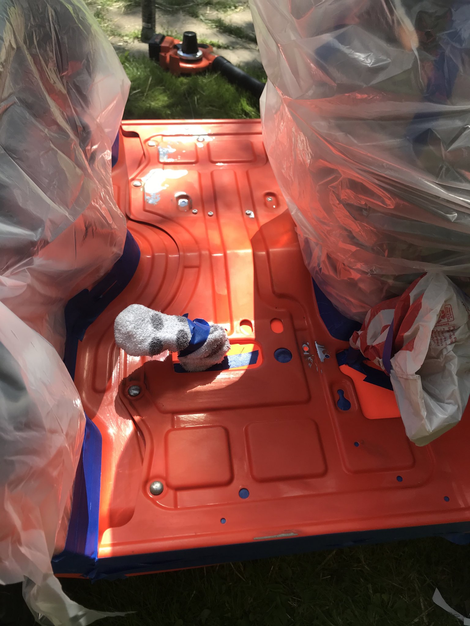

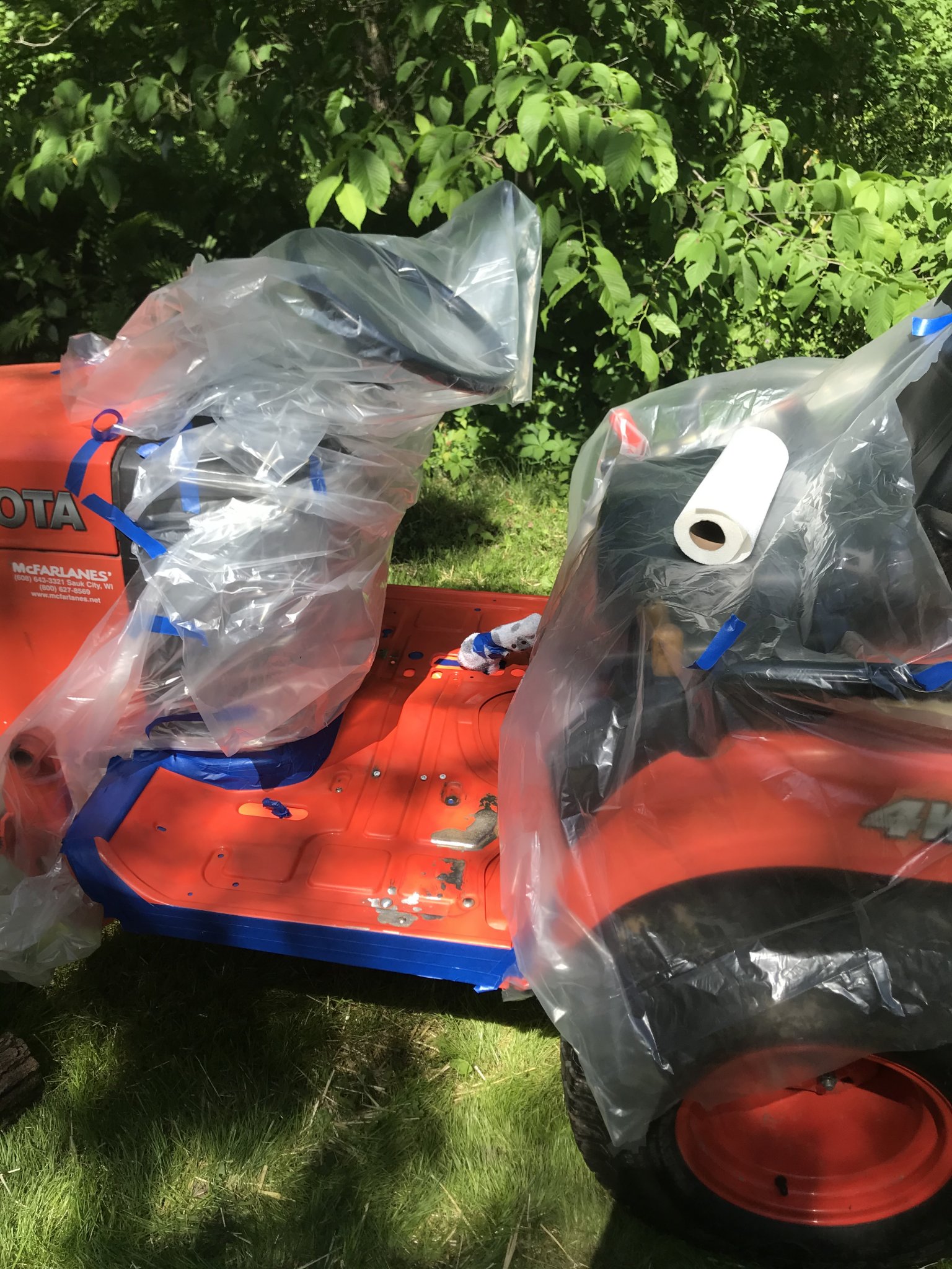

My wife was nice enough to tape it up. I’m not patient enough. Other than a little bleed through I think it turned out well. We’ll see though, I know it could come off the second my feet touch it.

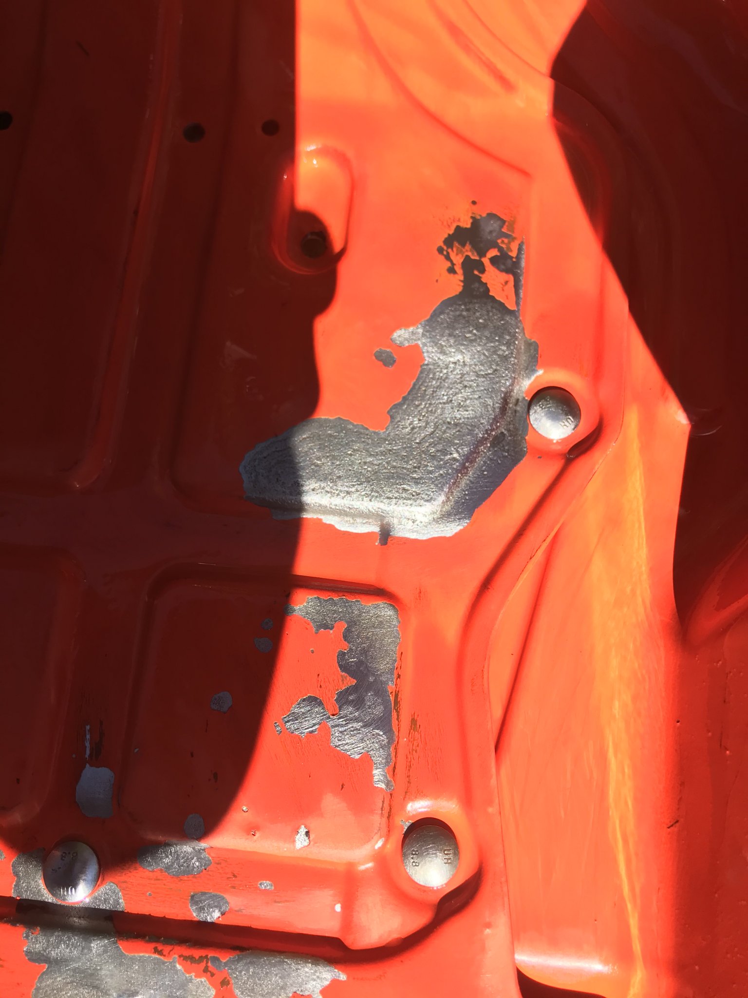

A few more pics of the process:
First I got rid of the rust. I appreciate members here that directed me how to do that I’m another Thread. It seemed to be pretty deep.

It looks great! You did a good job of cleaning it first.

Trail, that looks super! Very nice prep job, too. Even if your shoes do wear off some on the high spots it should just take a squirt or two to touch it up again.

You did a great job prepping and finishing that job. It looks great but I do have a question. Have you thought about putting the mat back on? Now that you have protected the deck from rust you should be able to put the mat back on and potentially keep the protection on the deck longer.

Geohorn - No, you cannot borrow my wife. She did a good job though. :)
Armylifer, Bird Dogger, Mickey D - Thanks for the feedback on the prep work! I know it isn't difficult, but I'd never done it before. Good to know it looked good.
Army Lifer - I had thought about the mat. I think given its the bedliner material, I'm going to give it a go without it. That was my intention. However i thought about what you were saying. If I do put the mat on, water and bugs will still get under there like before. So, I'll see how it goes without.
