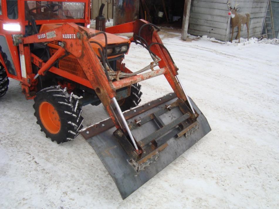

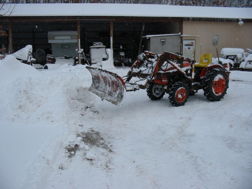

Dusty, I've admired your blade and ingenuity on several posts. I wondered how you put the curve in the blade? It looks to be about 1/4" thick and putting a bend in it using "shadetree" tools wouldn't be easy. Care to share your method? Thanks!
dusty-t
Feb 17, 2009
974
Mountforest Ontario
Thanks Pat. I had it bent in a break when I bought the piece of steel. But I put it back on the trctor a couple of days ago and it seems I straightened the bottom. So I am going to try and rebend it my self and then brace the back side so it doesn't bend again. I am also going to box the sides while I am at it. I still have the rest of the interior to put in the cab before I start the blade.:D Dusty P.S. I should have had it rolled like a normal curved blade. They would have done that just as easy. Hindsight.
