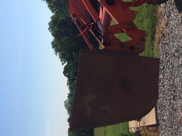

Trimmed back the bottom edge, so it doesn't dig in when scooping. I would trim the back edge, but I want it to sit upright when detached.

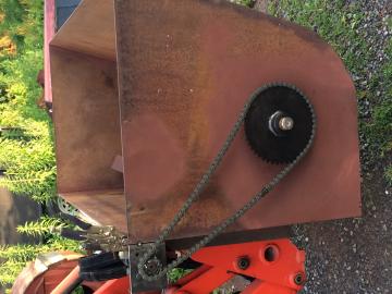

50-75 rpm is fast for a mixer. Mine is geared to run 15 rpm at idle and 23 rpm at 1500 rpm. I will run it at about 20 rpm.
The sprocket and hubs arrived but somehow I lost the idler I already purchased so I need to buy a new one before I can find the one I already bought : (
I think it will be fine for now without an idler so after I weld the main sprocket hub and the motor mount, I will give it a test run with #57 stone to check the line pressure, etc. Everything runs true the way I have it tacked in place.
I will try to post a video somewhere once completed. Sorry the photos are sideways, I do everything via mobile device..
