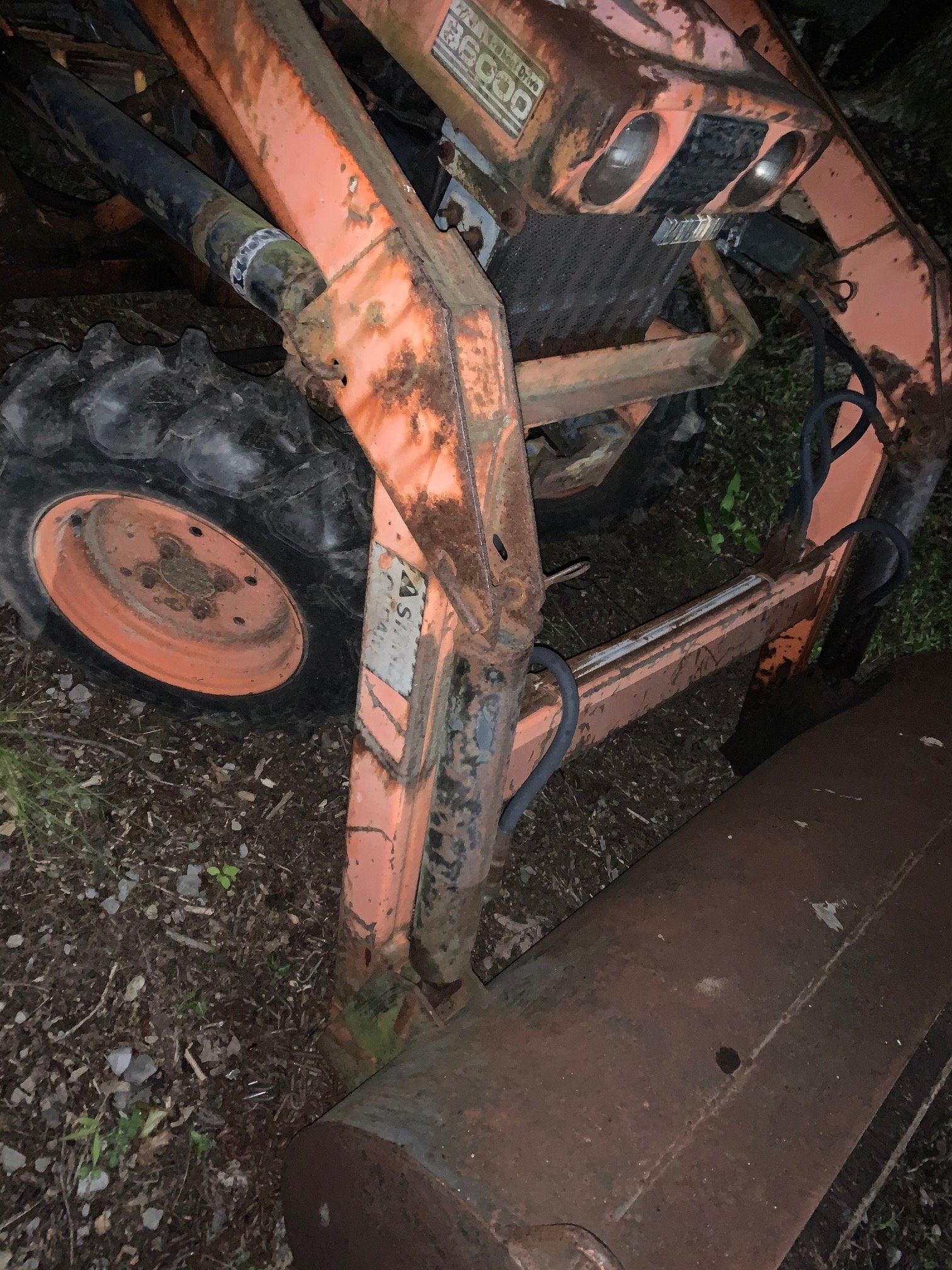

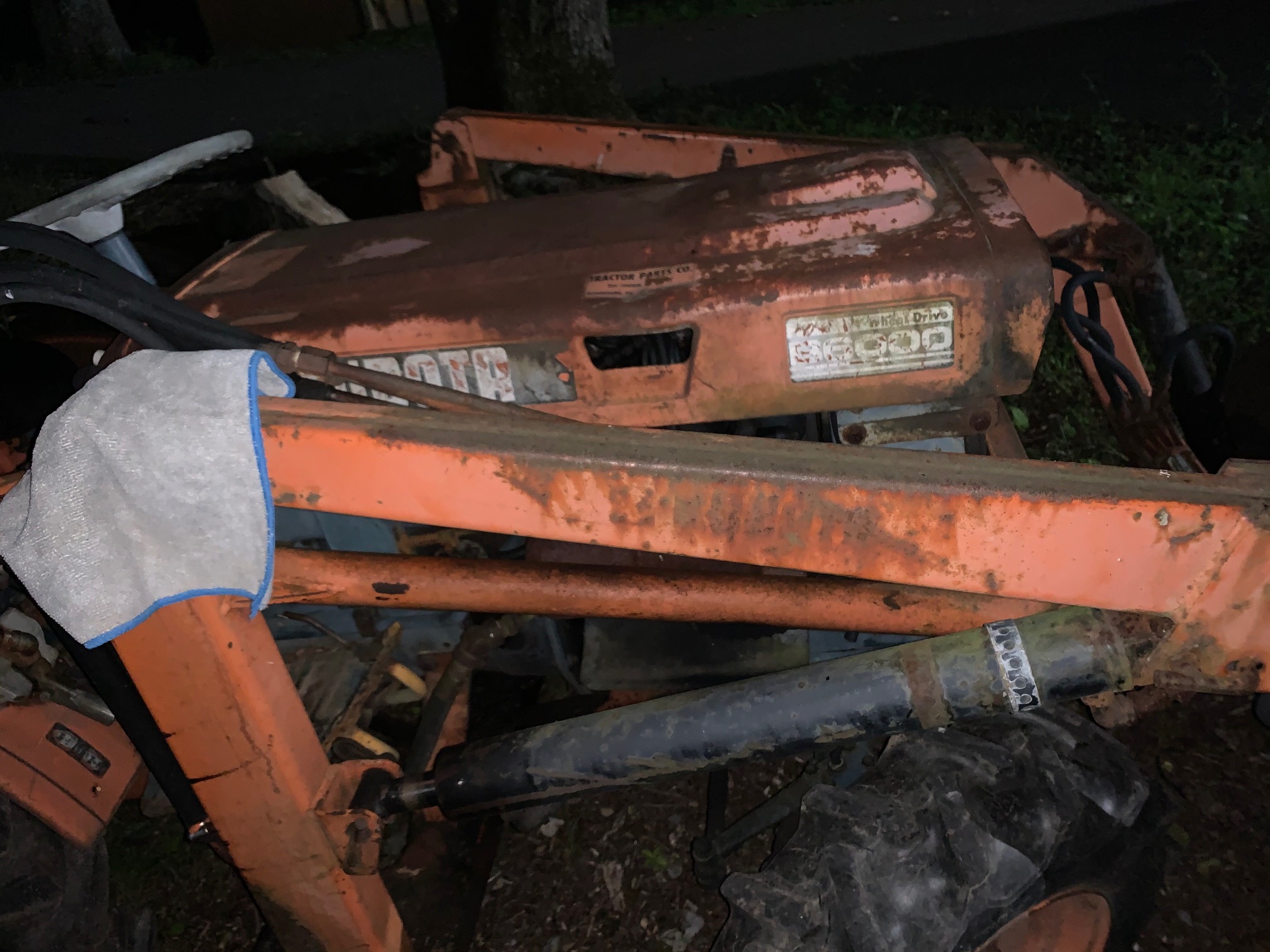

Geeze tough audience! I never claimed I was a painter nor try to be , but all things considered it came out much better then the way I received it. LOL
Original Link To Rebuild Pics vs now with "5 gallons finish" , I'm not ass blasted by the finish considering no metal work to the hood was done and I didn't disassemble to paint a work machine not a yard princess lol
Looks fine to me, just not Kubota Orange and I like the painted hairpin cotters too.
Around here, 5 gallon finish refers to a backyard paint job, sometimes applied with a brush or roller. Usually refers to a paint job applied to a John Deere.
Lol ! Not butthurt just didn't know the expression. It was "out of the can" Krylon Fusion Popsicle Orange spray paint after grinding/stripping the surface rust and sanding to bare-ish metal where it was rusted. Not "Kubota" orange but it's close enough for me for a loader that sits in the barn to fix the driveway washouts and move firewood without continuing to rot to hell.
