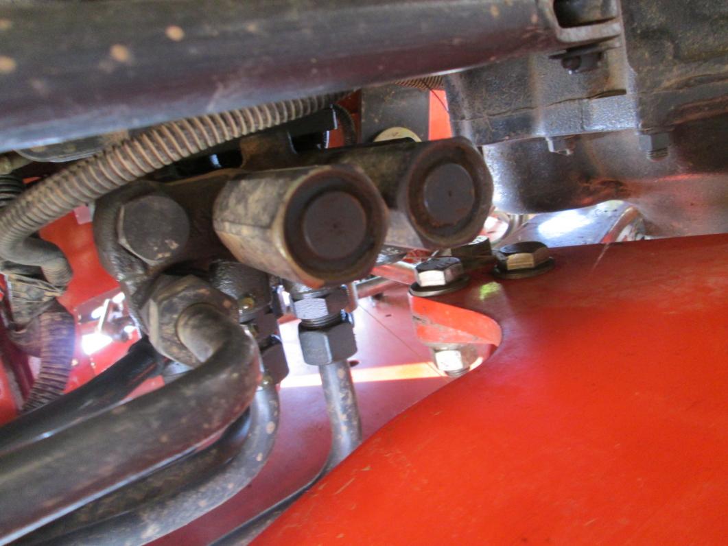

an update as to control valve sticking. Tried most all suggestions and should have crawled under tractor instead of looking from top side. The photo is of valve from below and there's two cylinder; the one that is sticking is the one to the right. Question I have now is, do I carefully remove the cylinder in question and will I find the spring in the cylinder? It this a dry cylinder or is there fluid in it? One thing for sure it will be a tight fit with open end wrench. Socket wrench won't fit. ugh Many Thanks!! Ray
7,457
2,456
When my B7100 & my buddy's B7510 showed the same symptoms, we looked at the area you have pictured. On ours, the cylinder shaped things you pictured contain the detent mechanism for the float position. Both were rusted beyond saving. They both had similar setups inside, with steel balls, springs, & a detent groove. I could not get parts for mine, so I removed the guts & it now is smooth as a babies butt, and I must hold the lever forward for float. My buddy has parts on order for his.
Thanks for the input Lil Foot. I'm assuming the one on the right is for the bucket dump and the other is from raising/lowering FEL. I will probably tackle tomorrow when I'm finished with "honey-do's". Ray

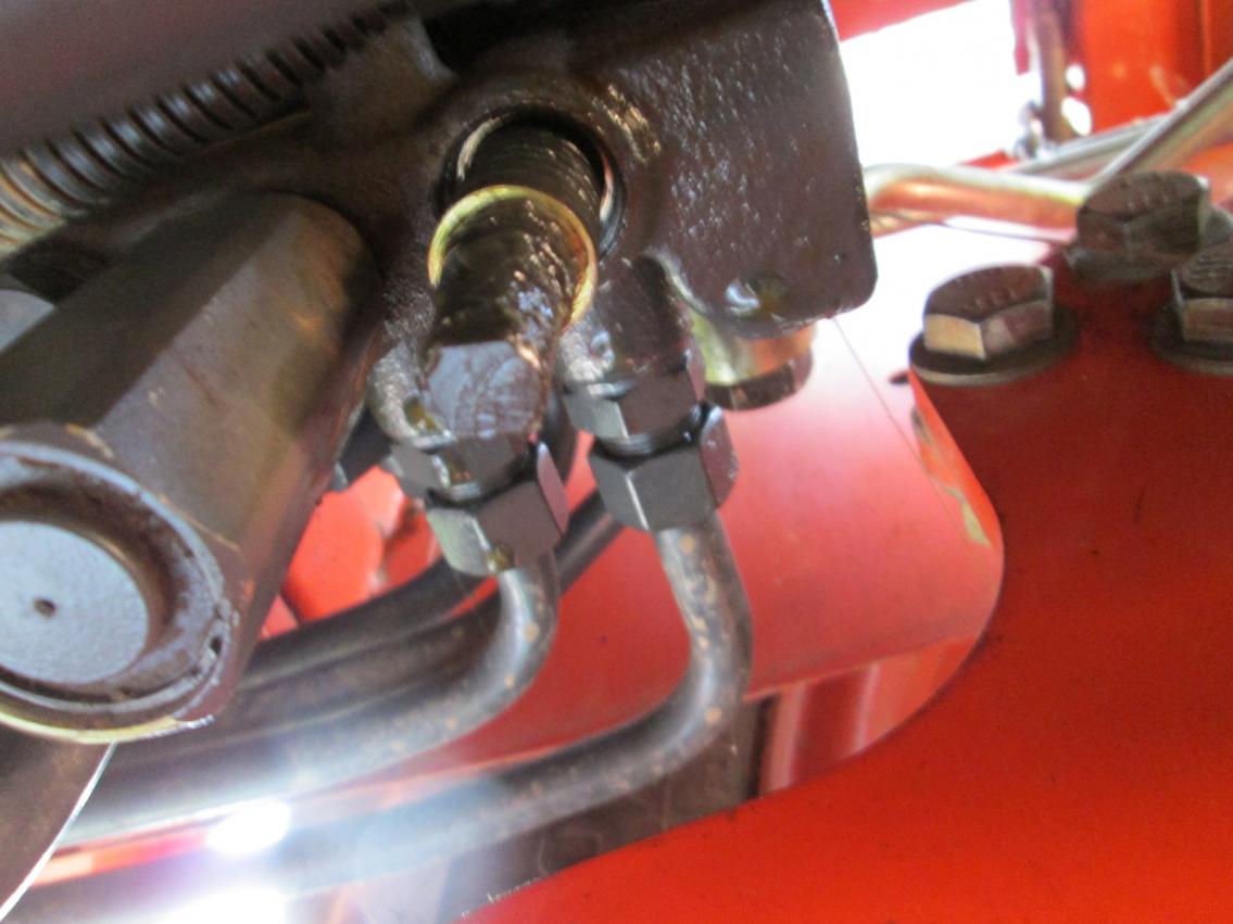

Made some time and managed to squeeze under the subframe. lol Attached photo show spring uncovered. No rust and well greased. Did notice when I removed the other cover the spring slipped down and lift control lever had to be pulled back for the spring to retract and cover replaced. Please bear in mind I have absolutely no ideal on what I'm doing except I know I need to get it done. The exposed spring will not move like the other. How do I remove the spring? At the top of the control valve, the rod is attached with a pin. Do I remove pin and turn the rod from the base? I feel this is a simple fix once done. It's the not knowing what to expect. Many Thanks! Ray

Mine had a regular hex head bolt that unscrewed while holding the spool (the part that moves back & forth in the valve body) at the lever end- yours appears to be similar, except with a sort of "oval" style head.
Many thank - does the post slip out with spring? Is there anything else on that post?

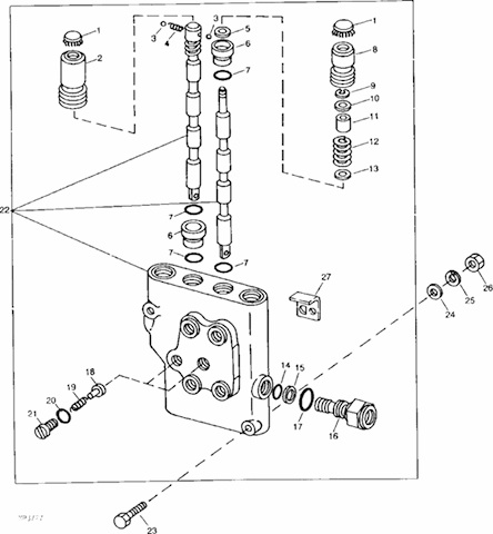

Sounds like you need a manual for that specific tractor/valve. I would not disassemble it further on the tractor, without a manual, or without a rebuild kit.
Here's a pic of a valve similar to mine, and, as you can see, it's not a simple post that pulls out... there are seals, o-rings, springs, relief valves, etc.
