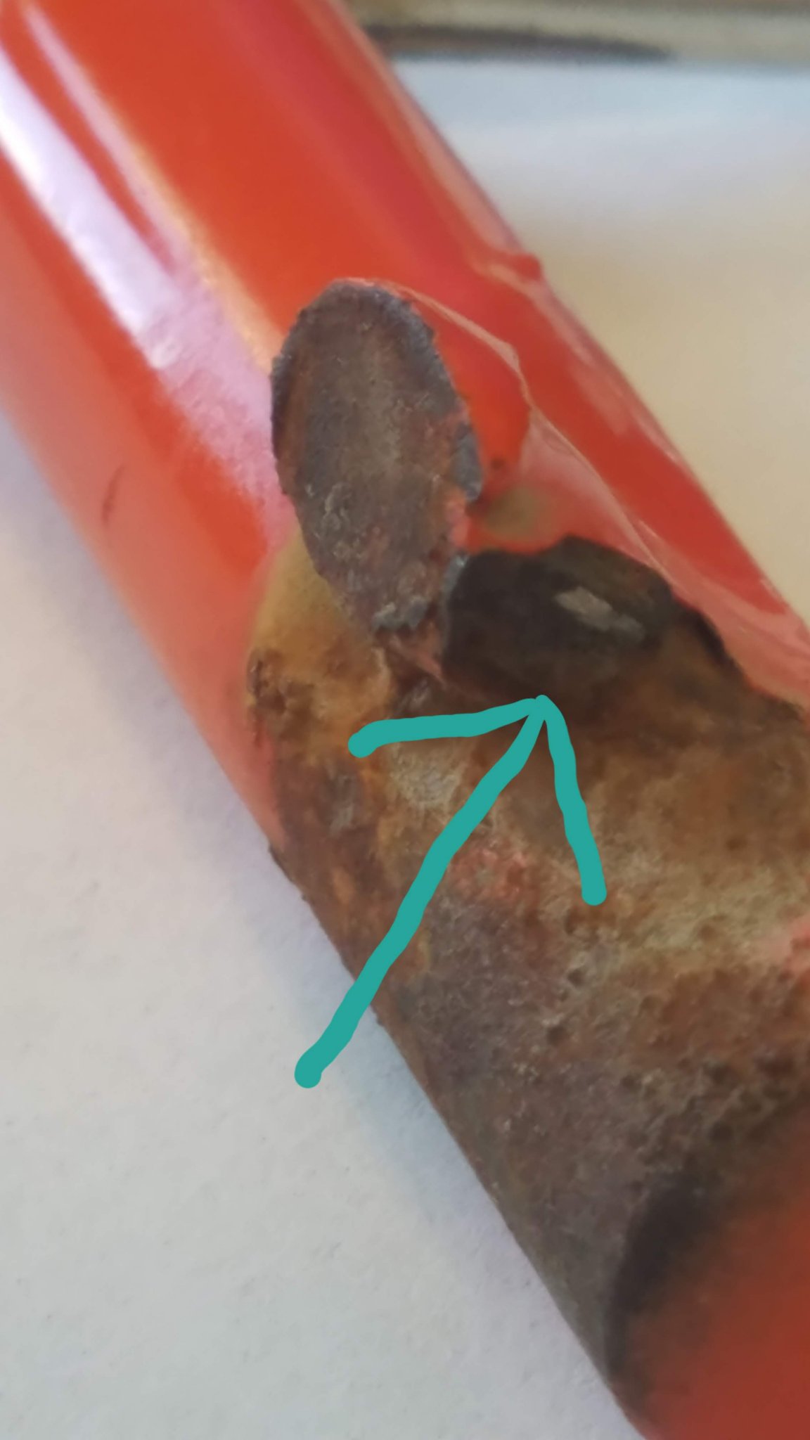

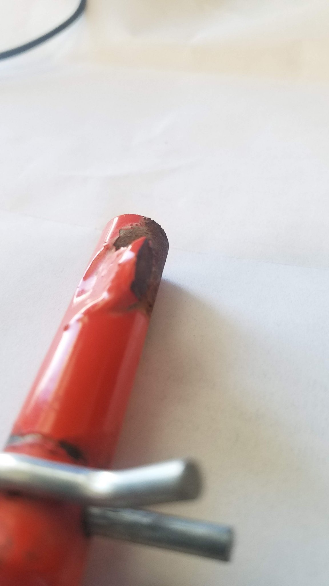

It's a bit worrisome when a factory weld that hardly needs any real strength fails. This looks to me like a classic case of a cold weld. No penetration at all on one side, but it looked perfectly fine under that pretty orange paint. This is the pin that holds the loader kickstand up when it's not in use so it never gets more than a few pounds of force on it. Notice in the picture with an arrow that there is a tiny bright spot. That's all the more metal that was actually holding the pin prior to failure. It's still under warranty, but hauling the whole tractor 30 miles, leaving it for a day, then hauling it home again is a lot more trouble than just welding it myself.
You see a lot of production line 'welding' like that. They hire folks off the street, hand them a MIG gun, and they're a welder. If it looks good and doesn't fall apart before it leaves the paint line, it's good.

kubota won't warranty anything if you take parts to them and tell them to weld it up. That is a cold weld, or a dirty weld (or both). Most of it is done robotically nowadays. What little bit is done by a real person, that person has a quota. If a part comes through that needs a little weld, and he's behind or close to getting behind and the part is contaminated, or the welder has an issue (ground, etc), he's gonna throw some dirt dobber's nest of a weld on it and send it. Unfortunate but that is how production works. I've done it in the past and have seen lots of this kind of thing.
if they feel like it is indeed a warranty issue, they'll replace the part. The entire part. They don't want nobody welding anything. Been there done that. Denied claim because "I" repaired a loader, similar to what you have there (broken kick stand pin). Not a big deal, was only a couple hundred dollar once all the paint + dealer fees were added + labor, but the fact that they (kubota) denied it because it was "modified" (welded) kinda upset me--and the customer--and the dealer I was working for. I left the dealer, but I "heard" that they eventually paid it. Dunno.

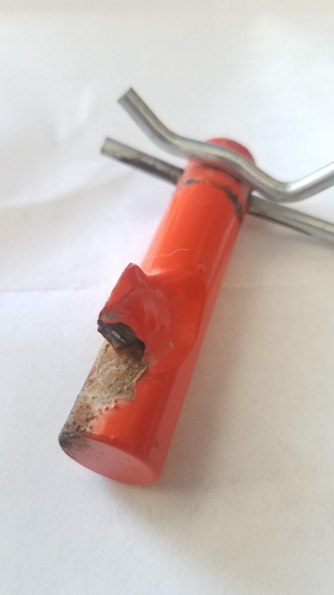

just as bad as the poor weld is the LOUSY powdercoat paint ! It's obvious it never bonded to the steel,which indicates poor 'prep' of the part before painting.

If you look at pix #3, the 'paint' never,ever bonded to the steel. That's the typical problem I see with everything that has been powder coated. Scratch the paint, water(moisture) gets in,rust forms,pushes the 'paint' away from the steel, more water gets in...cycle repeats over and over. Also obvious that NO primer was used on that part..ONLY orange 'paint'
Bad welds are usually caused by 'gotta make more in less time' philosophy... looks good on paper('saves' money).. well 'production' money..factor in 'warranty' money and it costs more in the long run.
