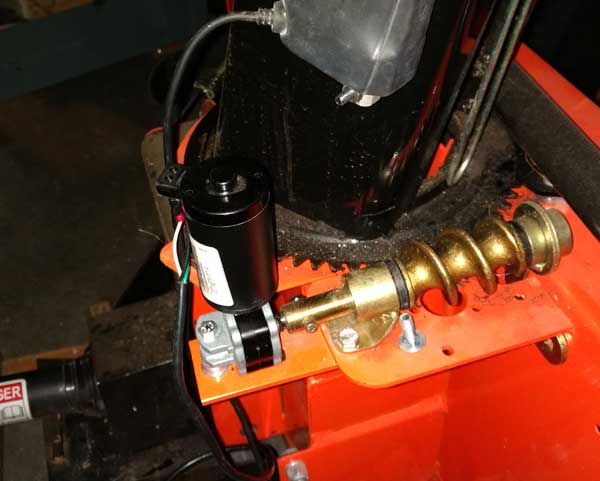

Finally! Got to use my new blower today and I wish I bought it years ago. We got very wet heavy snow and the blower was flawless. No clogging and my little 18hp (which I was a little concerned about) had plenty of juice.
No problems with the power chute I put together. I wish the up/down deflection moved a bit faster but I can easily fix that in the off season by changing the mounting points. Then again it's probably better to have it move slow and be dependable than to move fast and get hung up. The power window motor worked great for chute rotation, didn't miss a beat and I found it to be plenty fast.

Likewise: having copied your selection of power window motor, I have found it works well. One note: despite the layer of grease I applied to the worm gear and chute, the initial wet snow froze the chute in place and the motor stalled when I first hit the switch. It was fine after I broke the ice. I suggest keeping the mechanism clear of wet snow after use.
I also find the chute deflector a little slow, but it doesn't get used much anyway. Generally I can anticipate the need, otherwise, I just pause for the few seconds required.

Two concerns with a seat motor; is it able to deal with moisture? A window motor is designed to get wet since water always manages to get past the weatherstripping at the base of a window. If power seat motors get wet you generally have bigger issues lol.
Also, the power is all in the gearing. For a seat slider, you may have a 10 to 1 reduction in the motor gearbox but an additional 20 to 1 reduction may be coming from the cam style slide mechanism itself so the seat motor may be weaker than the window motor once removed from the whole assembly.
A window motor usually works the opposite way. It turns a large lever that lifts the window and has a opposite leveraging effect by amplifying load. The gearing in the window motor compensates for that with even higher gearing which equates to more torque.

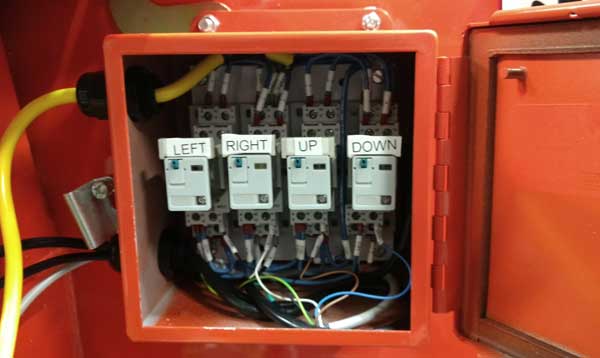

I like the 4-way joystick controller. Can I ask if you run the 12 volt switched load directly or via relays.
If relayed do you use one for each activation or just 2 and loop across the switching wire.
I was looking at a long shaft 190 RPM seat motor encased for weather proofing . Is that what you used and if so what is the rotation speed like.

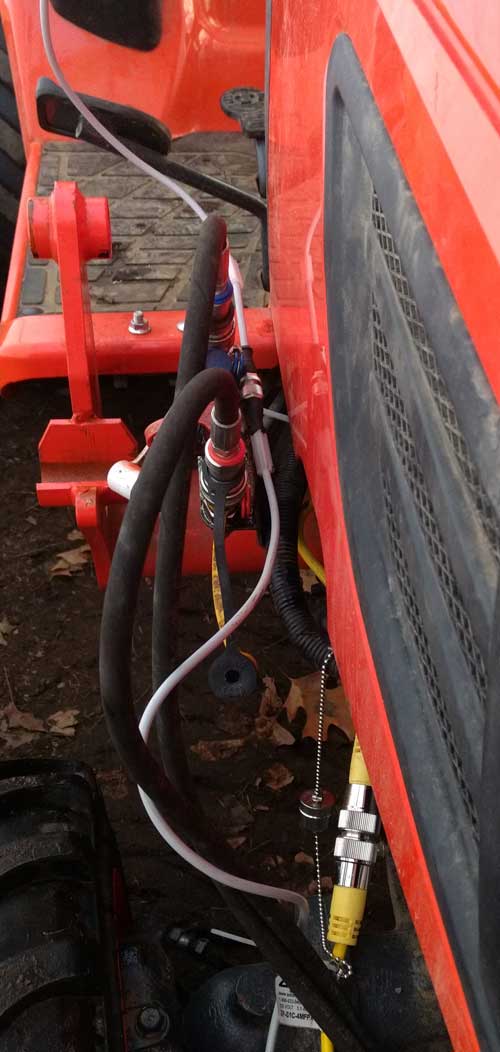

The joystick only gives 1 contact for each direction. So I mounted a box with relays on the blower. Box lined up with existing holes in blower.
Got motor from https://www.sciplus.com/p/CAR-SEAT-12VDC-GEAR-MOTOR_49248 it is 190 rpm. Speed is good. Easy to reverse the head to get shaft coming out other side.

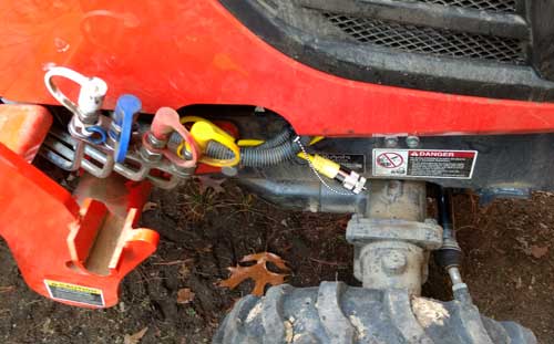

Bought a pair of circular connector extension cables cut them in half. Connected the ends and wired power and joystick the blower. The connectors in the middle make it easy to disconnect the blower.
