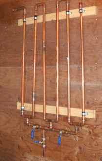

Mine uses a similar concept. Was recommended by some old timer on Len's Auto Body Forum. (decades gone now I believe). Until now, I had never seen it used again.
Pictures aren't great, but basically copper was plumbed into switchbacks, behind the fan/pulley, that drain back into the tank.
I also have a Sharpe F88 filter after the copper (bought from Len's store). Filter never appears to need draining. Never had issues with blasting, plasma, whatever.
Love the repurposed baseboard heaters. (y)
I've seen this switchback method used in a personal autobody shop. Theirs come from the pump and started at the top- blowing down the switchback. On the bottom leg it dropped to a long straight with a drain. Above the drain about 18" was a "Y" which continued the loop to the tank, which also had a water separator just before going into the tank.

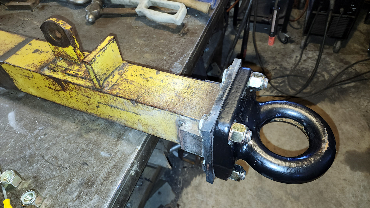

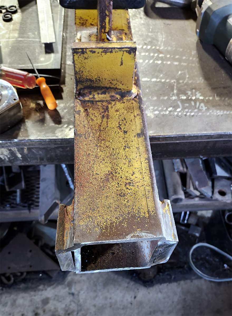

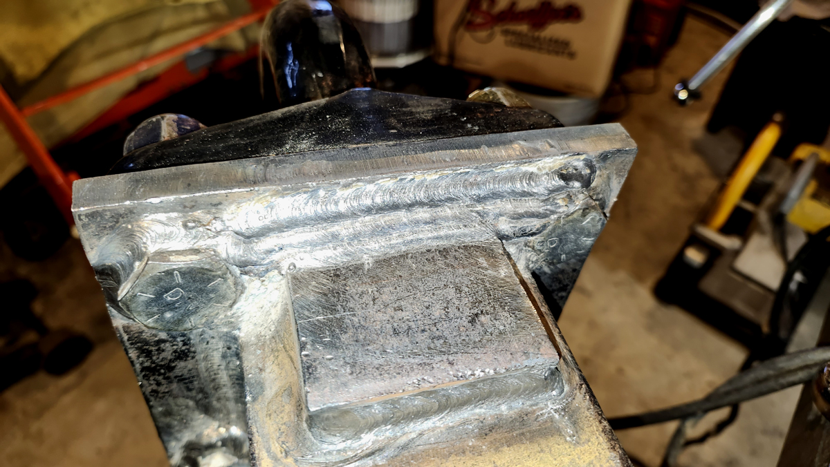

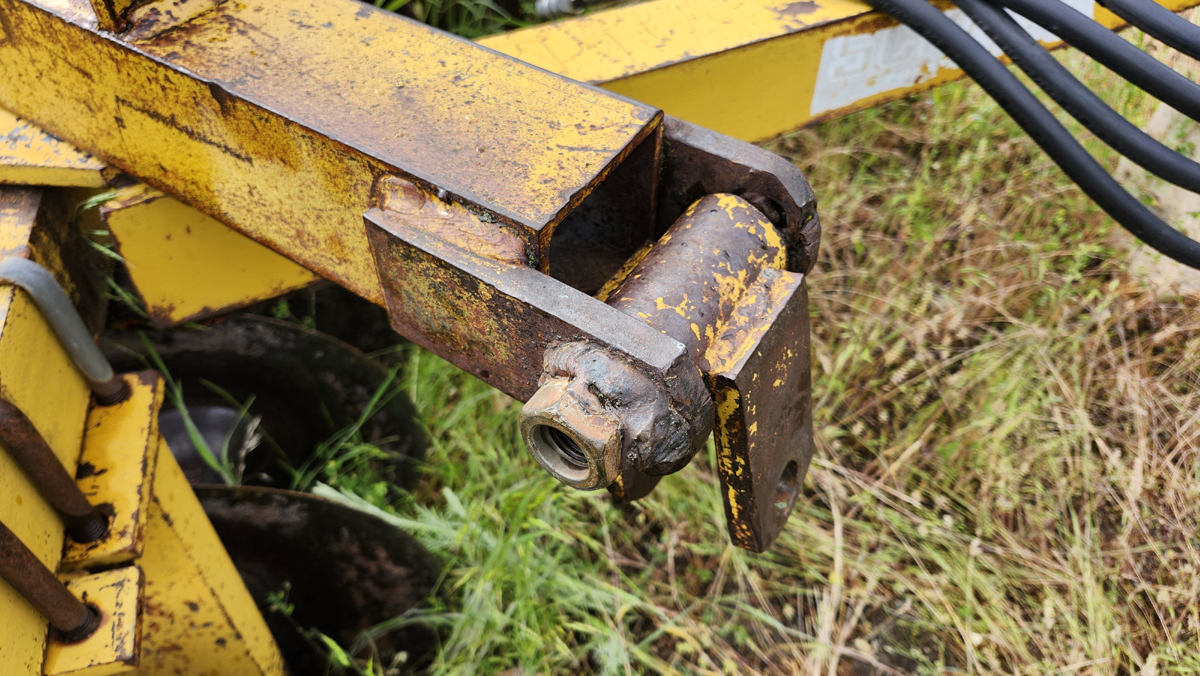

I've had a DeWalt metal chop saw for over a decade, and the first blade lasted all that time and I cut a LOT of steel over those 10 years. A few months ago when I was upgrading the receiver on the Scafer disk harrow to a pintle style the blade got destroyed much to my surprise. I needed to cut off the old interface so that I could weld on a plate for the new lunette ring. I was cutting through the box section shown below as well as through the side plates and the welds between the plates and box section. For whatever reason there was some very hard steel in there.

I plumbed up this system when I built the new shop. Made a HUGE difference in air quality for sandblasting and plasma cutting.

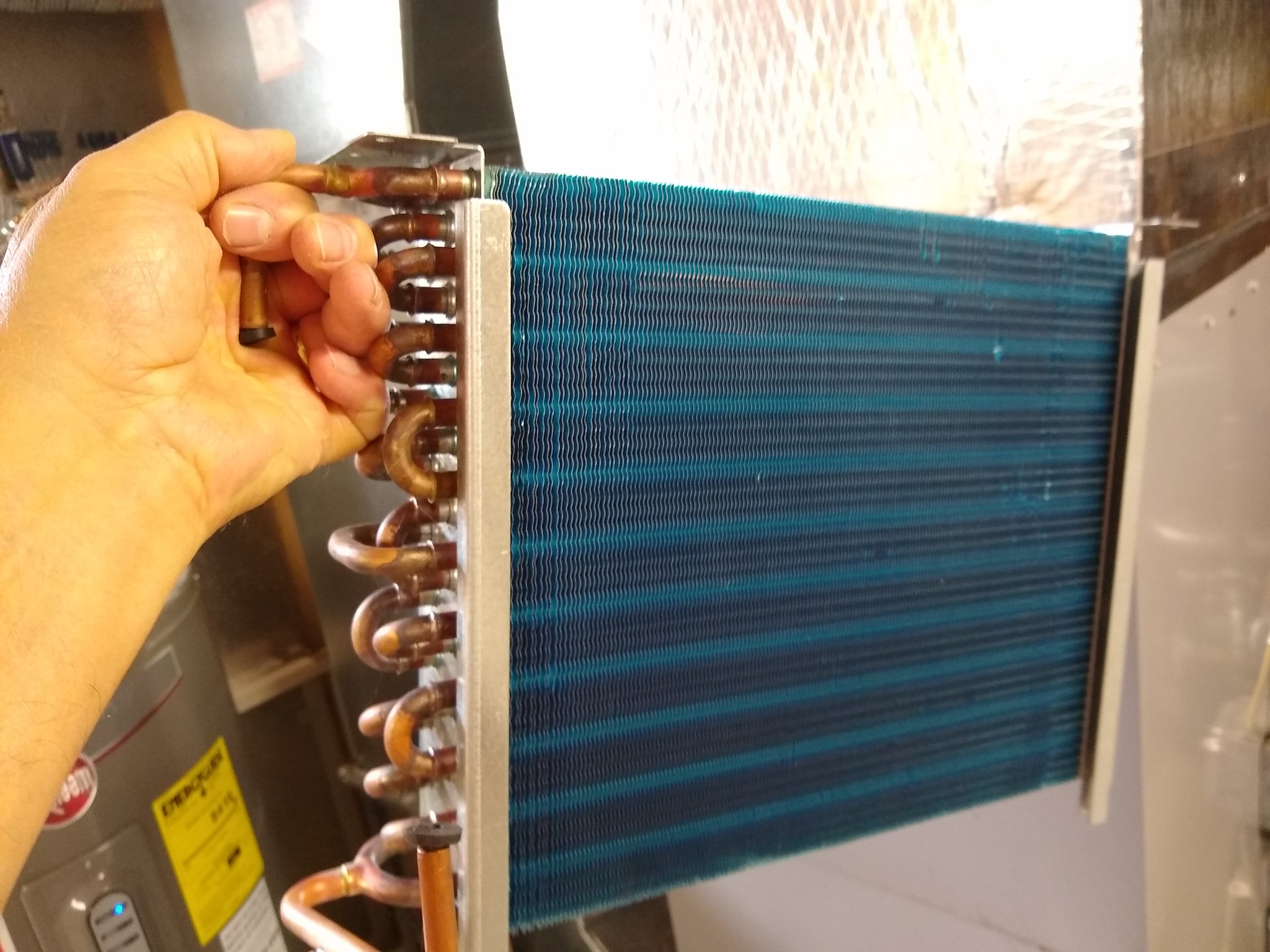

You guys have me thinking about building a dryer. I have an unused condenser coil that GE sent for our ill-fated heat pump water heater. Maybe it could serve as the cooler.

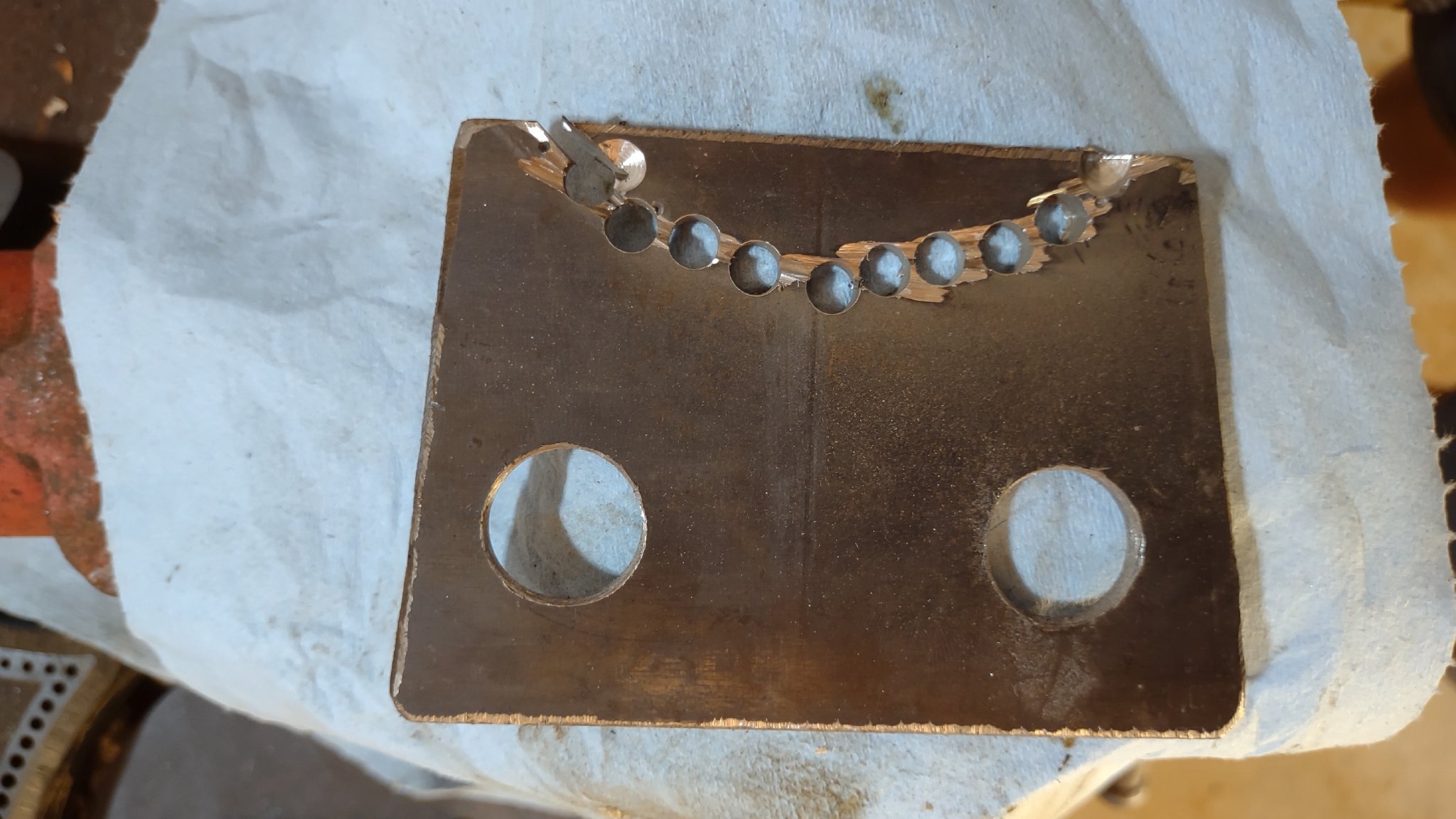

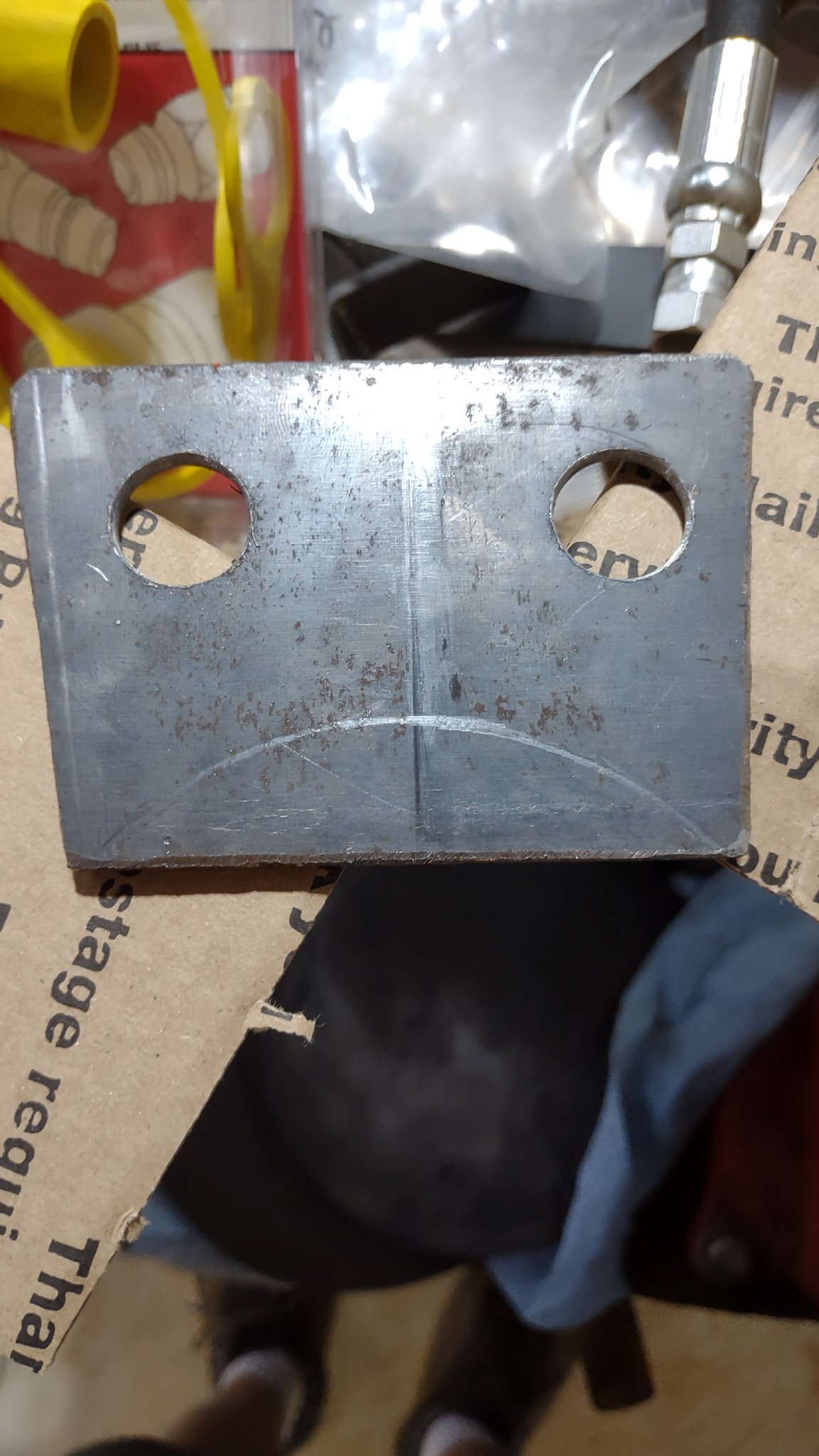

And as far as fab tools go, I'm 75 and still don't have everything I'd like to have. I am blessed to have more than I need to get by. That wasn't always the case. There have been many projects similar to what PoTreeBoy is doing. Drilled small holes first, then larger, then break it out and hand file. Can't say I miss those days but it was a chance to learn to always be thinking about alternatives.

I burnt up a Bosch jigsaw cutting many feet of steel plate when I first started out. Much of that was circles and radiuses.
Actually, my nephew has a plasma rig, but scheduling him and his equipment would have taken longer than doing it my way. Besides, my new-to-me drill press was feeling unloved.

I'm thinking the cooler coil will not work on it's own. Added into the larger system (as shown early on within the thread), it definitely would help.

I was thinking about the coil as one component. Without a tank, drip leg or something it wouldn't help at all. I have a few tanks to pick from. All are better for a few times the pressure my compressor will produce.

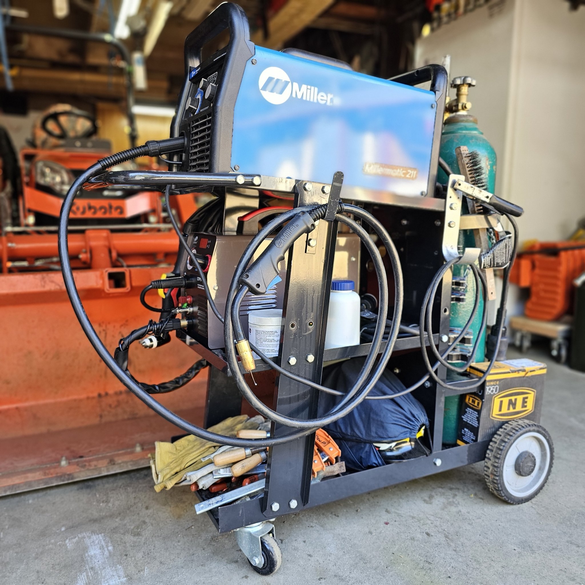

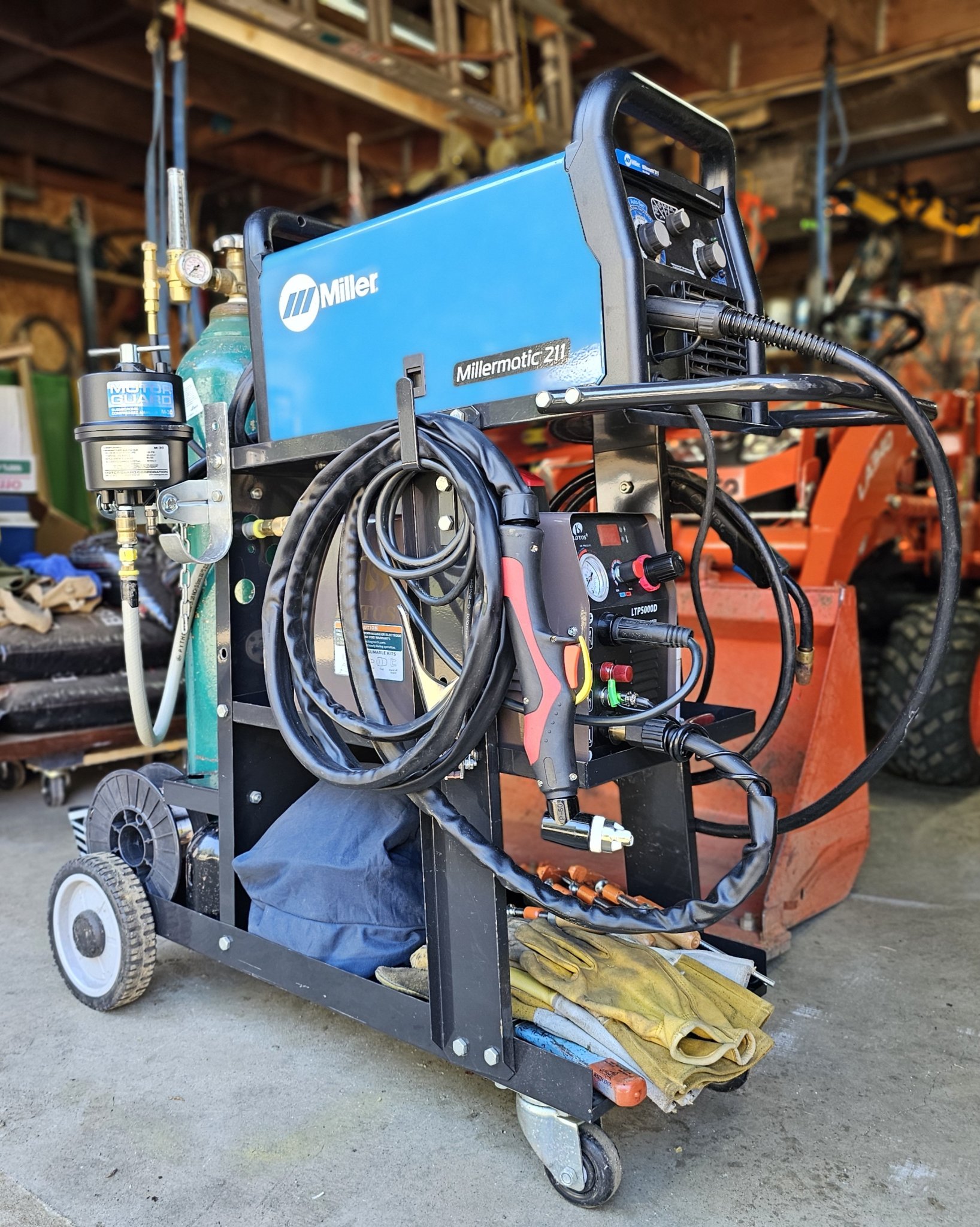

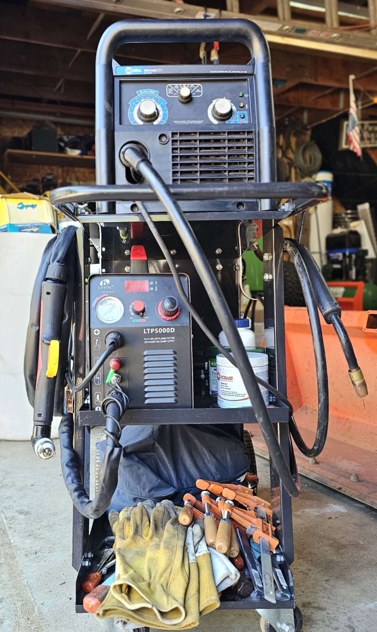

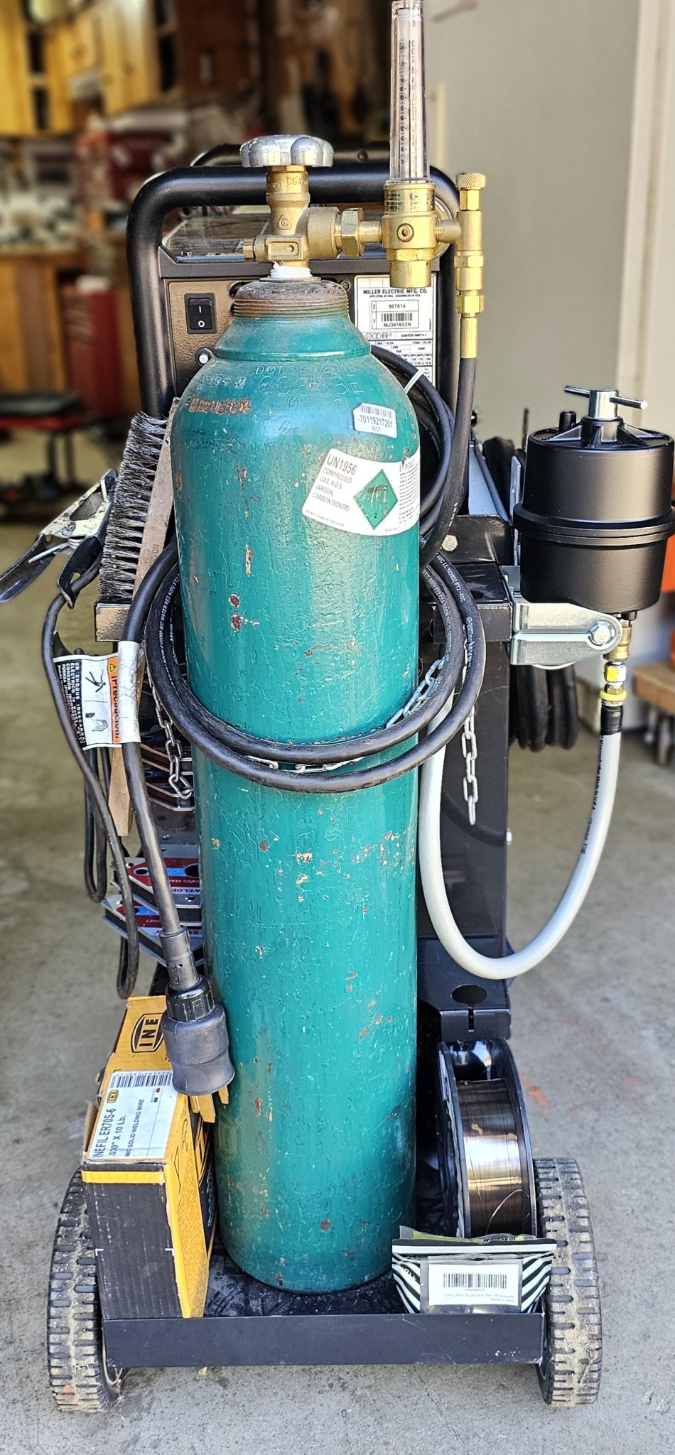

What a chore. It started easy, move the middle shelf down 2.5".
Then I went OCD...LOL.
Man, almost a full day farking around to get my welding cart set-up for the Plasma Cutter to be on board. The cart is completely self contained. The Motor Guard Air Dryer, Plasma Cutter and air feed are all Quick Disconnect. I also made aluminum hangers for both sides, for the "ground" cords.

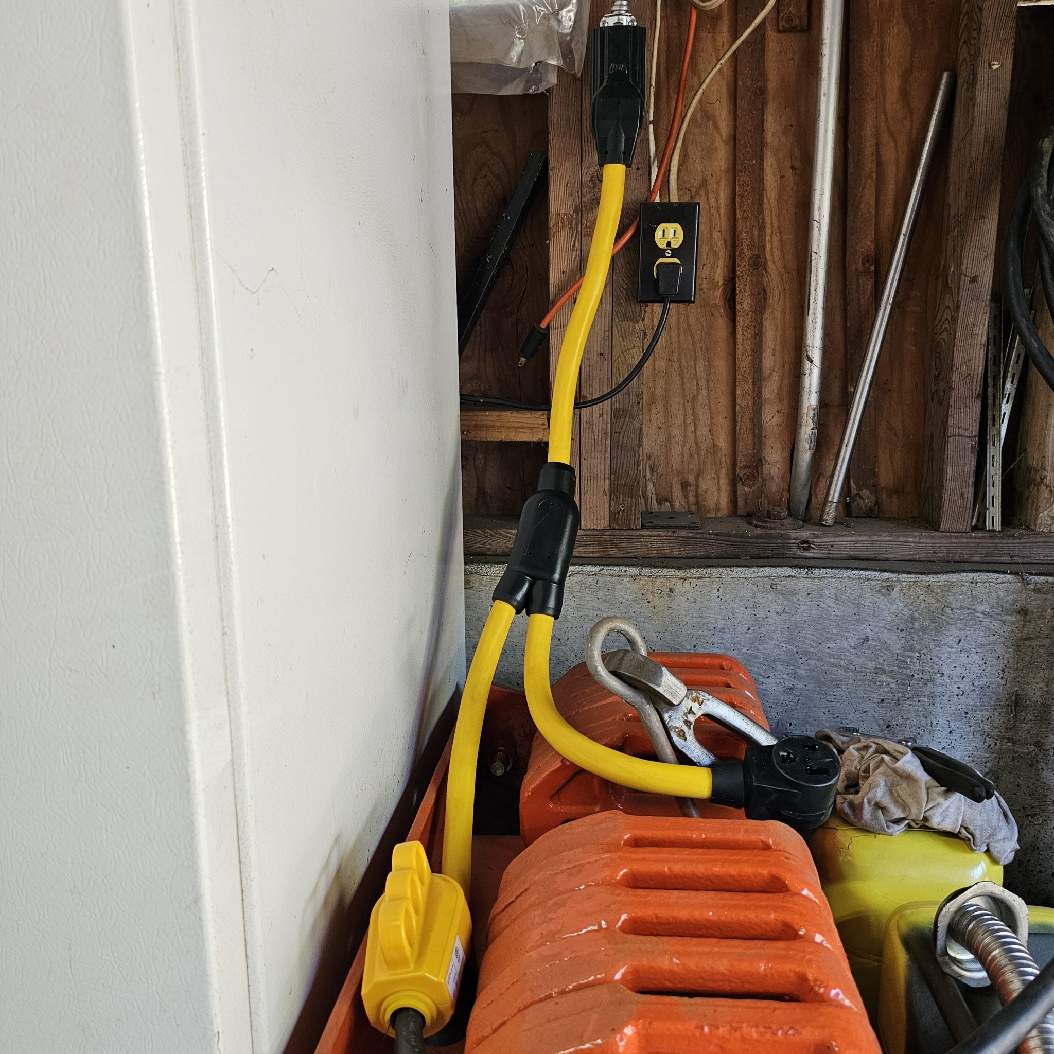

I got a splitter so both machines can be plugged in (not in use) at the same time. Annnd...I forgot to order a mated plug for the Plasma Cutter, so I can't play with it yet...sigh.
Looks great man!
That set up is nearly identical to mine.
Having that plasma cutter is going to be a real game changer.
It makes metal working even more enjoyable.
