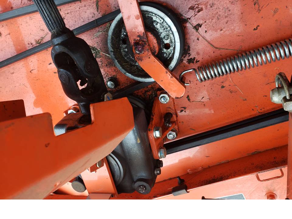

For me its a poorly designed belt. The belt id 2 V belts in one. When the belt wears to the point the center starts coming against the center of the two pulley's then the belt starts loosing adhesion.
This is the pics this morning before I started mowing, all cleaned up, and ready

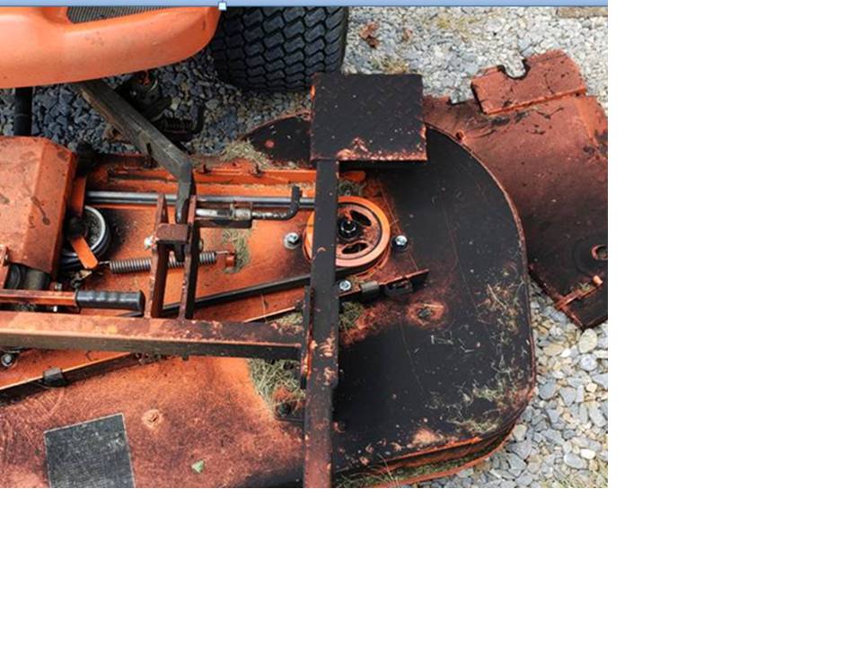

As I cut more a start picking up speed here comes the black. Make it to flat areas where I can just hold the peddle full speed and it increases. Have several pics and tried several ways to reduce size but not getting past 97.7and I have 97.9kb
So much for pics it just not worth the trouble to try to reduce anymore
In short, the belt is a double V which is molded together similar to a serpentine but with larger V's. I might be able to cut the belt into 2 belts down the middle and get more from it, but my plan is now to measure the current belt. Then try to find 2 single belts to replace it with

Trying one pic after return and before cleaning up. Did measure the temp pully's and the outside was 140 to 148 degrees on the out side ones. The gear case was 152 and the idler pulley was 130. This was after about 10 minutes of traveling from mowing site to home and uncovering belt
