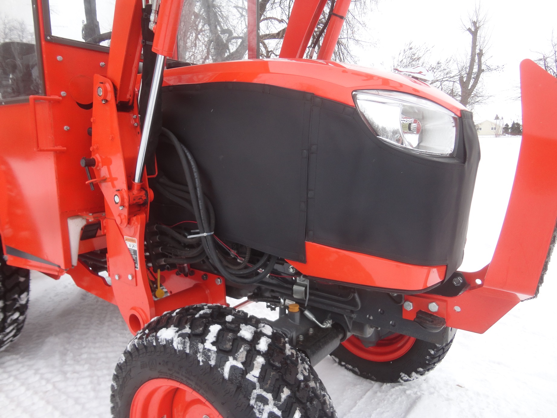

Here in northeast North Dakota my Kubota B2650 gets used in actual temps of -35°F and routinely in temps well below 0° F. Growing up on the farm, our tractors always had winter front kits on them for their winter duties. I made this 3 piece winter front kit for my B2650 for its winter duties. Without it ...... in below 0° temps the B2650 would never warm up. With the winter fronts installed the B2650 can warm up quickly and operate in those extremely cold temps while showing mid range and above on the temp gauge.
Benefits: Any condensation in the engine boils off, the fuel stays warm under the hood, same for the hydraulic oil, no snow ingestion into the air intake clogging the air filter, and the heater output in the cab is substantially more. Here's a pic of the B2650 winter front covers:

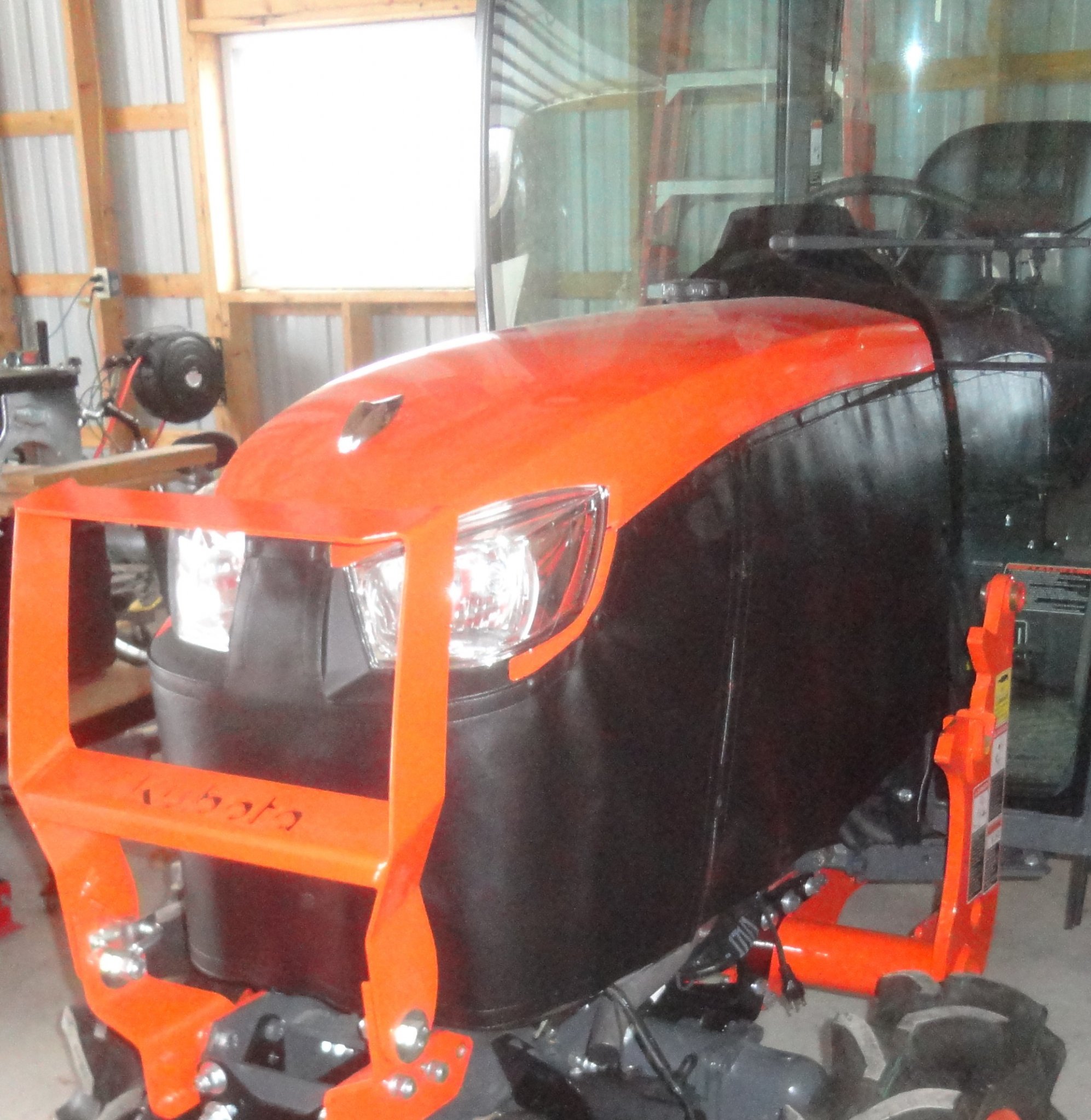

If interested, I also make a set for your LX2610, and a few other models. Here's the LX model:

Regarding blocking off the grill/screen below the steering wheel on your BX23S.....see post #65 here
Behind that removeable outer screen and below the battery there should be one or two removeable plates. Same as what's been done for my neighbor's tractor and a few other's here on OTT. You could block off the outer screen and remove or vary the openings below or in the cover over the outer screen.
I made a cover for someone's BX23S in Fairbanks, I believe, that covered the screen below the steering wheel but also had a variable opening in it to allow more air in as needed.
Our smaller Kubotas need all the help we can give them to keep their engine temps in the midrange in our sub zero temps. Like all the above posters have mentioned.....restricting the cold air intake to the radiator will make for very quick warm ups, help raise the engine temp & help keep it in mid range, burn off internal condensation, keep the fuel warm (if your tank is also under the hood), etc. Once your tractor's warmed up to temp the longer you run it the better! Or until frostbite sets in!! :)
If you have any questions or interest in a nice easy on/off cover for your outfit.....let me know. Would be happy to get one up to you.

Greetings "Northern Neighbor".
Yes, the covers are held in place with strong magnets sewn within the hems. So....easy on/off with no tools or mods to your tractor. I have a B2650 like you, and it was the model for the first set of covers made.
You can see the list of models I have patterns for, along with prices here in the Vendor's Forum.
I try to keep at least one set for each model ready so there isn't much of a delay in shipping. There's links to the write up, descriptions, pics, comments for the models as well in that Vendor's page.
Actually, the upper pic in post #53 above is the very first set made as seen on my own B2650 a number of years ago now. I just put them back on again about a week ago.
Here in North Dakota, my B2650 is a happy camper out working in sub zero temps.
For any questions, feel free to start a conversation!
