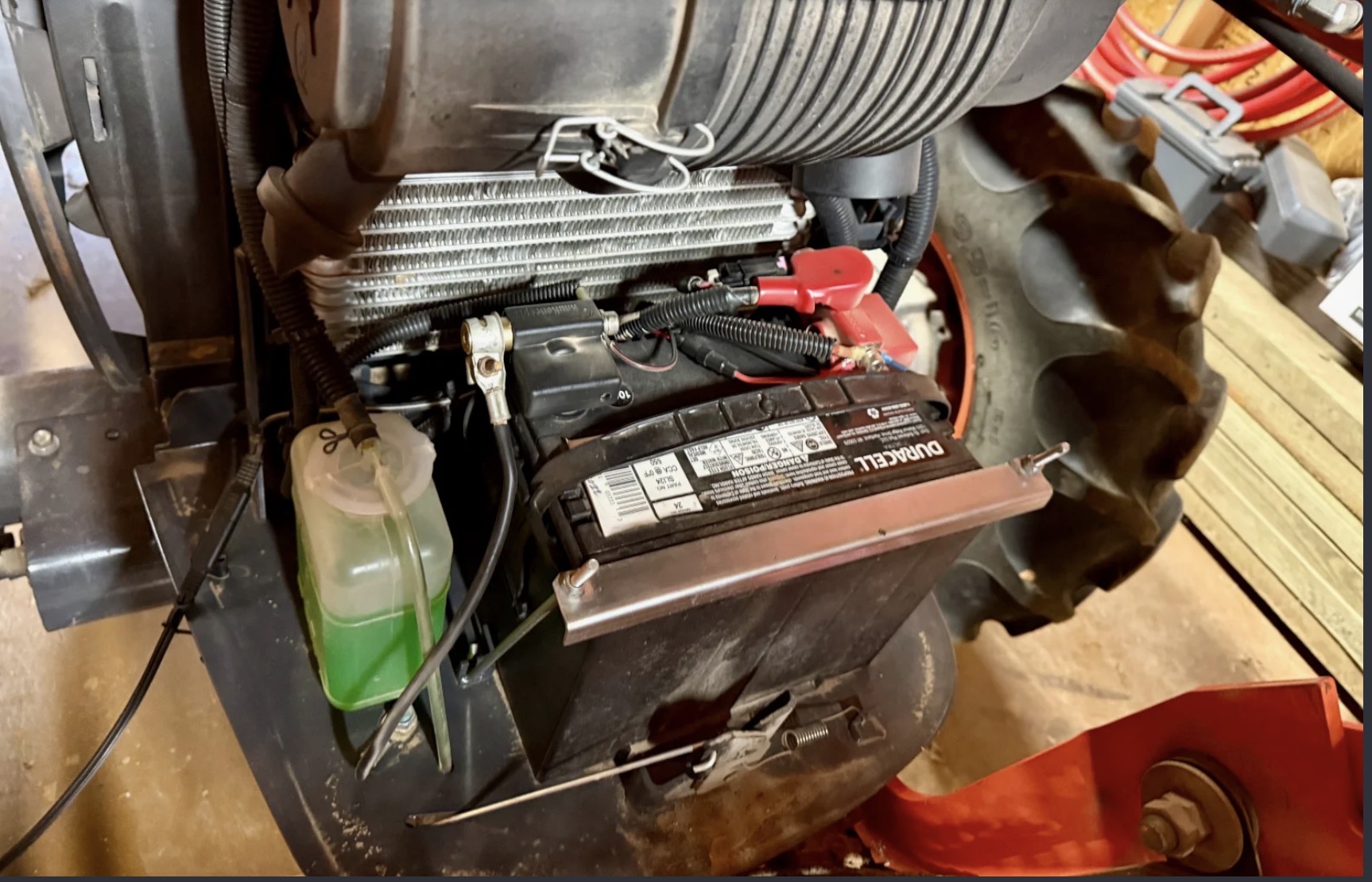

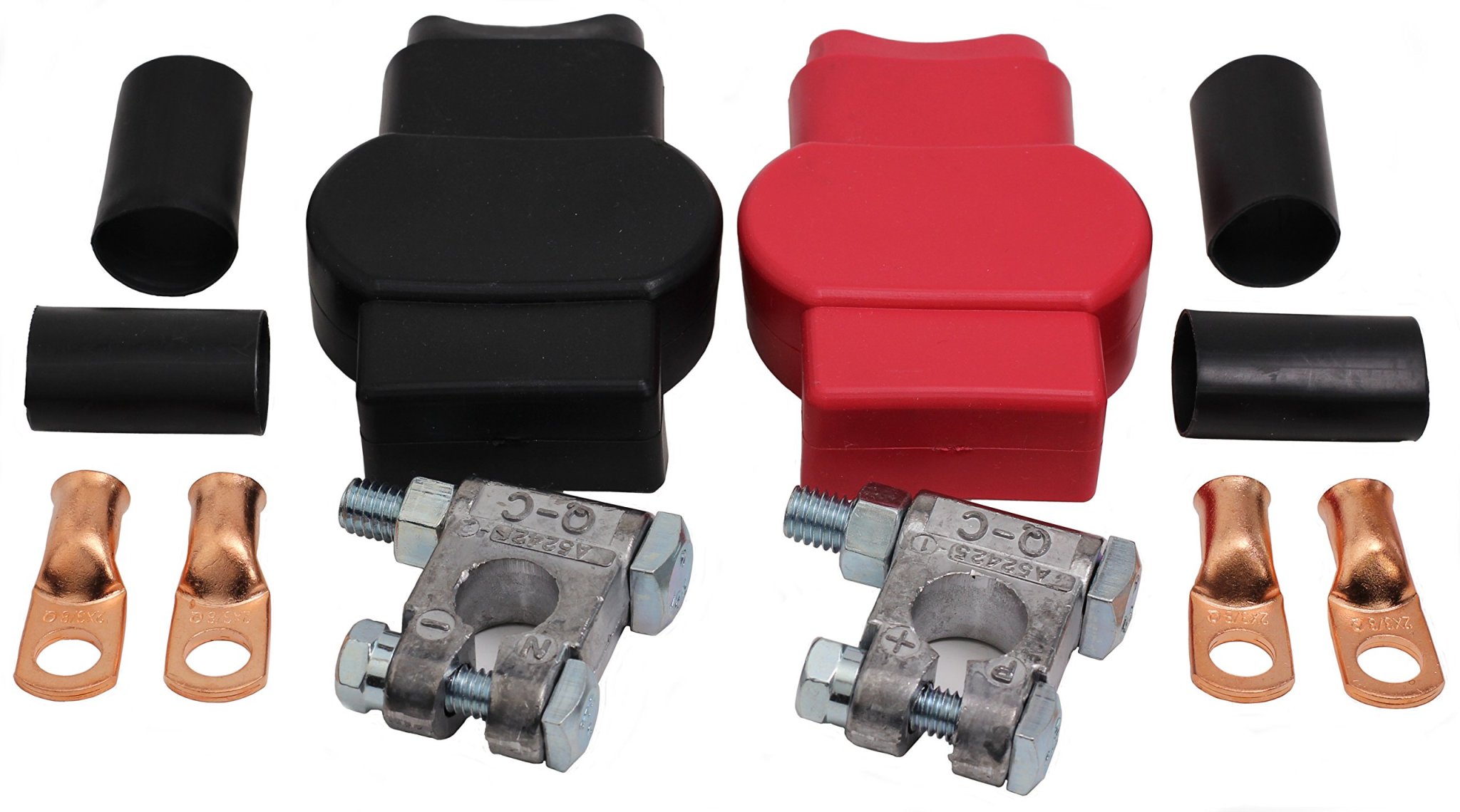

Searched the forum but didn’t find mention of this.
Found this little gadget for my SD batteries when adding some accessories. They made it very easy to tap off the battery posts. That got me thinking about the tractor. Looks like a winner there too! In addition to the product below, there is an adapter stud to keep the OEM battery clamps shown in the photo in case you don’t want to cut the clamp off and stick the bare wire in a set- screw (which works fine).

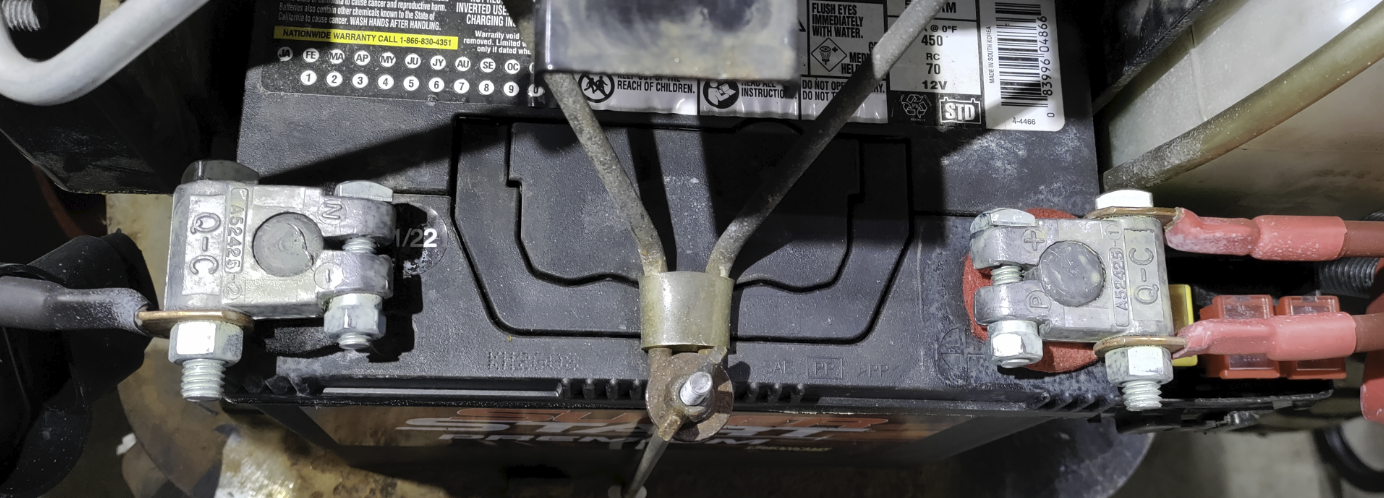

I bought and installed a pair of the knuconceptz battery lugs on the M5660 when I ran power for auxiliary work lights and a pair of cigret lighter sockets. Exceptionally well-made products.

But they require the original wiring to be modified, not like the original posters solution where the original wiring stays as is.
ONLY if you buy the optional "top post adapter" for an extra $10.00 each.

I see a lot of dissimilar metals in the clamp which allows for easy corrosion as well as 'stuffing bare wire into a hole' is not a good idea( more corrosion). Sure, it'll work 'ok' for a while but once 2-3 drops of water hit it you'll end up with 'funky' electrical problems.
Copper, Nickel and Brass are all compatible. Copper and nickel alloys are used in a host of environments. Brass and copper are used together in hydronic plants everywhere.
Set screw terminals (lugs) are also used everywhere. From the electric panels in your house to the AC unit. They are in your electric meter and the high voltage transformers on the street.
I think they’ll be fine on a vehicle.
True, but if you need to replace the cables (fixing corrosion, or you're doing an upgrade), there is no better way than with military clamps and compression-fitted cables.
