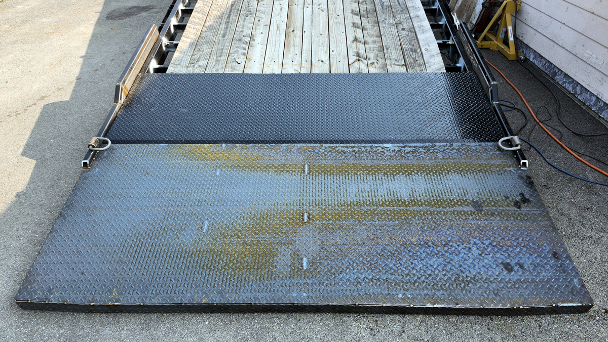

I have to haul the MX and flail to a job this afternoon/evening so had to wrap up a few things. I got the pallet forks cut down so that the rear of the deck sits flat on the ground. I also managed to get all four bolts through the stake pockets and trailer frame and nuts installed.

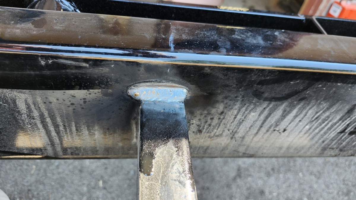

I welded up the top flanges of all of the C-channel cross members and will get to the underside later. I finished up all the welding under the deck with the exception of the deck to the frame. I made it much harder for myself by putting the deck plate on before doing all of the vertical up welds. I did a bunch of overhead welds too and am ok with how it turned out.
I don't need the extension to haul the MX and flail but I can put the bucket on and have lots of room to move the load around. I do need to weld on the CURT load leveling hooks at some point but will need to add plate inside the I-beam web area.

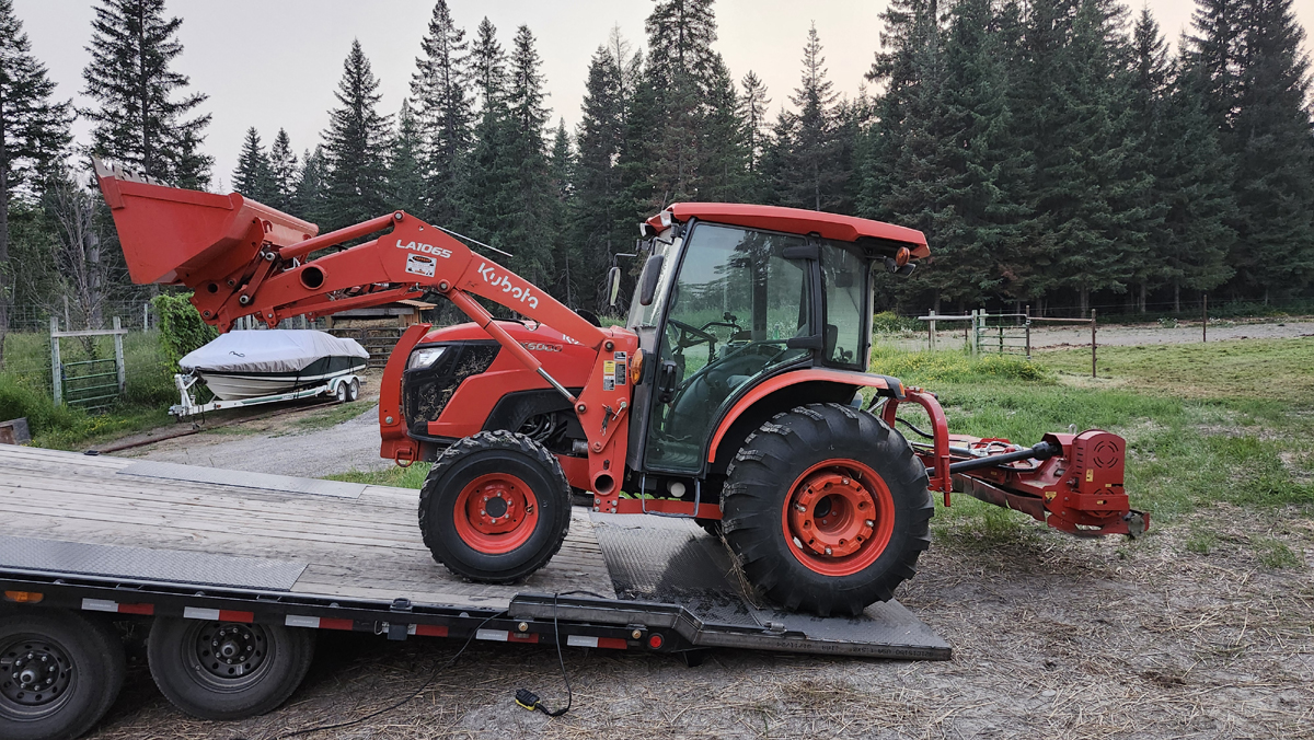

I towed the MX and flail yesterday afternoon for a 4-1/2 hour job, and the trailer worked well other than incorrect tongue weight on the way out. It's not fun when the tongue weight is too light for the load. I rolled the bucket back and got the tractor further forward for the return trip and it was a lot better. I have to say, the reduction in deck angle is an improvement for sure.
Here's the hefty MX with much of the weight sitting on the extension. I have a bit more welding to do before I haul the M6060 and folding cutter to my friend's place. I ran out of ER70S-6 welding wire so need to pick up some more. I have two rolls of flux cored wire and plenty of 6011 and 7018 rods but need wire regardless.

When you figure out 'THE' position for the tractor, take a picture and print a copy, store in the truck.
Do that for all the 'combinations' you have to haul. That way, it's EASY to SEE the proper place for the load.

I took a picture of the MX on the trailer this morning before unloading it. I do need to make some notes on where equipment has proven to ride well. I probably should have backed the tractor on the trailer to give me more options in placing the load.

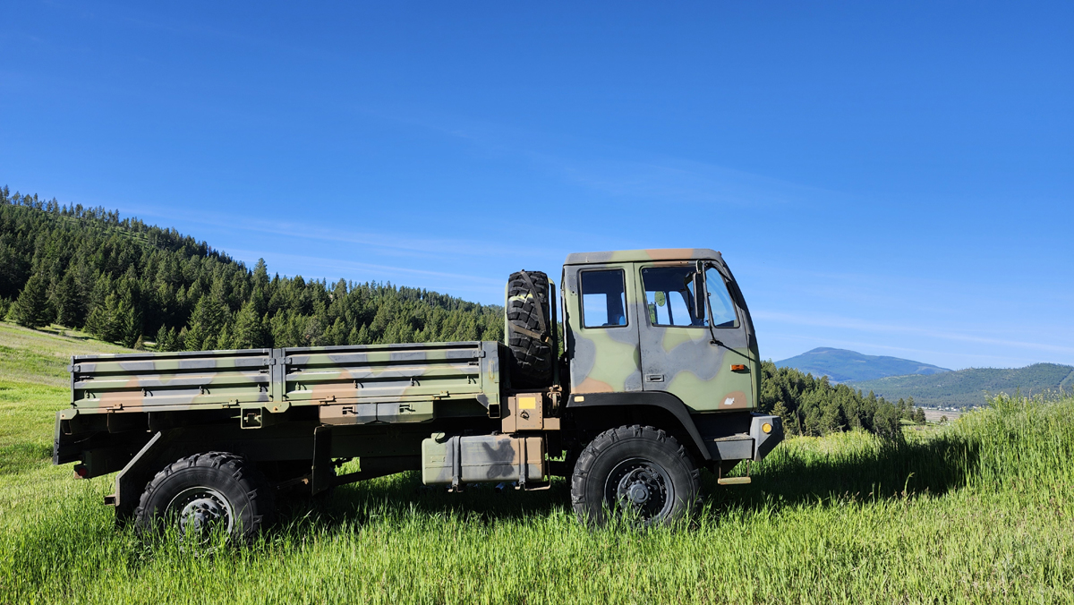

Curious…What make truck is that in the background of your last photo?

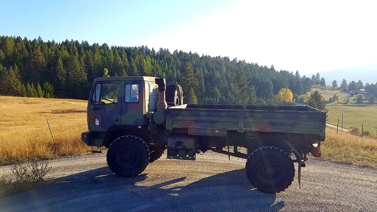

It's a Stewart & Stevenson M-1078 made in 1998. It has a 6.2L fully mechanical Caterpillar diesel engine, a 7-speed Allison transmission, it's AWD and weighs around 17,000lb unloaded. It's rated for 2.5 tons in the bed. When I picked it up at the docks in Seattle it only had 4,500 miles on it. Now it's a little over 5,000 miles.
Last year I designed and made a 3" receiver for it so that I can pull trailers around with it.

Somewhere in the 8 to 12 mpg range when the fuel filters aren't clogged. When they're turned into overlanders with heavy boxes on the back and lots of gear, the fuel consumption is more like 6 mpg. It has a 60 gallon fuel tank so a range between 480 and 720 miles in my current configuration.

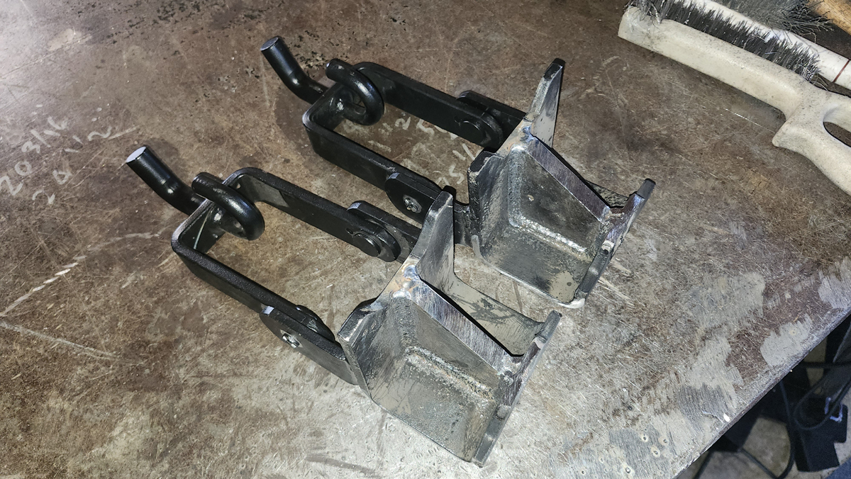

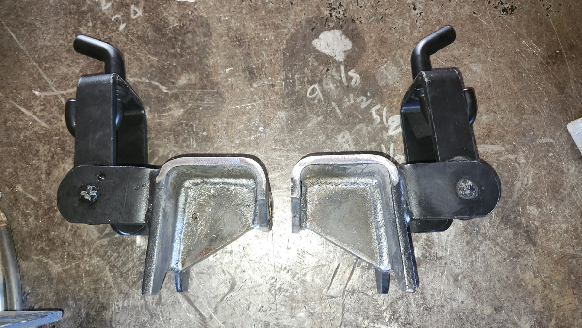

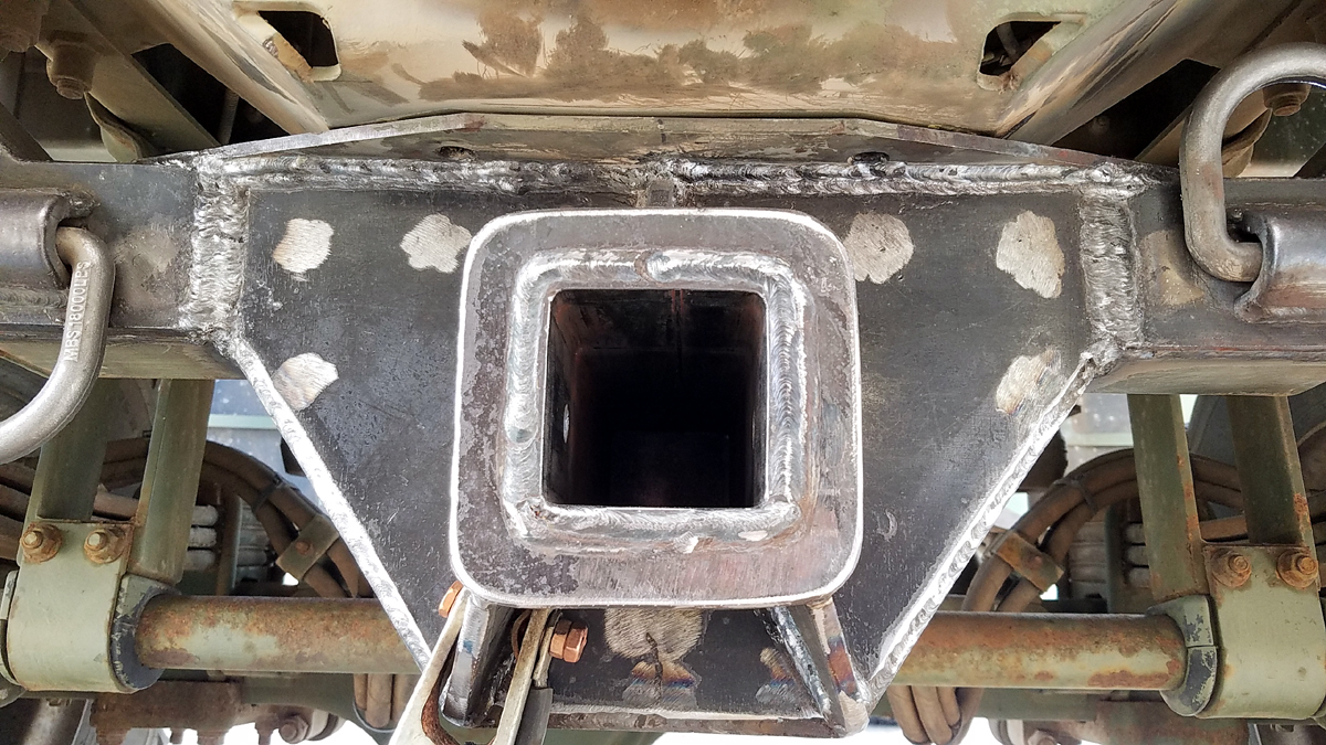

I spent some time yesterday morning modifying and welding on CURT hookup brackets for the CURT weight distribution hitch. I needed to weld them to the underside of the I-beam tongue so decided to add a gusset to give the part more strength.
I also completed one pass (100% weld) to connect the two tubes that support the deck extension. That's something like 12ft of 7018 weld!!

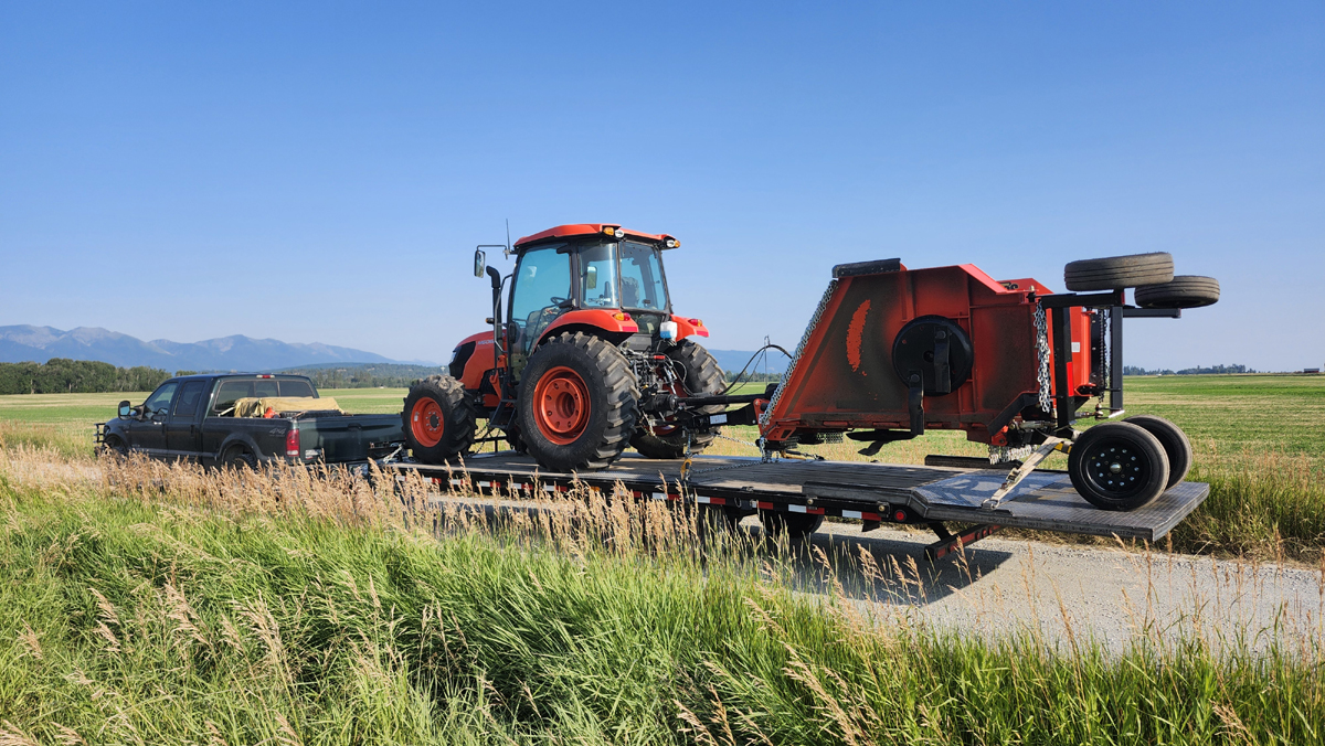

And finally, the whole reason that I started this project.

That turned out good. Can the cutter be lowered to the deck while folded up? Is there any type of pin to lock the wings in the up position? DOT might not like you relying on the hydraulics to hold them up during transport.
When I was hauling rental equipment, I had to chain backhoe stabilizers together, since they didn’t have a pin to lock them up. Sorta the same line of thinking with the wings.

Some great points! :)
The cutter as shown on the trailer is at the highest "down" position, but had I put more thought into it I would have removed the all of the shims in the pack (see photo) so that the deck sits lower. I'll definitely do that when I tow the tractor and cutter back home tomorrow evening. Thanks for that observation since it'll make towing safer if the center of gravity is lower.
There are pins on both sides to lock the wings in "transport" mode.
