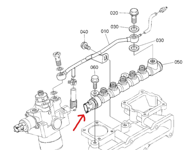

Check the rail pressure sensor
He needs to read the troubleshooting steps in the WSM and not fly blind
The part you want him to check is a $2000 part so having knowledge on how to test / check anything properly might save him a bunch of $$$$.
FYI: You can't just buy the sensor.
