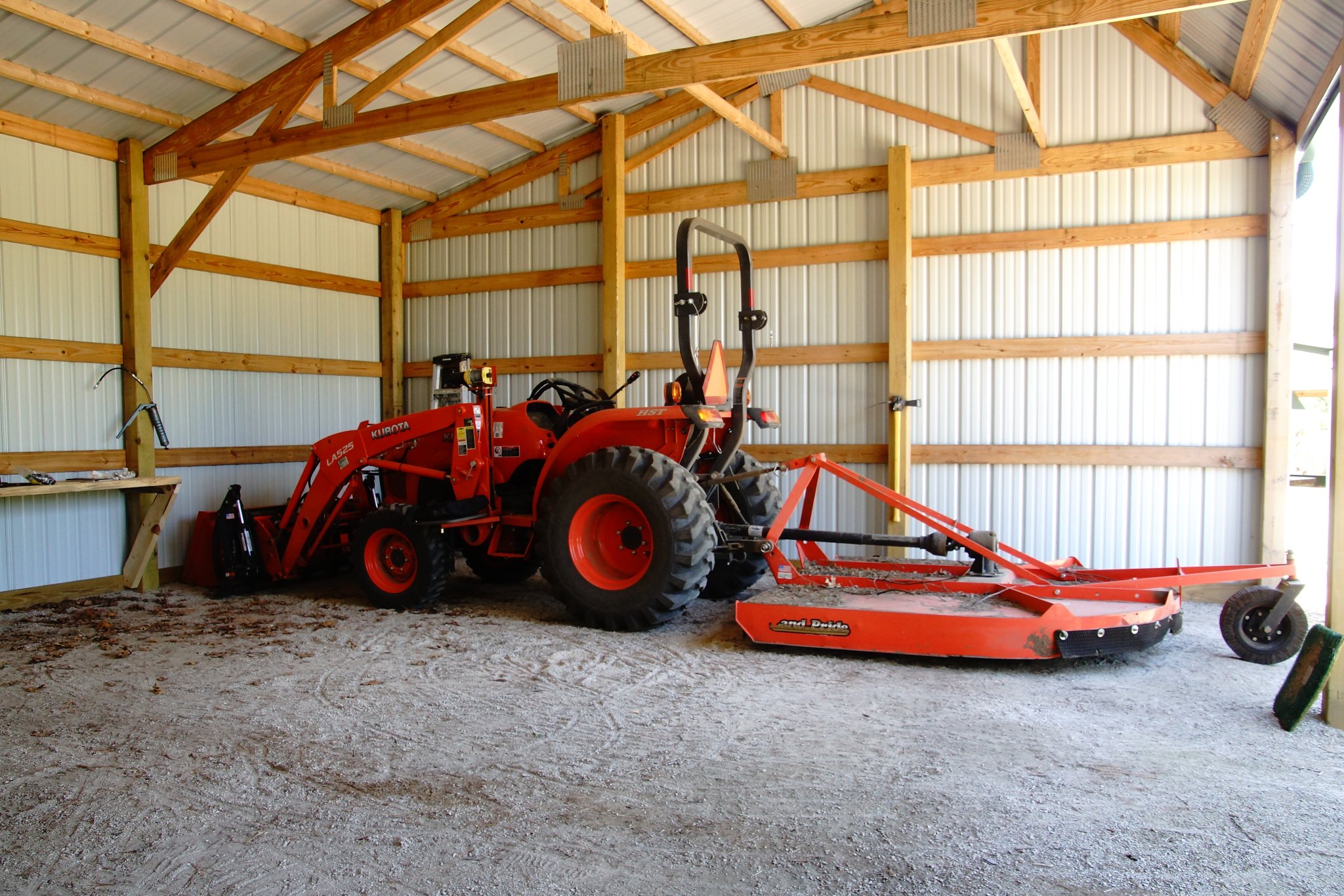

I would think that both our L tractors are pretty close in dimensions.
This is my L2501 with the bucket stored as far forward as it will go , the grapple pulled up close to the bucket and a 6 foot Land Pride brush cutter attached.
My Open faced shed is 24 foot deep. As you can see it is a tight fit! If I had a door on the open face not sure if I could close it without hitting the tail wheel of the cutter. If I stored the bucket elsewhere I think I could close a door.
Note: after looking at the specs for your L3560 I see it is substantially larger than my L2501 in wheelbase etc. , and a larger loader. You did not mention if you have a loader mounted, if not and it is just the tractor and brush cutter 24ft deep SHOULD work. My shed builder told me it was not much more expensive to go with 27 foot wide versus my planned 24ft x 24ft due to material sizes etc. Perhaps that would be the case for you if you bumped up the depth to 27 foot and 36 wide.
Good luck and hope you keep us posted on your shed build! :)
Nice building you got there. Yes I do have an l805 loader on the front of my tractor, so looks like I might want to make it a 28footer? I have logs that I plan on cutting up for lumber to use on this project, so that should help bring the cost down some.
