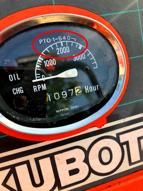

I run my 3PH mower at 540rpm and my ZTR at WOT.
Same.
My Tractor has a certain engine RPM that results in 540 RPM at the PTO and I run it within a small 'window' depending on cutting conditions.
My Zero turn is run at 3600 rpm (WOT) since that is the ideal speed for engine performance and cooling.

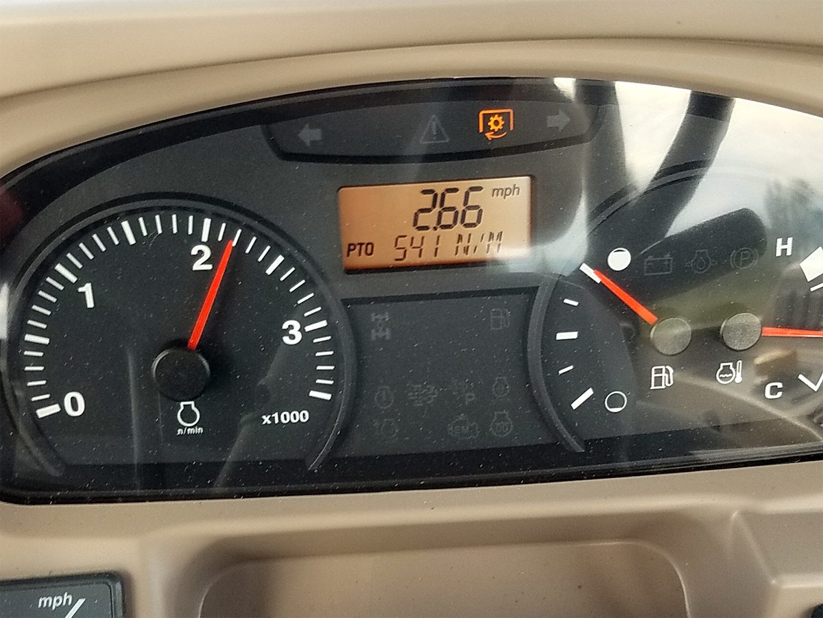

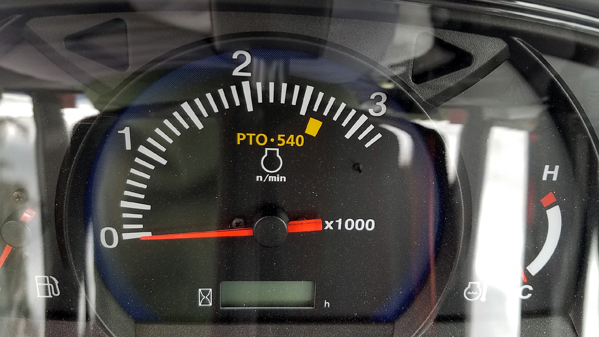

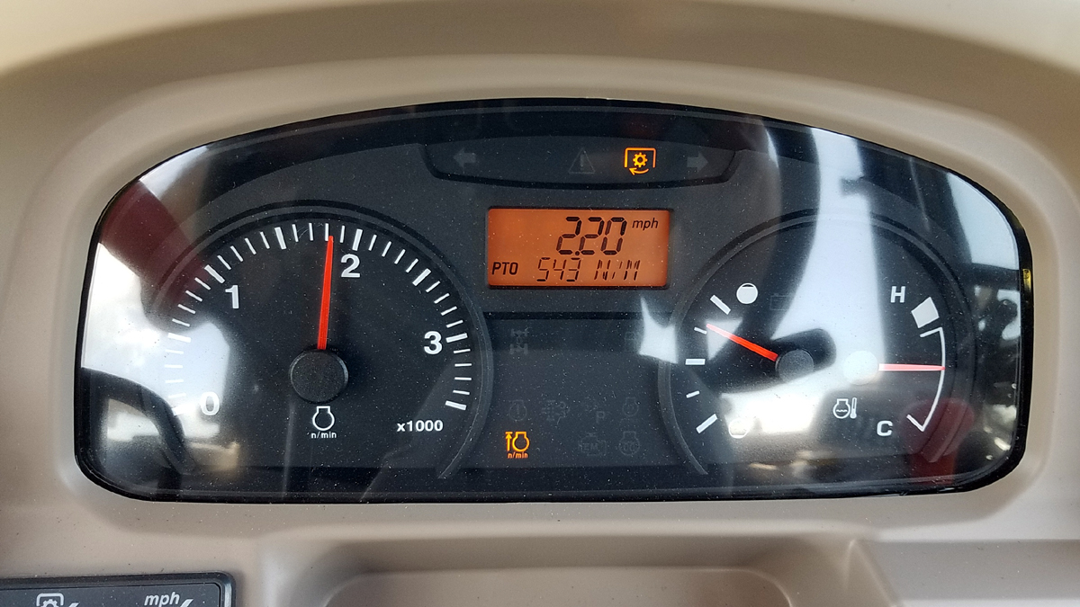

All this PTO vs. engine speed has me remembering some results from my cutting with the MX and M.
The M6060 has a 540E mode and no indicator on the tachometer for engine rpm for 540 rpm at the PTO since there's a digital display for the PTO. There's close to a 400 rpm reduction in 540E mode. One of the many things I like about the M6060 is that I can have the ECU control engine RPM as the load on the engine changes, such as climbing a hill while pulling a cutter.
The MX6000 does have a region on the tach to indicate engine RPM to produce 540 RPM at the PTO.
