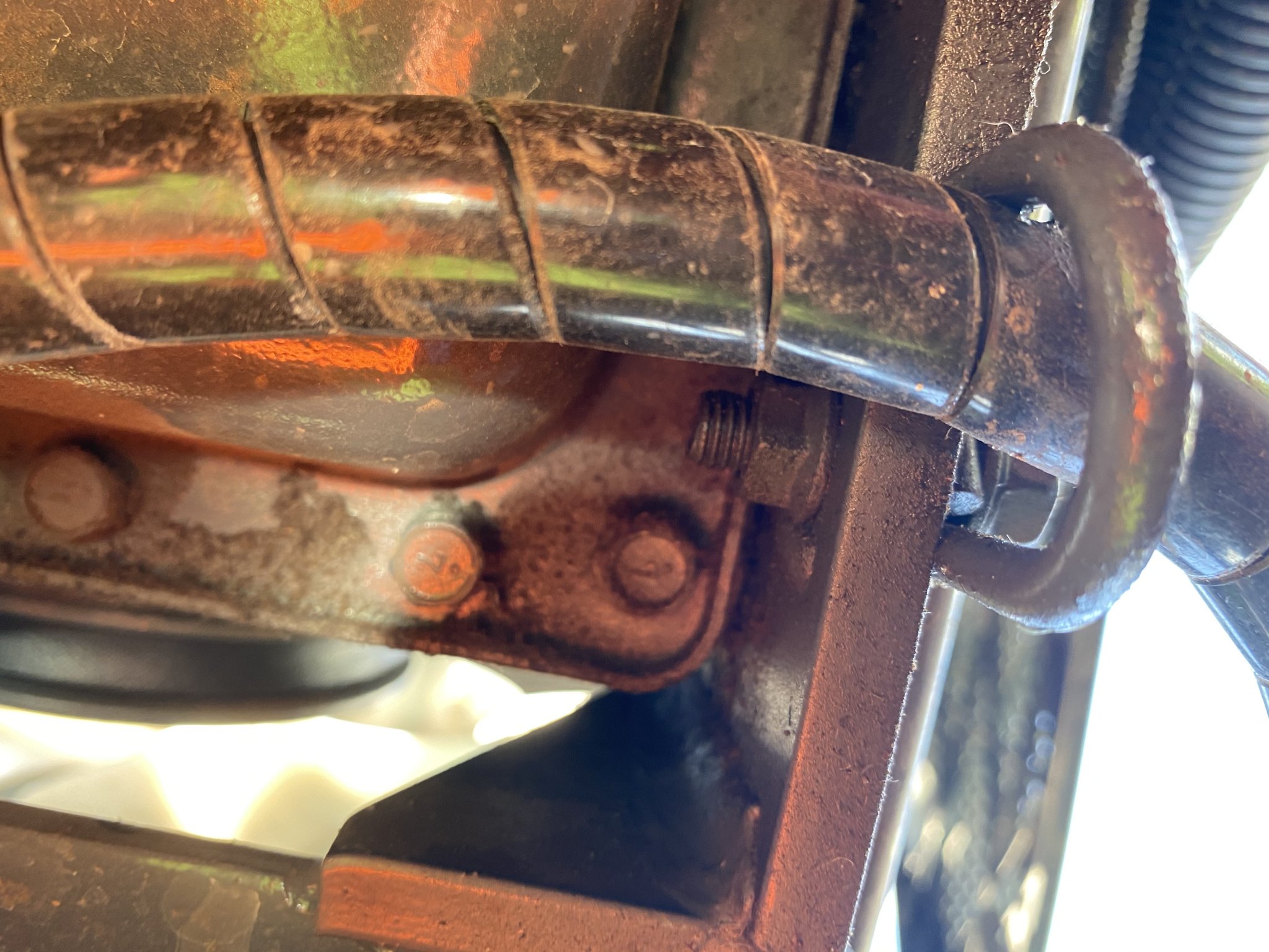

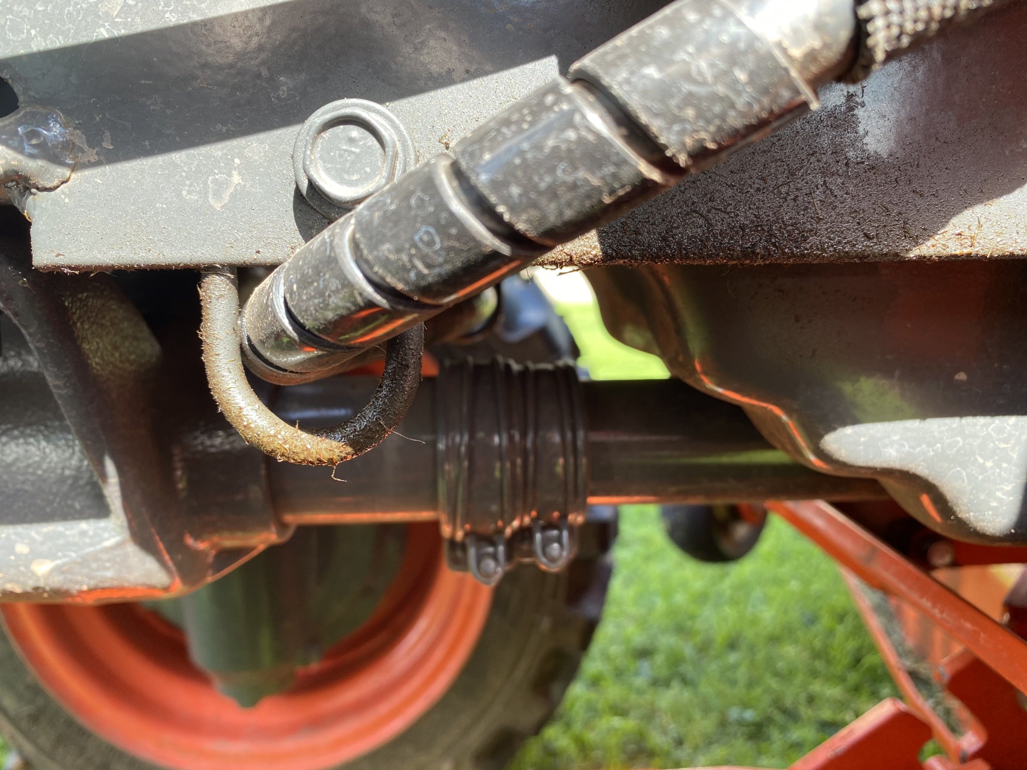

My 2650 developed a oil leak last May at around 50-60 hours. I’ve cleaned it up and it comes back after about an hour of run time. I brought it in a week ago. Anyone have this oil leak like this? The oil filter is not the issue. A friend has the same tractor with more hours with the same leak but never brought it in.

You could try tightening your oil pan bolts. They don't have to be real tight but they should be the same tightness. Use a torque wrench for the operation. The Kubota specs should state the proper torque.

You could demand a warranty fix. From the pictures it appears to be a stamped steel pan so they could have gotten a bad run of them. At the next oil change you could pull the pan for a close inspection paying close attention to whether the top surface it flat and true. It's also possible a new oil pan gasket would solve the problem. You could add a very thin bead of RTV.

After 6.5 weeks at the dealer and a new oil pan, I still have the same oil leak. I mentioned to the service writer it seemed the oil Was coming from the front engine cover. A $25 gasket.
