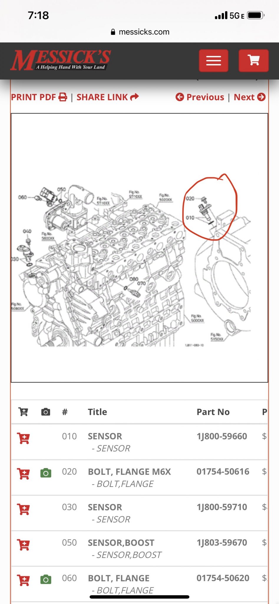

Keeps coming up intermittently. M62 power reduced when on. I shut down the tractor and restart, then tractor runs normally.
Anyone know where the sensor is located?

Top right side of the flywheel housing I would say. I would inspect all the wiring to it for chaffing or damage before throwing a sensor at it. With a scope it could be easily narrowed down but I realize not everyone has one laying around.
