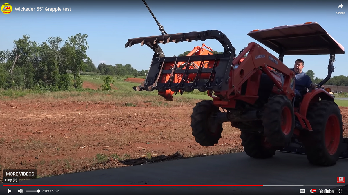

The chain is exerting a point load on the lid rather than a distributed load which greatly increases the chance of buckling an inferior lid. Also, if the object is fixed in the ground you're not going to get the kind of momentum you can get with a chain connected to secure object because the tractor isn't able to move rearward before the load increases. Ted pulls on the lid both in line with the loader/lid and perpendicular to the lid.
But once again, EA is the only manufacturer regularly showing these sorts of tests. As Ted says in the video ...
"I've read on some grapples that look similar to this and it says no pulling allowed, no back dragging
allowed, and that's what a rake grapple's for so I don't really understand that. As far as we're concerned you can do pretty much do anything you want to with this."

AT BEST, that is about 2000 LB of 'dangling gentle force.' Its MUCH less because you're using the loader as a leaver. When you have all 4 wheels on the ground and ram a stump directly, you're doing maybe 10 times that.
Ted 'yea you can do whatever you want to this grapple.' Website and technical info says otherwise. You don't find that sleazy???
Don't you realize those videos are nothing but commercials by sales people to get you to buy their product?

A bent lid from pushing, not pulling. The Homestead was damaged by pulling, not pushing. That's the point.

What's sleezy. Ted demonstrates pulling on the lid, not pushing on the lid. He addresses the issue of pushing on the website. It's a rake grapple after all.

Who's talking about ramming ... can you really not see the difference between pushing and pulling when it comes to these grapples.

Whether the operator is pushing or pulling, the stresses will be about the same on the 2 hinge pins and steel frame 'unit'. Be far better off using a chain to the drawbar..

Pushing and pulling would do the same damage to a steel metal rod... I thought that was common sense? Question is about force exerted, where metal wont bend up until a limit, which is quite easy to reach with a hammer with enough momentum and weight. Very difficult to bend metal with a sponge...
