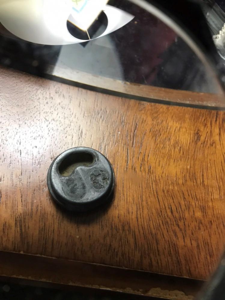

Some how I ended up in the ATV / motorcycle / boat repair business. Most of the problems is this Sh****ty gas people put in things and then let it sit. Leaves crap in carbs, destroys fuel lines and this is what it done to a fuel petcock on a Yamaha Bruin 350, it eat the aluminum and harden the gasket. I could not turn gas off when I was cleaning the tank out. Put new carb on and now waiting for the petcock. Been ordering those China carbs off eBay and they seem to be working good too. $40 vs $250.
9,157
4,708
I had similar issues. Thankfully there is a couple stations close by that have started carrying non ethanol gas. Only thing the ethanol gas goes into now is the vehicles.
My cans only get non ethanol gas in them for the smaller equipment. Since making the switch I haven't had any more issues.
I realize you did not ask any questions.... but I TOTALLY agree with your assessment.
I fix small engines and most problems can be traced to Ethanol Alcohol in the gasoline. When I clean the carburetor, I also dump all the fuel and add NON-ethanol fuel.... the engines run fine then.
Adding Ethanol Alcohol to the gasoline was a political gimmick to make people THINK it is good thing.
Here we are several years into it and the truth has reared it ugly head:
*) Cost of food has gone WAY up. (farmers converting 1000s of acres from food-production to to ethanol) This USED to feed people and livestock.
*) Less energy in the fuel (LOWER MPG!!!)
*) Ethanol Alcohol eats thru many materials used in older fuel-systems.
*) Ethanol Alcohol is hygroscopic (absorbs water into the fuel)
