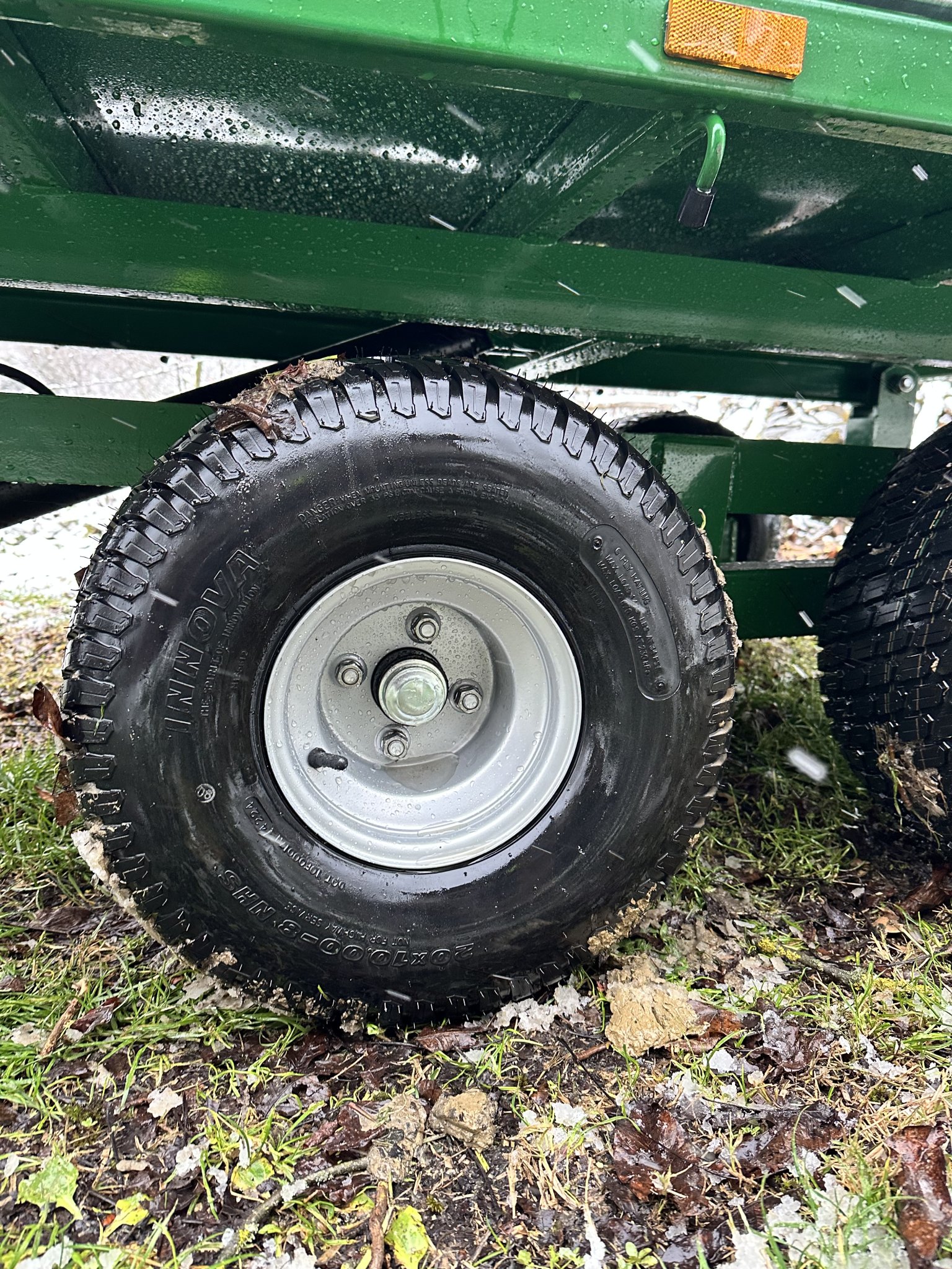

curious I downloaded the specs+parts lists. As for brakes, they probably use an 'off the shelf' spindles and hubs. Once you know that, just find matching brakedrum/hub and E-brake backing plates. Tires will not stick out and of course you'll need to create mounting brackets for the brake plates.

Thanks for the advice. I think I will have a lot more question. But here is the first basic one. Do brakedrums exist for such small wheels with only 4 bolts? Look at the pic.

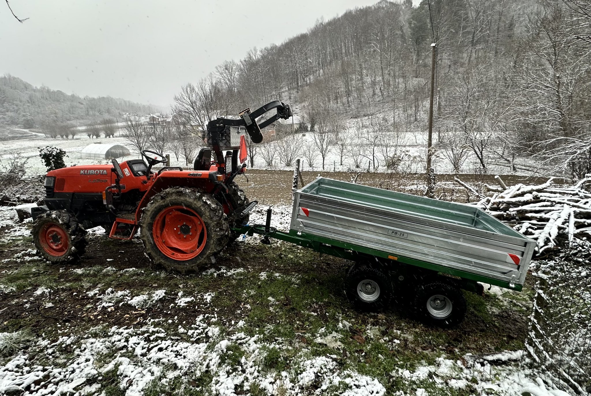

Hi, I tested the trailer yesterday and today so here is the post with some pics:

That’s a nice set up you have there between the tractor, winch and trailer.
What brand is the winch?
by the last pic, someway somehow it looks like you got majority of the mud off?!👍
did you use the dump function on the trailer?

Thank you all for the opinions and advices. I appreciate it all. Most of you leaned towards the GEO (green) one. So I decided to buy it. It will arrive later in the day today. I decided to look into getting electrical brakes. However I have several question marks over my head. First one is - are those wheels too small for electrical brake drum? And if I add just one drum per side - will the wheel with the drum stick out? If it does, is it a problem? Or just aesthetically not pleasing?

You won't have enough information about your wheels/axels until you get the unit in your hands.At worst you will have to buy new trailer axels and wheels and tires to get a decent load carrying capacity.

Winch is by European (Slovenian - where Melania Trump was born btw :) manufacturer called Krpan.
Yes, the mud fell of the next morning when it got frozen and I rode tractor in frost. No, I haven`t used dump function yet because I don`t have auxiliary hydraulics set up yet. I need to get sockets. That will be my next post here. How to connect it to the tractor :)
