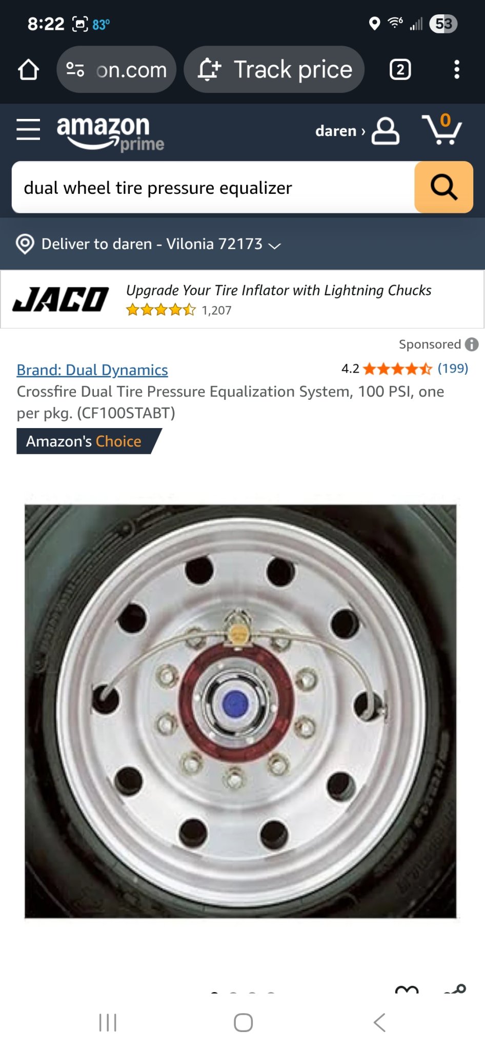

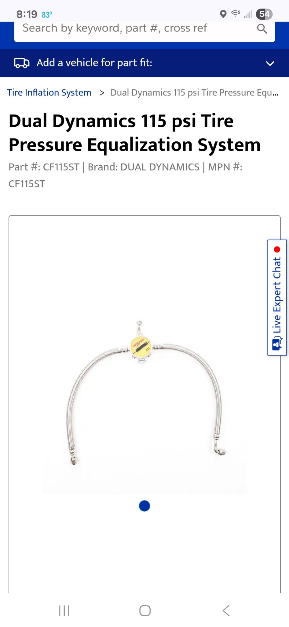

I use something like this on the dual tires on my service and delivery trucks at work. They sell them calibrated for different tire pressures. And with one quick look you can tell if you are good or have an issue.
They have internal check valves, so if one tire is at a lower psi, that tire will inflate first until the tire pressure reaches the same as the other tire. Then both tires will inflate evenly.
The added bonus is one easy to access valve stem.

Those may be the ticket but for $300 this will be put on the back burner.
Looks like they mount on one of the wheel studs?

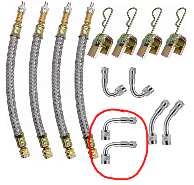

You can get flexible extensions that they use for test plugs for plumbing.

I just looked a little deeper into this, there are a ton of cheap solutions:
6,828
9,253
I've made quite a few purchases from etrailer.com over the years and they have a number of products that make it easier to check and inflate inner tires on dually set ups whether on a truck or a trailer.
One of your links reminded me of the upgrade that I made in 2002 to the inner rear wheels/tires of my F-350 dually. I added brass 90° valve extensions and bought an extended air chuck and pressure gauge that I still have. My friend in Hawaii who has a very successful towing and recovery business, and a lot of experience with big trucks, suggested I change out the Ford plastic lug nut covers for individual stainless steel covers. 😂 He's a great guy but he sure cost me a lot of money in upgrades back then. But I'll have to look into doing that again on the F-450.

CAution:
Cheap equalizers, can cause both tires to go flat if one tire fails.

The cross fire units are the real deal. Back in the late 70's into the 80's I did a lot of testing for them. They aren't cheap but they last. I have several that have been on many different semi trucks and trailers over the years. I run them on my semi tractors and grain trailers. There are a lot of systems out there today but the cross fire units were some of the first ones made.

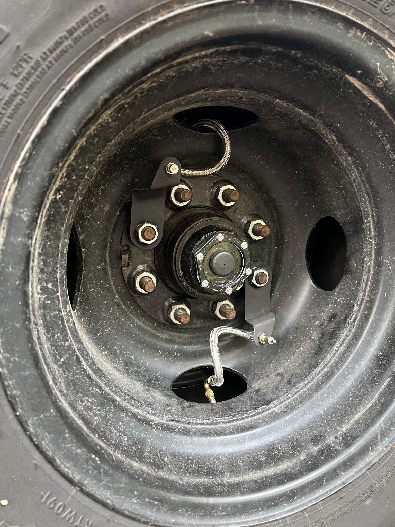

Just wanted to update this. I went with the stainless braid versions similar to what Wolfman posted, just mounted differently.
The mounts that came with these are supposed to mount to the wheel stud. I didn’t like wedging that between the lug nut and rim at 200ft lbs of torque. So I just put the mount after the lug nut and bought some nuts to secure them.
Definitely a less expensive option than the crossfires but I don’t use the trailer that often, just needed an easier way to check the pressure of the inside tire.

Picture added. I did end up painting the mounts black to match the wheels better.

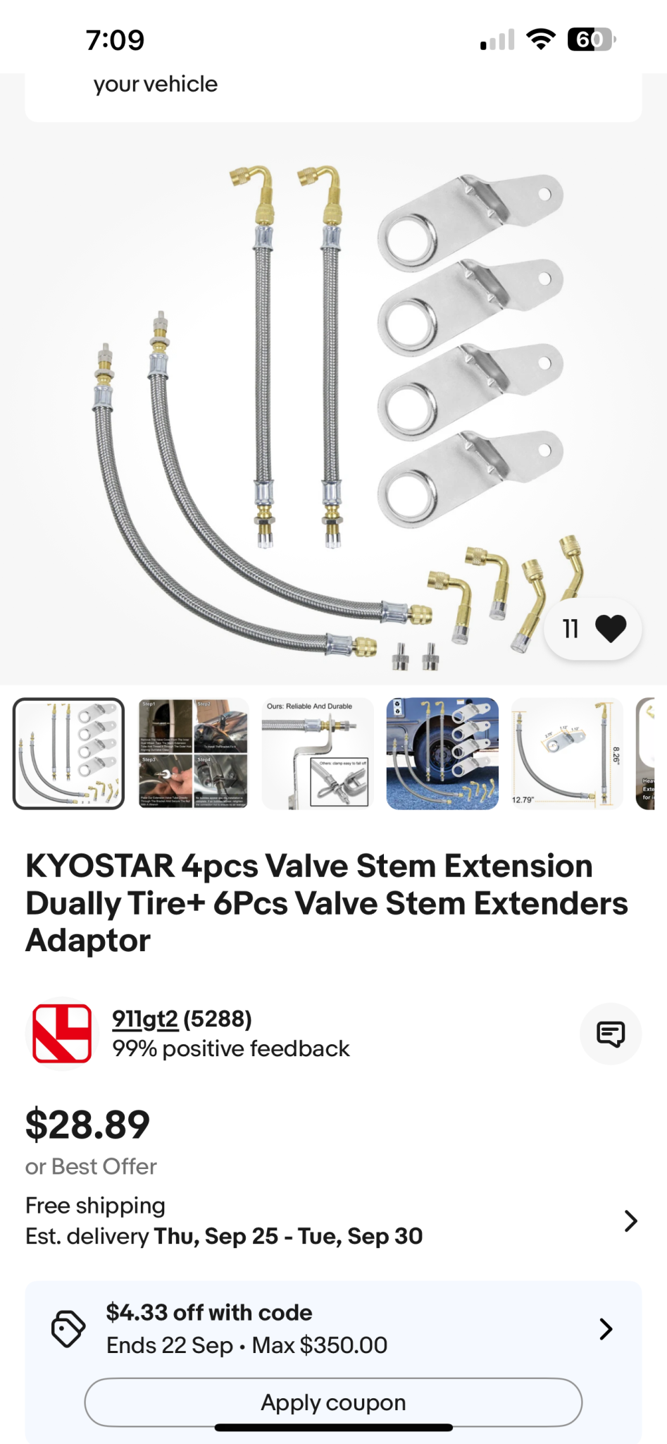

That's awesome! Where did you buy them from? I'd be interested in that upgrade on my Kaufman trailer too. Might even be a good idea for the F-450 but not sure if wheel balancing would be an issue.

I bought them on eBay. About $30 per axle. I bought one set back in May and the second set in August.
Between that time it got all new tires and I went through the bearings, checked the brakes and installed the new style oil caps.
