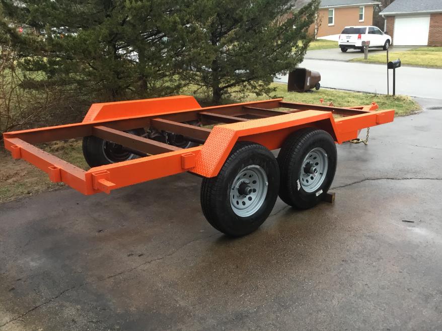

Lots of hard work and lots of money got me this far.
I need to install a deck.
Question is what kind of wood? Pressure treated or just regular wood?
3,550
5,426
Pressure treated 2x's, not 5/4.

Looking good!
I would recommend PT. Dirt and moisture will create breeding grounds for rot otherwise.

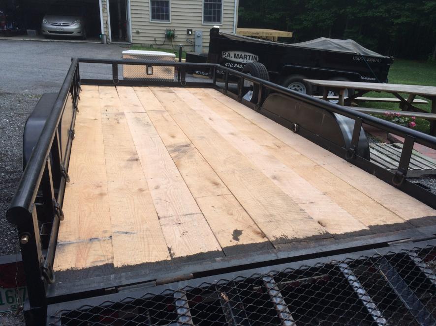

My suggestion is to use rough sawn white oak, call some local lumber/saw mills and inquiry about it, I did my 16' trailer for about $180 last year. After it's dried good, paint it with used engine oil to waterproof it. PT lumber is hard on the steel framing and screws it touches, and it shrinks a bunch when drying.

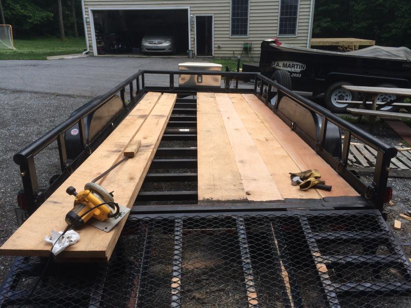

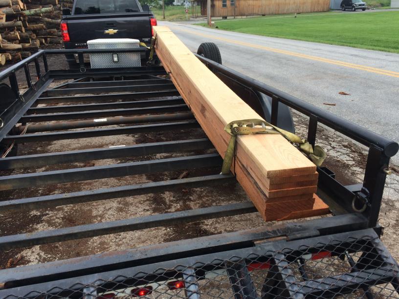

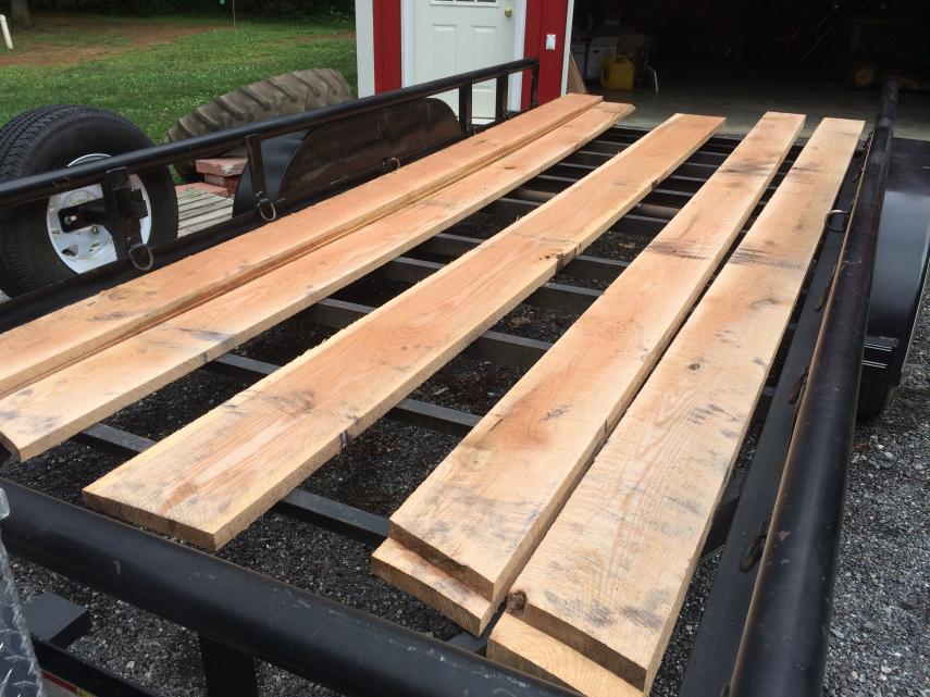

Thanks everyone. This forum has been a great help.
One thing I would like to point out I found from my research.
PT “pressure treated” wood since 2004 is VERY highly corrosive to metal. If you use PT you need to use stainless steel fasteners.
After doing my research I have decided to go with rough cut white pine 1 1/2 X 6 X14.
I called around sawmills and was surprised to hear that rough cut white pine ***127794; is cheaper than the junk PT from the hardware store.
I picked up some white pine and 3/8 stainless steel carriage bolts with nylon lock nuts to re-deck the trailer with.
The last thing I need to figure out is what to use to treat the wood. I have thought about using boiled linseed oil, pine tar or diesel and oil mix.
Any suggestions on what to treat the wood with?
